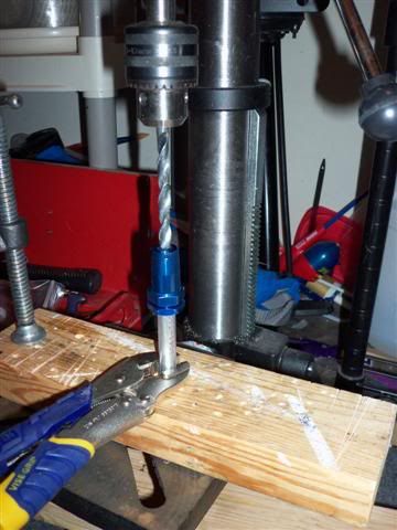

I made two of the shortened extenders for the front of this buggy. The way I drilled out the 8mm hole in the insert is by lining the 1/2" aluminum rod up vertically and then drilling through one of these extended hexes to keep everything aligned. Otherwise, I would never have been able to center the hole properly:

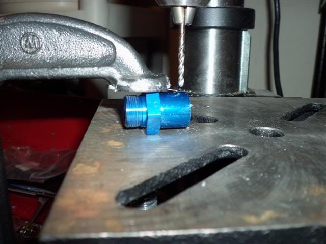

I drilled the pin hole simply by clamping the hex to the drill press table with by its flats - keeping the pin hole exactly at a right angle to where the axle will go through:

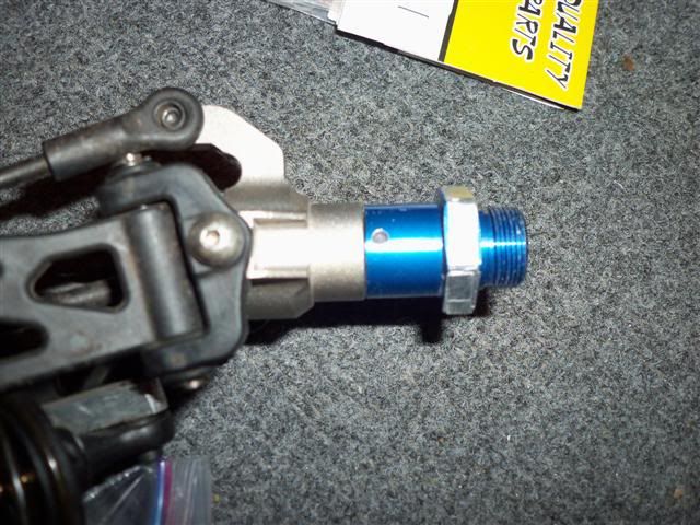

I JB-welded the insert into the extender and then filed it down to exactly the right length so I could get one shim between the extender and the bearing:
http://i779.photobucket.com/albums/y..._0971Small.jpg

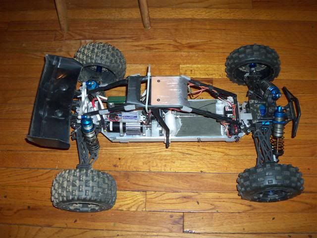

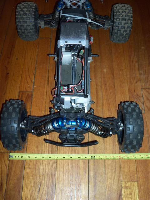

With these on the front of my buggy, the width is now around 18" (about an inch less than before). The rear width is 19.5"
http://i779.photobucket.com/albums/y..._0974Small.jpg
http://i779.photobucket.com/albums/y..._0972Small.jpg
I like the way it looks, but I'll have to see how it handles.

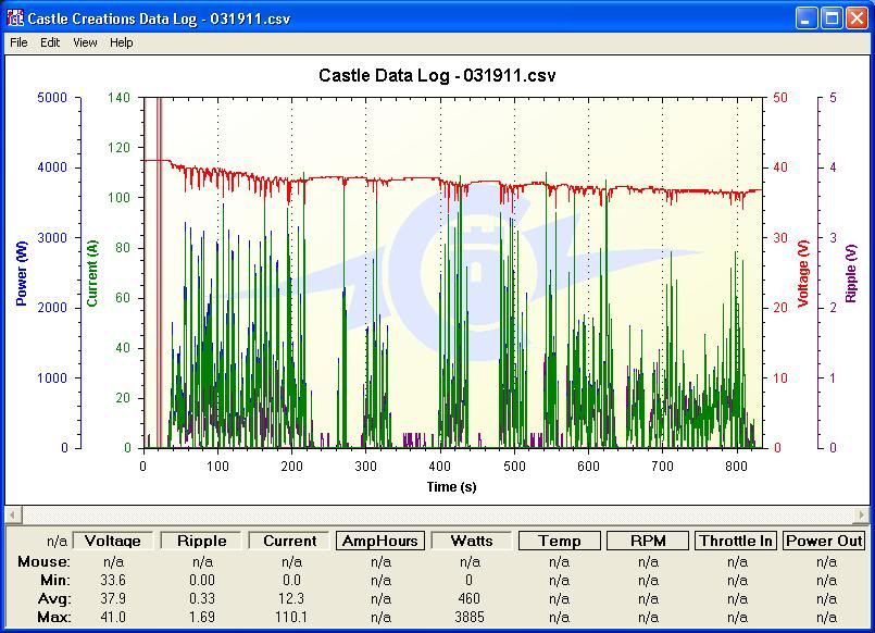

I got this out for a quick run today - only 2800mAh used. Again the Gens Ace batteries performed well:

All temps were low (motor 120F), except my only concern today was that my CD was at 200F after the run. That seems a bit high for the conditions today - I have 30k diff fluid in there. I'll check my mesh and alignment to see if they could have been generating extra heat. Otherwise, I might go to heavier fluid to see if it helps.

Im running 300k oil in my CD and temps do not get as hot as that... i measured mine at 140F which is a little better.
But it was hot when i had 50k in there!
Under 120 Amps sounds good... well within the 160amp capabilites of the Ice HV!
