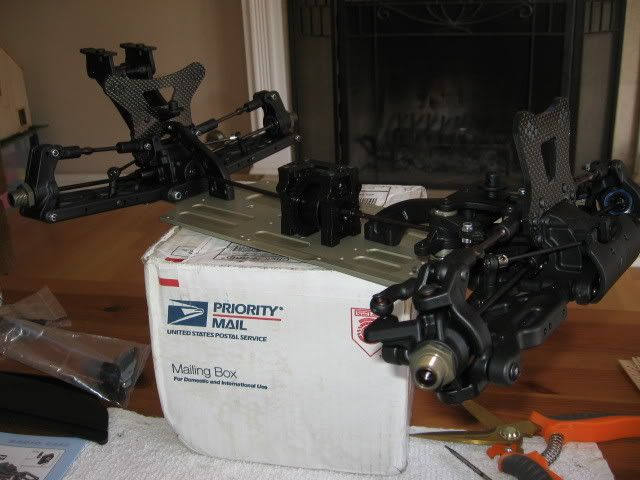

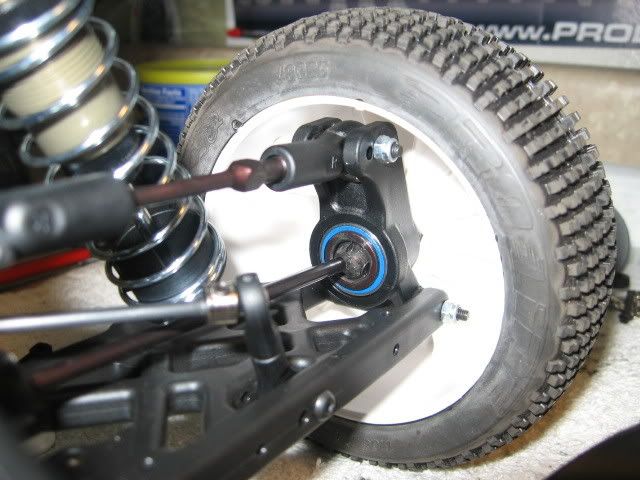

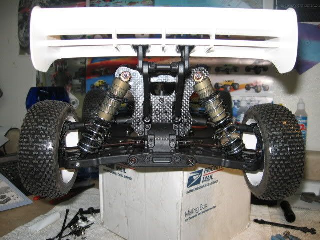

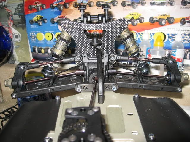

auto2 05.25.2008 06:25 PM

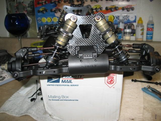

your outer tie rods are on backwards. the rim will hit them like that.
Hay auto2..
It took me 4 times reviewing my truck but I final found that screw-up on my part.. Thanks soooo much the comment.. I really appreciate it!! This is my first buggy so I'm kind of learning as I go, I'm just glad this one was discovered now.. Did you see any other mistakes on my part?? If so please feel free to forward them along.
Thanks again…
Have a great one..
Shaun.

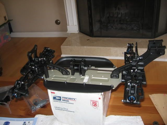

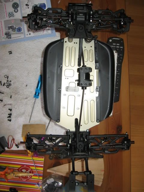

Good morning team, today I decided to move the build inside so I could spend to time with the family, while kids were watching sponge bob, I was planning my next step, IE installing the center drive shaft. This ended up being relatively painless with the only modifications to date being the removal of the Nitro braking servo plate.
http://i264.photobucket.com/albums/i...7/IMG_2891.jpg
http://i264.photobucket.com/albums/i...7/IMG_2892.jpg
http://i264.photobucket.com/albums/i...7/IMG_2893.jpg
http://i264.photobucket.com/albums/i...7/IMG_2894.jpg
http://i264.photobucket.com/albums/i...7/IMG_2895.jpg
http://i264.photobucket.com/albums/i...7/IMG_2896.jpg
http://i264.photobucket.com/albums/i...7/IMG_2897.jpg
http://i264.photobucket.com/albums/i...7/IMG_2898.jpg
TDC57 05.26.2008 07:45 AM

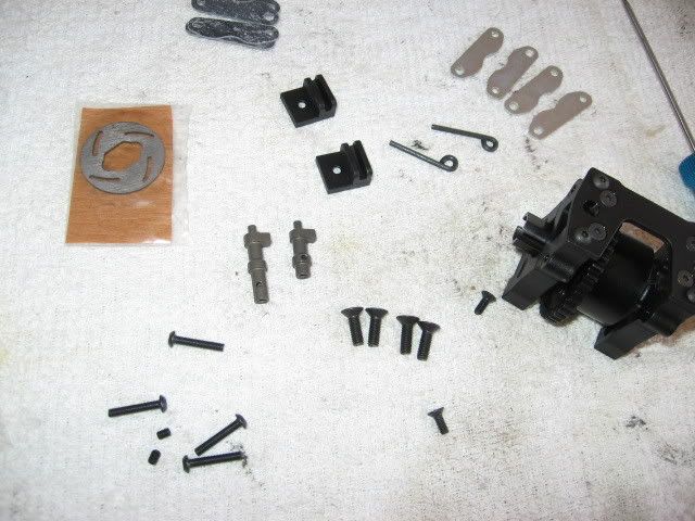

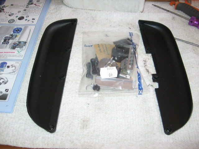

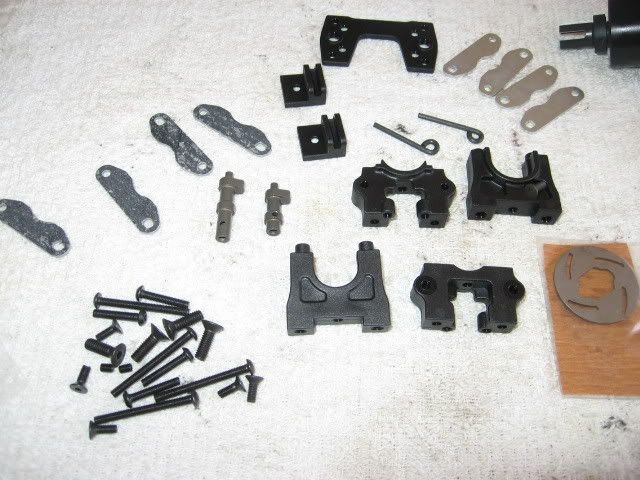

With that installation completed it was time to install the side plates, hey it’s starting to look like a buggy at this point..
http://i264.photobucket.com/albums/i...7/IMG_2899.jpg
http://i264.photobucket.com/albums/i...7/IMG_2900.jpg
http://i264.photobucket.com/albums/i...7/IMG_2901.jpg
http://i264.photobucket.com/albums/i...7/IMG_2902.jpg

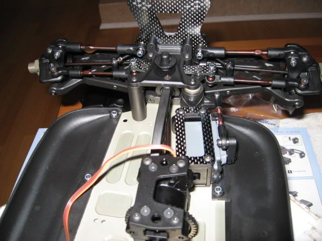

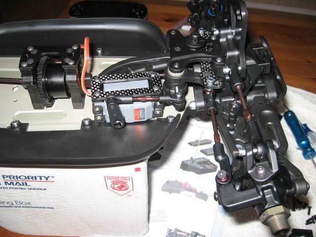

Now with the main chassis installed it was time to move on to the steering servo installation
http://i264.photobucket.com/albums/i...7/IMG_2903.jpg
http://i264.photobucket.com/albums/i...7/IMG_2905.jpg
http://i264.photobucket.com/albums/i...7/IMG_2907.jpg
http://i264.photobucket.com/albums/i...7/IMG_2909.jpg

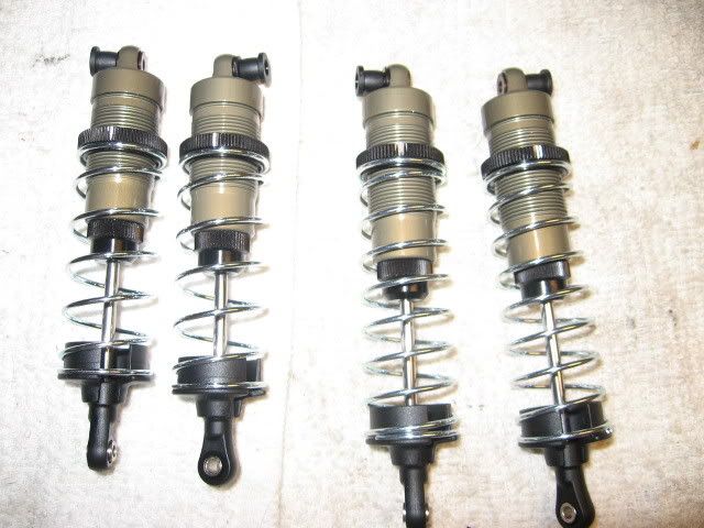

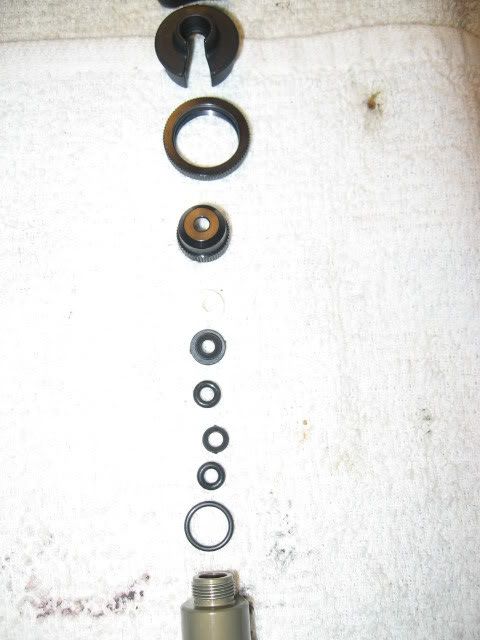

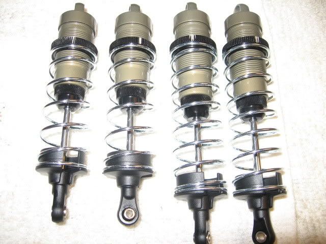

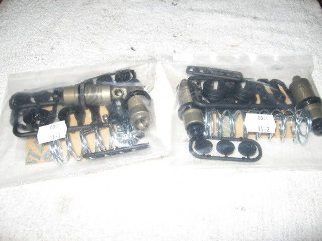

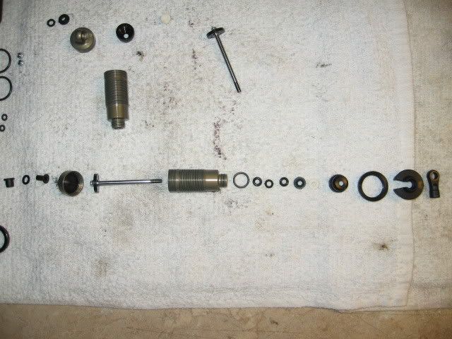

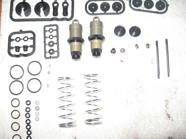

So with the basic chassis complete it was time move on to the construction of the shocks. I was extremely impressed with these / quality. I’ve had lots of experience dealing with the Traxxas big bore and the Integy MSR ones but these (but far) are superior, I can now understand why Neil installed them on his G3.0. again Neil is the man with the plan..
http://i264.photobucket.com/albums/i...7/IMG_2910.jpg
http://i264.photobucket.com/albums/i...7/IMG_2912.jpg
Please note that these bad boys consist of no less than 22 components per shock!
http://i264.photobucket.com/albums/i...7/IMG_2914.jpg
http://i264.photobucket.com/albums/i...7/IMG_2917.jpg

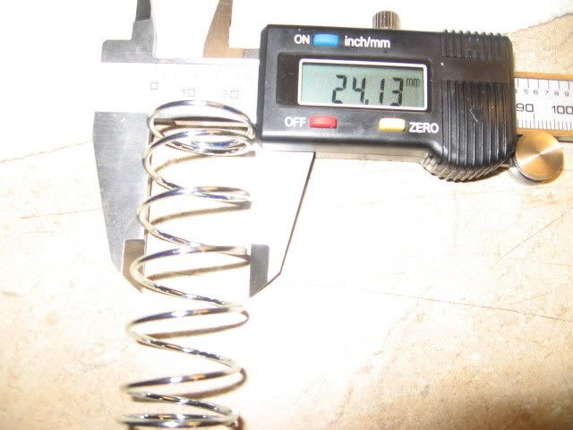

And they are HUGE!!! Here is the spring diameter
http://i264.photobucket.com/albums/i...7/IMG_2916.jpg
Well with the internal parts installed and set at 50% rebound (per Metalman) AKA Travis, I used a cutting tool on a Dermal to cut a little groove in the centre of the adjusting nut. I did this after I had assembled the shocks and made sure it was screwed all the way on to the body. It just means you can easily make equal adjustments left and right.
http://i264.photobucket.com/albums/i...7/IMG_2918.jpg
http://i264.photobucket.com/albums/i...7/IMG_2919.jpg

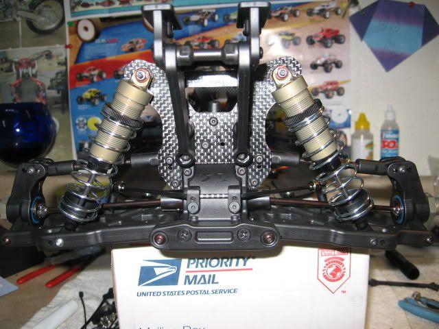

Excellent, now that the shocks are built it’s time for the installation of these bad boys, witch in turns brings me one step closer to completion. I did find it weird that the front right and rear left required a special silver screw turned counter turned clockwise is required, but hay who am I to question the manufacture / direction requirements. Especially at this hour.
http://i264.photobucket.com/albums/i...7/IMG_2920.jpg
http://i264.photobucket.com/albums/i...7/IMG_2921.jpg
http://i264.photobucket.com/albums/i...7/IMG_2922.jpg

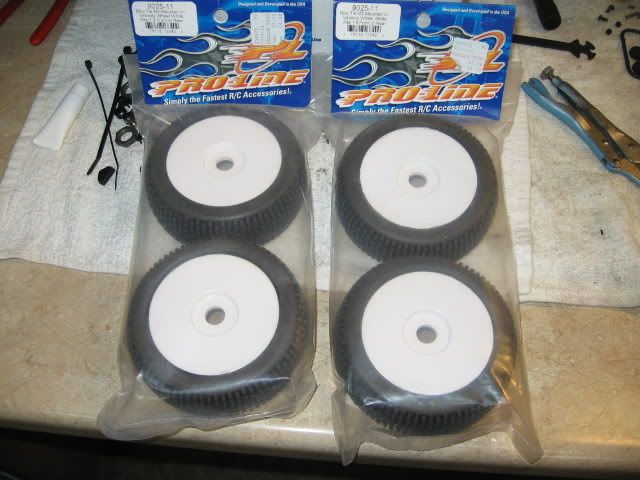

Ok I'm totally stocked at this point, now it’s time to install the rims and tires and the wing on this bad boy,
Yes I went the easy route and just purchased a set of buggy wheels with Bow-Tie installed on them already.

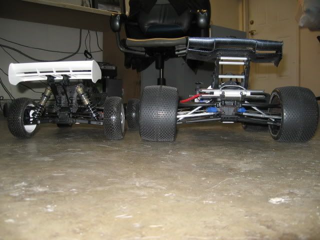

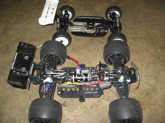

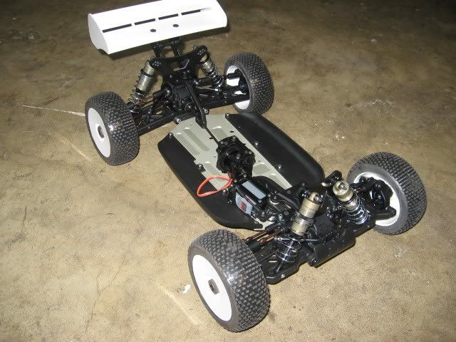

Wow my first impressions of this build once the basic build is complete is (wooow this thing cute!!)
Ok Now that the basic buggy is complete minus the motor and ESC (something just doesn’t feel right??) sure it looks good but lets do some comparison with it competition, AKA the GR3 E-Revo.. Wooow the differences are huge!! I hate to admit it but my first impression is my E-Revo will dive over this buggy and wont even bother looking back, What am missing here??. It’s a 1/8 scale same as my GorillaMaxx but it’s shorter, lighter and just feels / looks like my Meu 1515 !.5 ys will rip a hole in it!?? there is no way in hell this thing will last / take the kind of punishment I thought / hoped it would..
Team, am I missing something here??? It’s is truly stronger and handles better than I can imagine?? As stocked as I'm with this build it just feels / looks fragile compared to my GR3 and my other builds..
