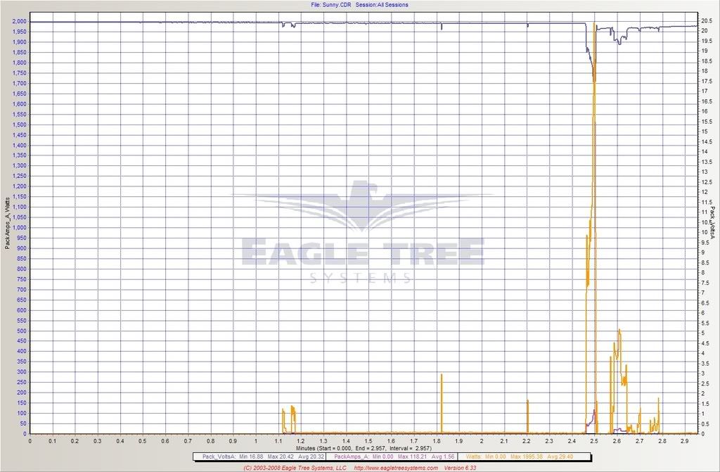

The only problem I've had was when I forgot to run the cooling fan. Also, I have to bring the pack voltage down to about 20.6V. MM's a champ!
Edit: Here's a data log from my Rustler on 5S from a few weeks ago pushing around 1995 Watts:
http://i256.photobucket.com/albums/h...8EagleTree.jpg

Don't forget that the Eagletree response time is a little slow, and does some averaging on current. We measure 1200A peaks on our systems that the Eagletree shows as 120A peak. :tongue:
So some setups (especially those that use very low resistance motors like the Neu motors) can be tough on an ESC.
As for the voltage on the MM -- when we changed from 36 FETs to 30 FETs on the MM, we also changed from ~2.2 milliohm FETs to ~1.5 milliohm FETs, so the newer MM can actually handle MORE current with fewer FETs (we reduced the FETs to make the MM easier to build.) The MM is copper limited on how much current it can handle (the limit is no longer the FETs, but how much copper we can cram into the circuit board.)

I didn't really think about the response time and current averaging. Man, I'd love to have my cars hooked up to your machines to see the real currents under load.
But not to worry, I use cheapo Feigao/Traxxas VXL motors, so the ESC's are safe! :rofl:
Thanks for the info on the differences in the old and new MM. Given that, It's a good thing that I design my systems to top out at about 120A - 125A (albeit read off an EagleTree). The only time I've had failures were when A123's were involved, due to negligence on my part.
