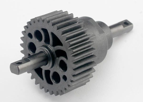

sjcrss 09.17.2008 06:13 AM
here is a question for you...since traxxas came out with there's and hopefully you can buy just the gear, like you can with the nitro revo, couldn't you just use the gear and put your own cup/internals...ect. on it and help reduce the machine time on the gear, and the cost as well...the question would be, is which cup is a direct replacement and that can hold the 4 spyders that we want...
here is a pic of the traxxas on w/ gear...
http://img.photobucket.com/albums/v4...centerdiff.jpg
here is another question, ae all diff cups bolt pattern the same......does anyone have any info on this....
If traxxas will sell the gear seperately we may have a winner. I would just mod the adapter that I am having made to bolt to this gear. Hopefully they sell it seperately, as they do with the revo center diff:

No problem, the more ideas I here the better the finished product will be! I am glad you posted a pic of the erevo center diff, now I can see what it looks like. Where did you find the pic?

The maximizer cup uses std traxxas internals, so 2 spiders and 2 output gears. I will see if I can get my hands on a center diff kit, and try to use the gear on my adapter. I have a revo center diff, wrong number of teeth, 29 vs 33, but it should be the same size...

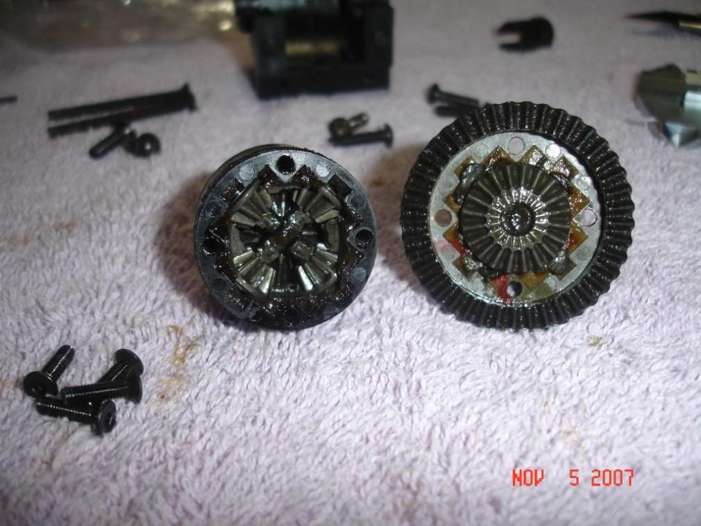

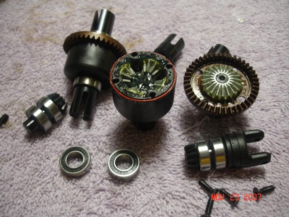

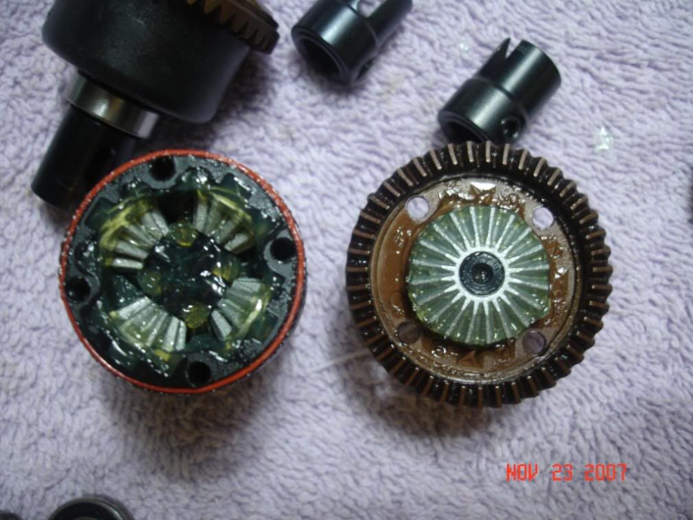

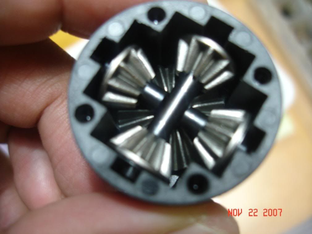

By 6 spider, you mean 4 spider gears and 2 output gears? A six spider diff is like the ofna spyder diff, and the ue diffs. A 4 spider gear diff is like a std 1/8 buggy/truggy diff.
George16 09.17.2008 11:05 AM
Yup. 6 spider gear = 2 bevel/sun gear and 4 side gears.
Ofna ravager 6 spider diff:
http://i256.photobucket.com/albums/h...Picture006.jpg
http://i256.photobucket.com/albums/h...Picture014.jpg
Ofna Hyper 7/UE 6 spider diff:
http://i256.photobucket.com/albums/h...Picture017.jpg
http://i256.photobucket.com/albums/h...Picture018.jpg
Ofna Hyper 7/UE 8 spider diff:
http://i256.photobucket.com/albums/h...Picture093.jpg
http://i256.photobucket.com/albums/h...Picture094.jpg
What UE sells as 6 and 8 spider diffs are nothing but Ofna Hyper 7 6 and 8 spider diffs. UE just added the diff outputs, shims, and Ultralite cases in the kits they sell for $$$$.

I doubt that you will find that. Looks like traxxas uses the gear on the center diff as the cover.
When cowbody made the setup for the nitro revo he used a different gear, as he had it machined to mount to an adapter that acted as the diff cover.
My main issue with the traxxas design is that it uses the output shafts to hold the assembly up via the stock bearings. I plan to have the diff case and my adapter run on bearings, and the shafts will run inside the diff and the adapter, just like they do on an 1/8 scale diff. Should last longer and rotate true. Plus my design will have a 4 spider diff, not the 2 spider traxxas setup.
