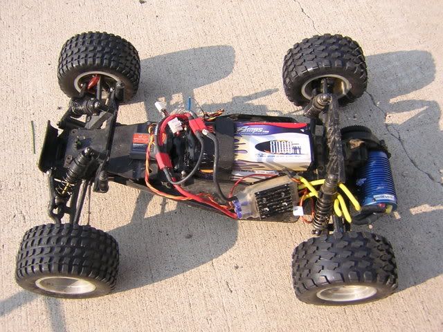

Well my pede hasn't had much attention lately so I gave it a bit of a make over...
I think the motor (CC 1515 1Y 2200) is overkill but needed to run it in something - I can't get a MMM in there though as the motor wires aren't long enough so opted for a trusty MM.
I inverted the RPM bumper and added some lead to help keep the front end down. I think I may have to lose the wing but will see what happens... I checked and it looks like a revo 2.5 body that I have will fit pretty well if I lose the wing...
Any other suggestions?

Dang! Someone beat me to it! lol A wile ago i tried to get my 9xl to fit into my rustler but my swamibar was in the way and the 9xl wouldn't fit. lol
Nice PEDE tho!!! I'd really love to see a video of that thing run!!!!

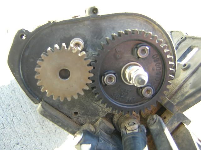

http://i140.photobucket.com/albums/r...y/DSCN1511.jpg
I've already done this...insane power for the platform.
http://i140.photobucket.com/albums/r...y/DSCN1515.jpg
24/38 fit just fine and it had more than enough power, I could go to a 34T spur and whatever the biggest pinion is and still have power left. I wasn't able to get my Rustler completely set up for speed before this thing stripped a stub axle (twisted the U-joint right off). It's very heavy, but it goes like stink!

Done this , been here :) only I was running a Novak 4.5. I only managed right over 70,then it was just to uncontrollable on foams.It would start drifting and correcting would make it go haywire. I did not run lead up front,I added a little wing to the bumper.It had no trouble keeping the front down.But it was very unstable. Good luck with this,I always thought it had 80 in it.For the diff you could try this http://cgi.ebay.com/ws/eBayISAPI.dll...%3D4%26ps%3D42 then use Jato shafts and your about as strong as it gets.
