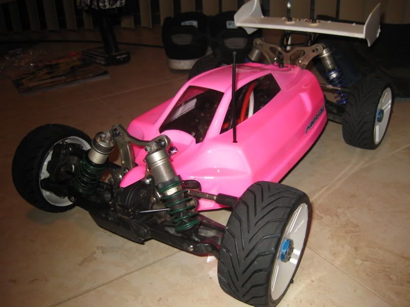

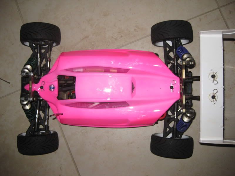

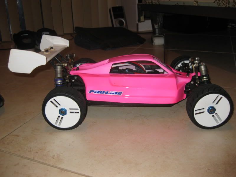

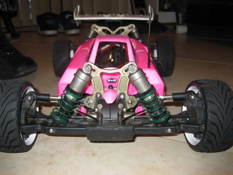

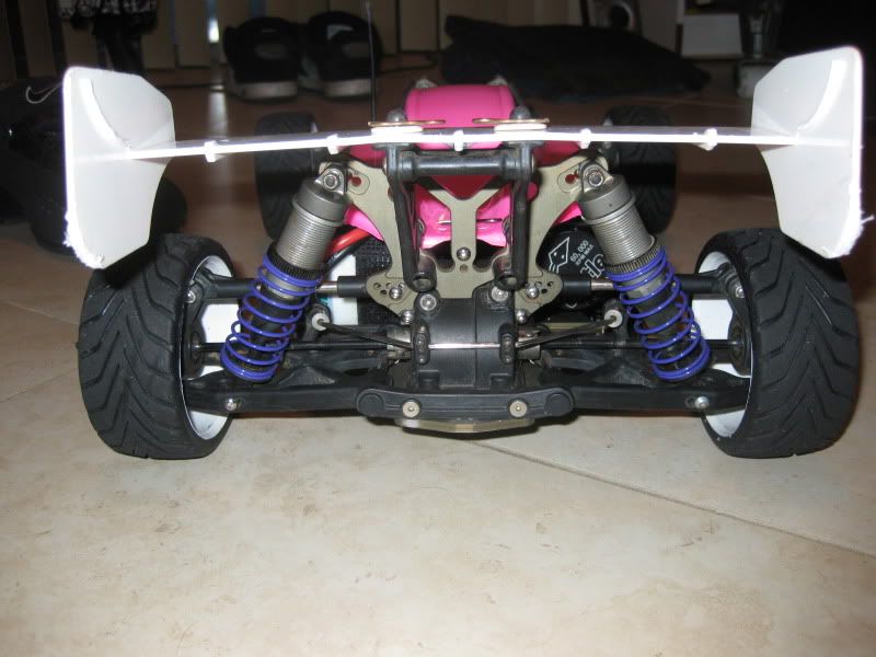

Mine is setup like so:
Front:
80wt oil
10k diff oil but am going to try something stiffer
Green springs
droop at arms level
black sway bar
just a very slight amount of toe out to eliminate turn-in (makes it less touchy at high speed)
Rear:
80wt oil
light diff oil (1-3k is fine)
Purple springs
droop at a little past arms level
silver sway bar
standard 3degrees toe in
Center diff J-B Welded together.
Now for some pics of the new look, dubbed Miami Vice :intello:
http://img.photobucket.com/albums/v3...2/IMG_0121.jpg
http://img.photobucket.com/albums/v3...2/IMG_0122.jpg
http://img.photobucket.com/albums/v3...2/IMG_0118.jpg
http://img.photobucket.com/albums/v3...2/IMG_0120.jpg
http://img.photobucket.com/albums/v3...2/IMG_0116.jpg

is that an ofna high flow wing? they work great. i just finished another 8ight yesterday. i'm kinda shelving the tekno build right now because you said you didn't care for the new mounts. i gotta figure out a way to get a high torque mini servo on the stock chassis if i wanna use manual brakes with the phoenix on 8S.
cool looking lid btw. Crocket would be proud. :rofl:
DCastaneda 12.24.2009 01:03 PM
I'm going to give mechanical brakes a shot this coming week, just don't want to incinerate brake disks.
I have some composite ones that should do the trick though ;)
Wing is a stock losi cut down
