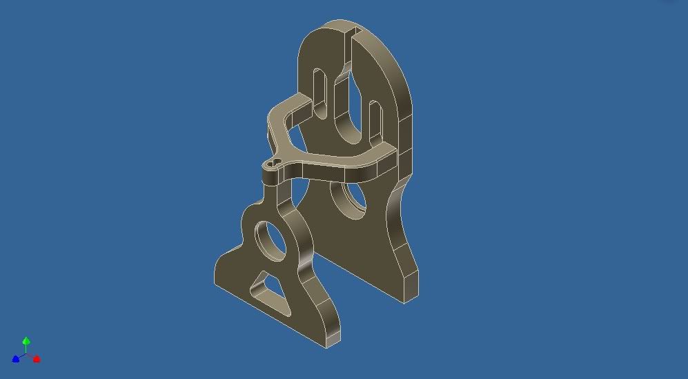

http://i152.photobucket.com/albums/s...motormount.jpg
bruce750i 01.05.2010 12:32 AM
That has some sexy curves to it!
_paralyzed_ 01.05.2010 01:20 AM
you need little "ears" where the horizontal part attaches to the motor mount, otherwise the screw heads sticking out the back will interfere with the motor. Looking good.
brushlessboy16 01.05.2010 02:00 AM
mine will be countersunk into the back of the mount- wont interfere with the motor :intello:
