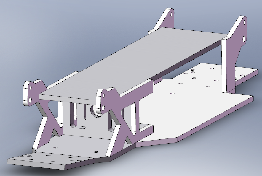

Not as much time tonight to work on it as I thought, but I'm dead tired so I'm going to sleep, I promised pictures so here's what I have so far! The general idea is there, just have to refine it a bit.

concreat 05.05.2010 07:39 PM
i was think along the same lines as you, with the small TVPs at each end to give it some stillness, but i wasnt going to use a top plate.
why have you done that, what are you going to put on there?

And I actually took away the whole top plate TVP thing, I just couldn't have it how I wanted it and it was getting too complicated. I'm back on track with the old design + a few tweaks on it, just need to get the chassis bracing squared away and I'll be good to go. :yipi:

BitHed 05.06.2010 12:17 AM
basically my issue is FLEX...would i want to use a top plate to eliminate it? To give myself more room to place stuff? With the lower TVPs / struts if you will, which merely serve to anchor the bulks to somthing solid, (reducing fore and aft movement), do i need a top plate to reduce sideways flex? Or are the cut down TVPs going to achieve that already? I am all for LESS metal :)
Cody.McP 05.06.2010 01:28 AM
Well I'm not too worried about flex really, I'm actually kinda hoping it flexes a little bit. Flex acts as a bit of a cushion on other parts in my mind, and my new setup for this probably won't allow bending/breaking things flex, but it'll allow for a little wiggle room so to speak. I'm just trying to keep things as simple as possible for now. Simple = less parts = less money :yes: and it's nice to have it all simple to work on and such. I'll be done with the main design in about an hour and I'll post it up so you can see my approach on things. After that it's just a bit of refining and I should be able to send it off to the machinist tonight/tomorrow. :yipi:
