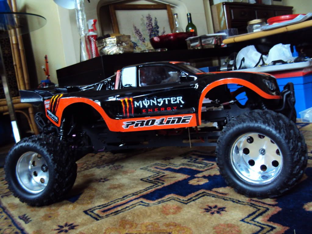

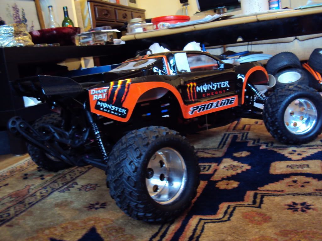

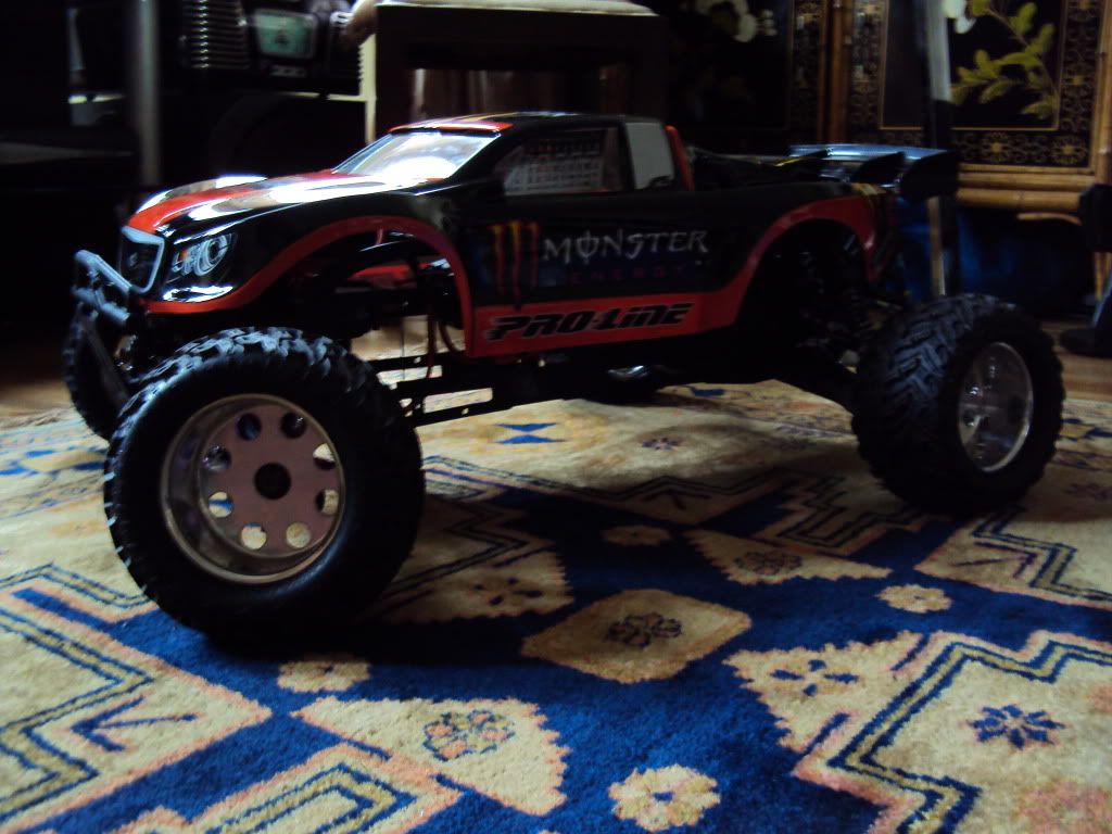

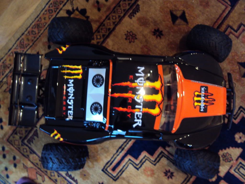

Anyway in the quest to keep my weight down... i no longer use the heavy fibre glass body and managed to finish painting my desertrat body... what do yall think???

It came out well for a first paint job :)
suicideneil 05.01.2010 06:43 PM
Indeed, that looks great. :yes:
The wing seems a bit undersized compared to the shell, might be worth looking at a proper baja or other 1/5 scale item, but it looks alright really. :smile:
Jahay 05.01.2010 06:52 PM
Oh neil!!! Why did you have to point that out lol It does look undersized in the pictures.. .but looks acceptable in person... DAMN now i am going to go look for a larger wing! Thanks for helping me spend my money neil lol
What's_nitro? 05.01.2010 10:26 PM
Nice job on the body. I think the wing looks fine 'cause it lines up with the points on the back end of the body. :yes:
