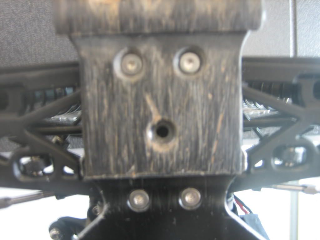

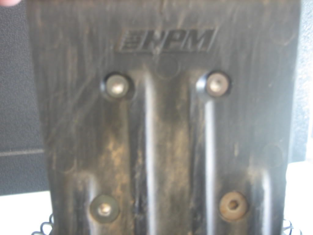

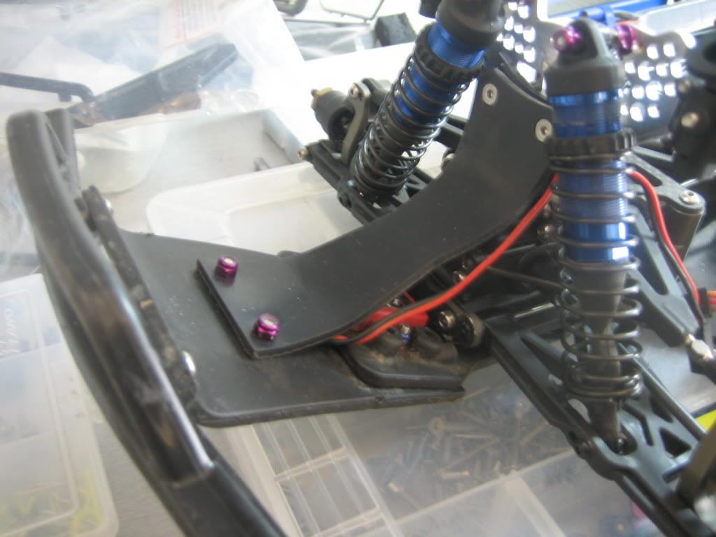

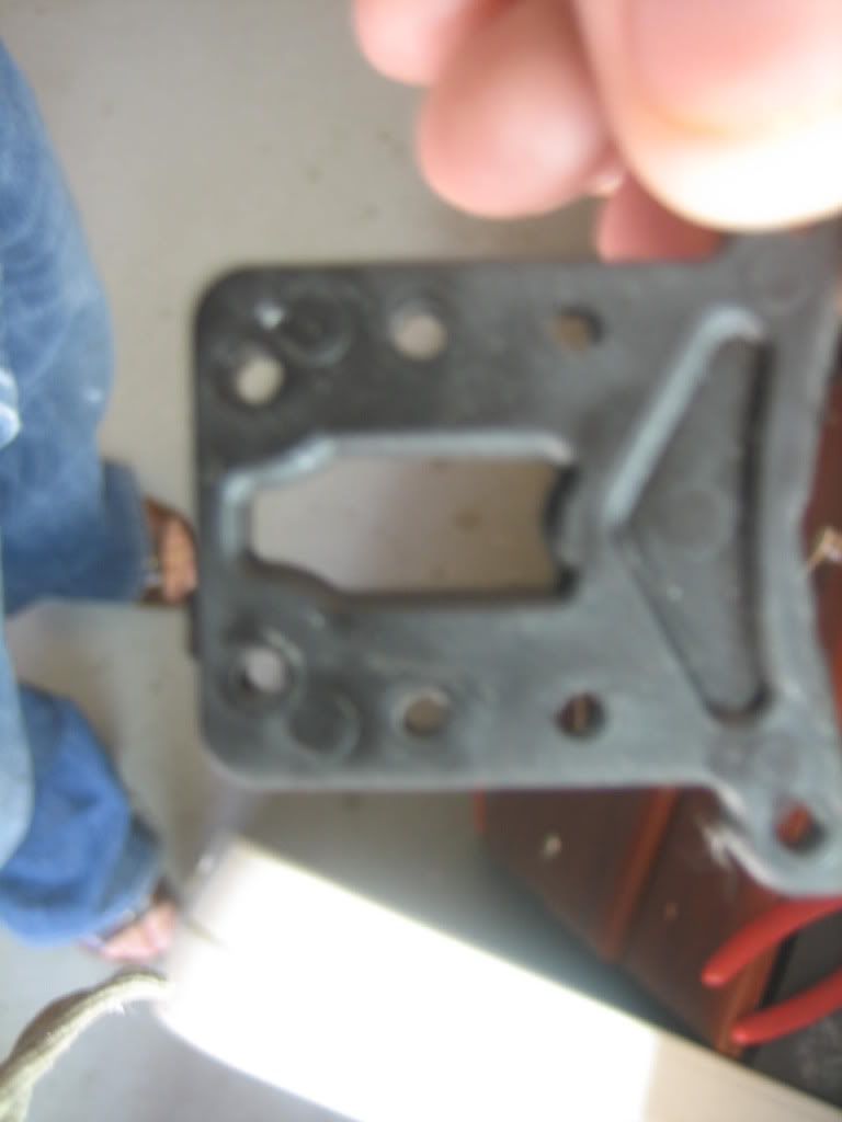

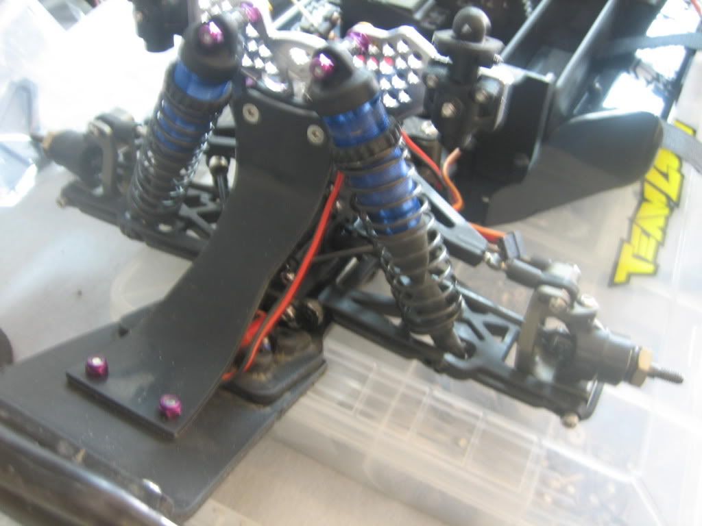

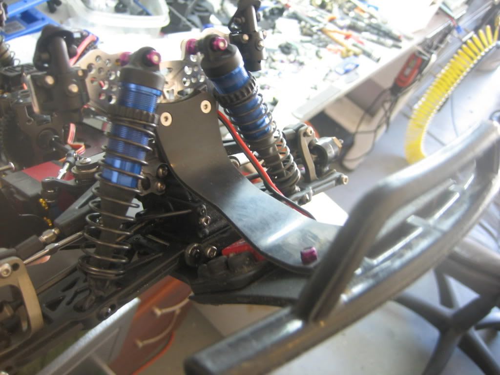

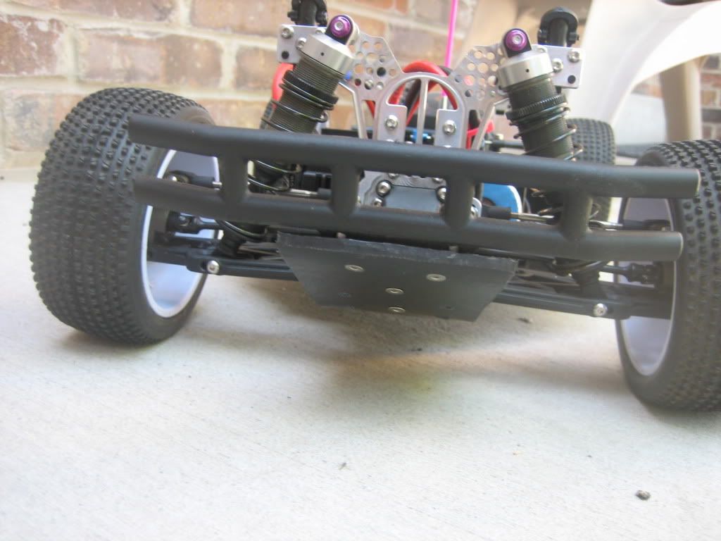

ok. here are my pics of the front bumper setup. i used a 4x4 slash rpm font bumper, a TBR bumper brace, and the stock plastic shock tower part.
first cut the arms off the "Y" shaped stock part. i shaped mine to be the same shape as the tbr brace. then you need to use a dremel or 1/8 drill bit and grind out a tiny portion of material from your ERC tower where you see the screws with purple locknuts mounted in the pics.
mount the plastic piece to your ERC tower through the bottom holes that mount to the top of the bulkhead.
http://i471.photobucket.com/albums/r...ujames/002.jpg
http://i471.photobucket.com/albums/r...ujames/003.jpg
then mount your tbr brace through the top holes of the plastic part and through the tower. secure on the back with locknuts.
next, mount up the slash bumper. the stock holes line up close enough to just mount to the chassis.
line up the holes in the tbr brace to your slash bumper and drill 2 holes. counter sink, and then screw it together. viola! (the wire you see in the pics is my AMB transponder)

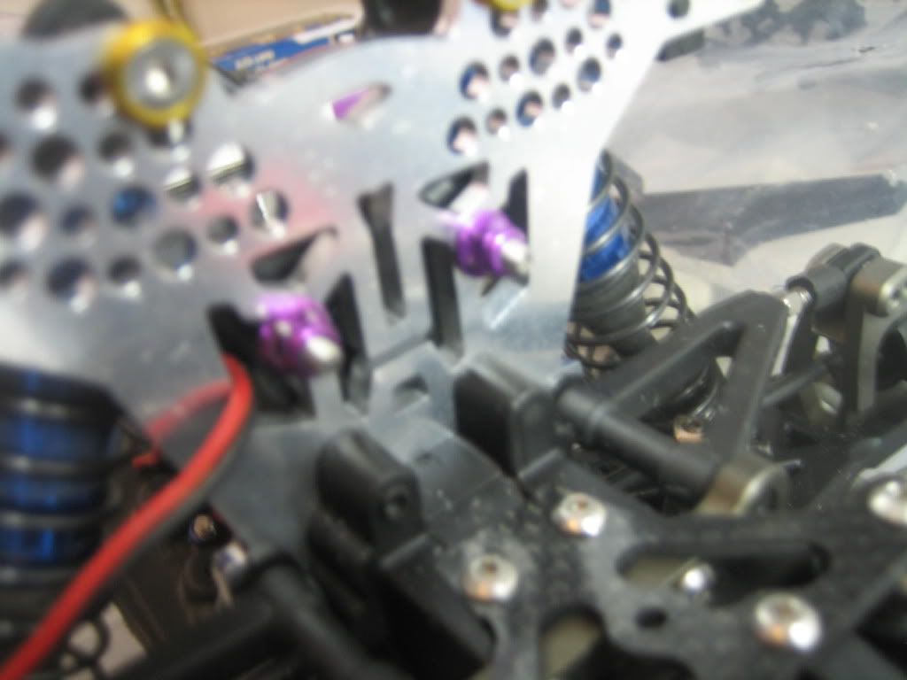

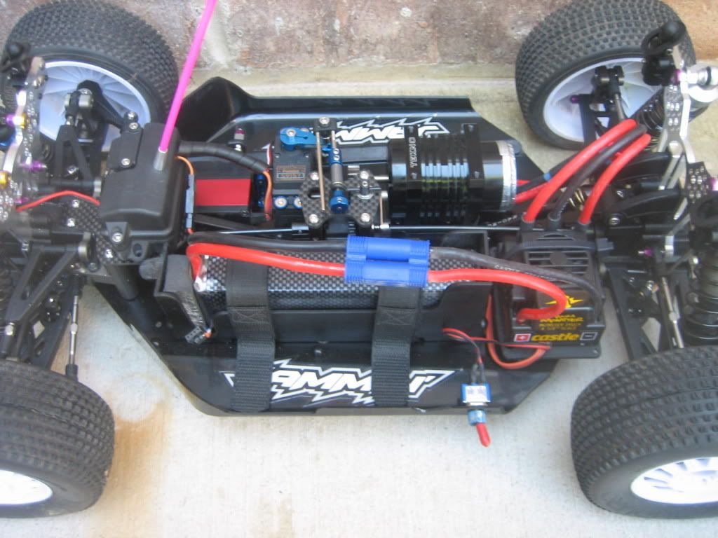

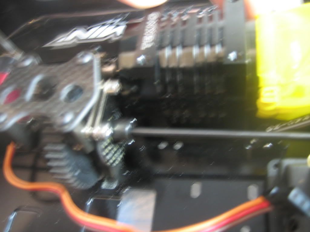

here are just a couple of quick pics of the layout. nothing is mounted up yet but i should have it finished tonight. i decided not to do the carbon parts yet. i have a TenT i am building and will be using carbon for that build. anyway, cant wait to race my jammin. the TenT rear shocks on the front are very responsive and feel great.

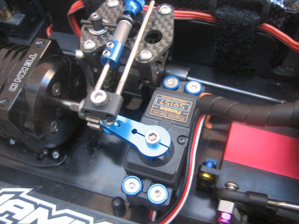

so i actually got my jammin finished and raced it this weekend. to answer your question from experience now the jammin has nothing on the slash 4x4. mind you, my slash was decked out fully but i liked it better....so far. i am going to continue to tweak my jammin and get it dialed in and i am sure i will like it but my lap times were fast with the slash.
one plus to the jammin though is the mechanical brakes i hooked up.
one big negative on the jammin is the chassis catches any rough spots on the track and send you flipping. this was happening to me and my friend who was driving his jammin for the first time. his was all stock with the Chad Bradley settings. where the chassis angles outward from the nose as it gets wider would catch the ground and just dig and flip. need to find a way to fix this. going stiffer springs and fluid changes your handling but might be the only way.

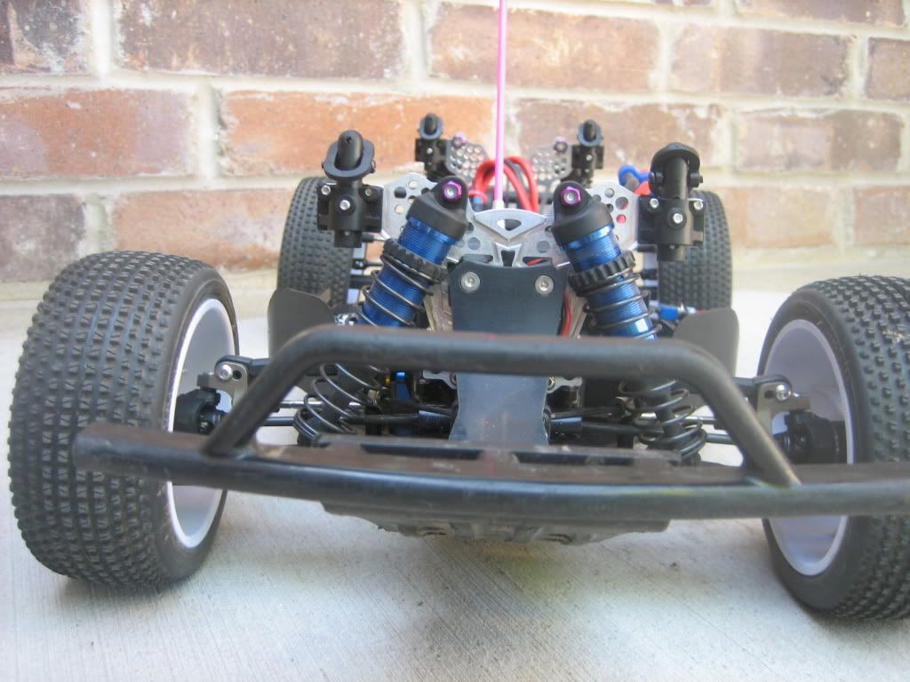

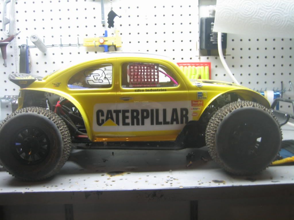

here are some pics of my finished jammin. still need to get front brakes hooked up. and i didnt end up doing any carbon on this one. saving that for my ten t build.

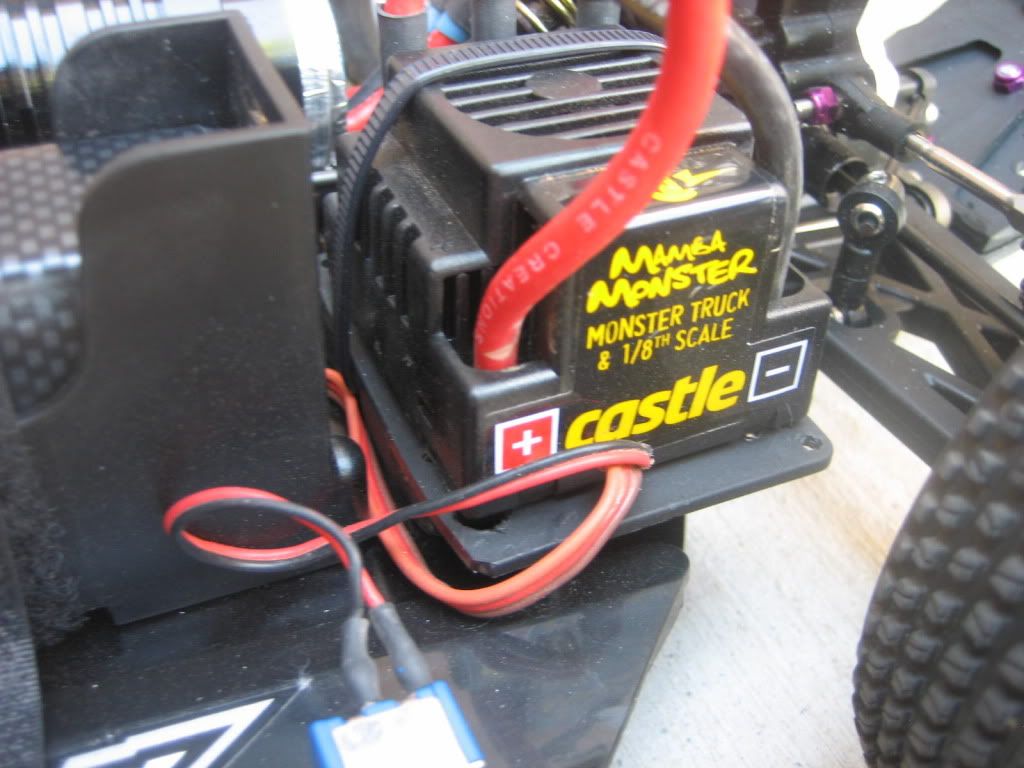

JoFreak 07.07.2010 06:07 AM
Nice, what did you use for the rear bumper and what shocks are those?
Mechanikal brake parts are from the CRT.5 I guess?
Centerdiff CF top plate from the CRT.5 as well?
Did you make the upper steering plate yourself?
Slash front or rear offset on those wheels?
Don't you think the ESC switch is in a disadvantageous location?
Especially if it is in the off position as shown in the first picture.
Lot's and lot's of questiions, I know...
Ryu James 07.08.2010 03:50 PM
rear bumper is a TBR skid with the losi LST bumper screwed to it.
front shocks are losi Ten T rear shocks
center top plate and brake parts are all from CRT.5
front top plate i made from 2mm carbon
regular slash 4x4 wheels
the on/off switch i moved. i just put it there for the pics. but i knew it wouldnt last long there.
tonight is race night and i have made some adjustments from last week. i am hoping it drives a bit better tonight and i can get it dialed in.

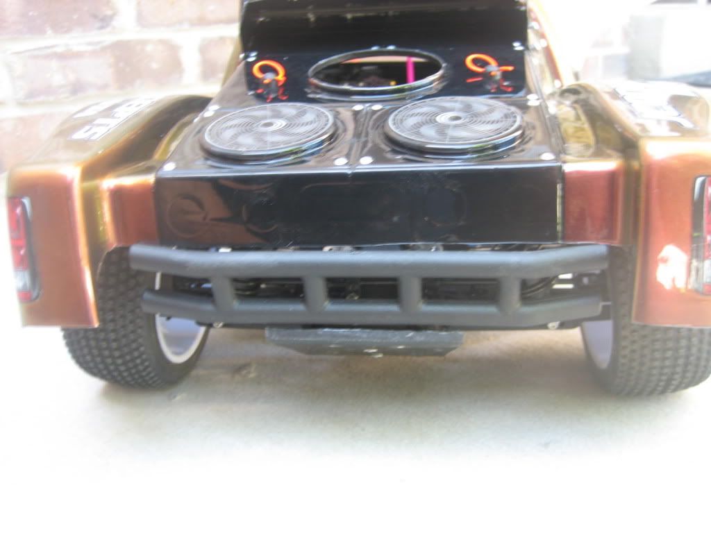

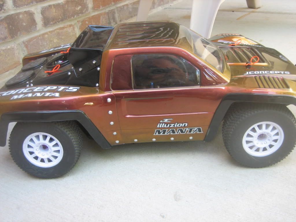

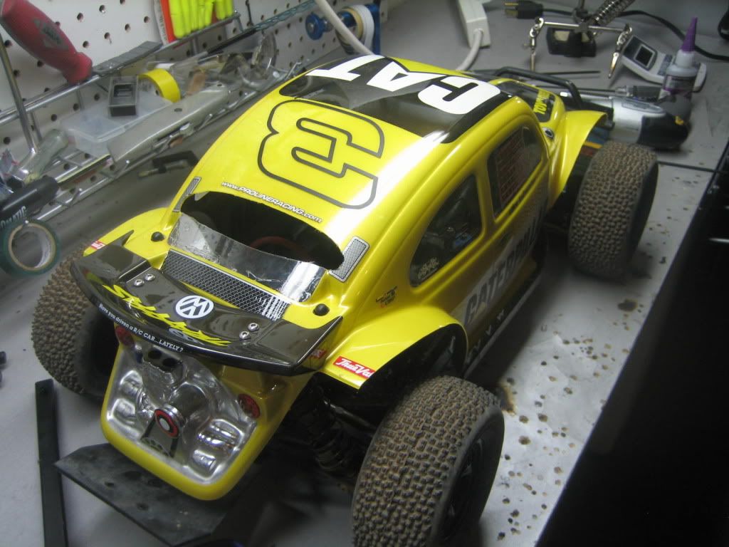

Ryu James 07.24.2010 05:20 PM
recent pics!
got a new body mounted up on the jammin. then my track tells me that i cant use it cuz it doesnt cover the wheel wells. anybody with a jammin interested in this body?
i really like it and its more aerodynamic. the other thing thats cool is the side of the body sits inside the chassis mudgurads so it really keeps the inside of your ride clean.
