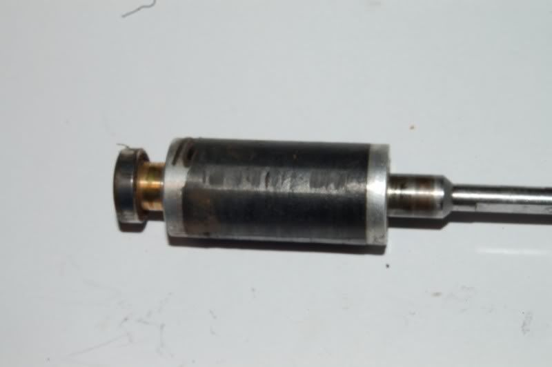

Sounds good. But I didn't get a pic of the other side of the stator, and it looks a bit damaged:
http://i94.photobucket.com/albums/l8...v/DSC_1000.jpg
florianz 08.30.2010 11:04 AM
hm, if some cabon is loose, put some thin super glue on it.
the carbon of my medusa 3680 got damaged, so I soaked the entire carbon bonding with super glue. works well so far.
Dj_Sparky 08.30.2010 11:06 AM
Great. Thanks for all the help. :)
I will try some WD-40 inside the can itself on the rust. It's supposed to be somewhat safe for electronics -- removes moisture and clears out rust.
florianz 08.30.2010 11:20 AM
right, it solves rust. but it should not stay greasy afterwards. whipe off the oil later. maybe you invest 2 bucks for one of those technical cleaners, which are used for PCP's.
