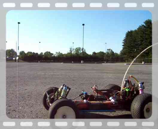

I tried all of the timing settings and they all performed the same.
Even though it's a push start vehicle, I'm still having a ton of fun with it because it's the fastest vehicle I've had in 2 years. The crawlers top out around 4 mph :027: .
Here's some video...kinda sucks cause I need a camera man.
http://i20.photobucket.com/albums/b2...h_100_1640.jpg
http://i20.photobucket.com/albums/b2...h_100_1641.jpg
