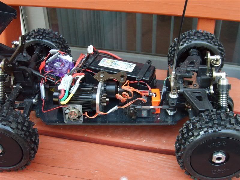

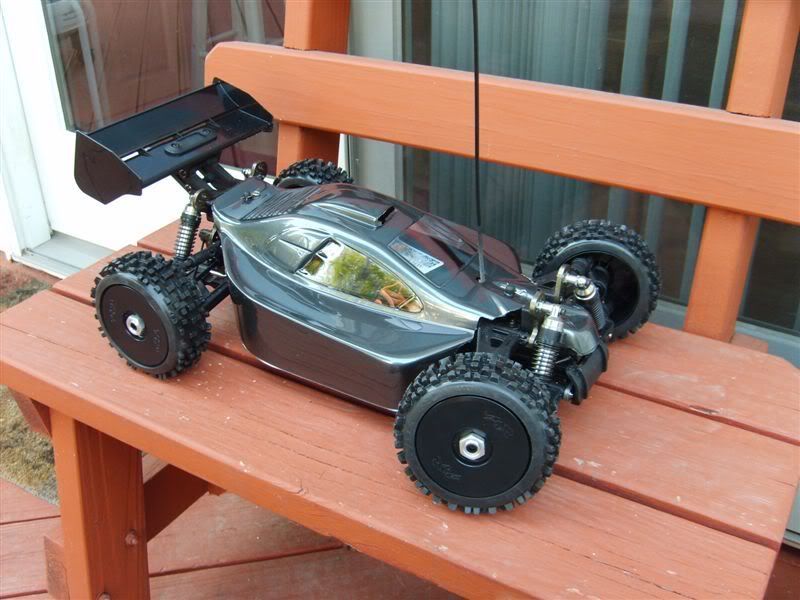

B15 10.17.2007 04:40 PM

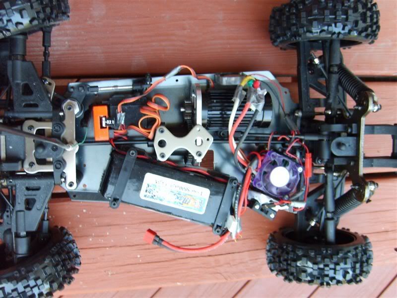

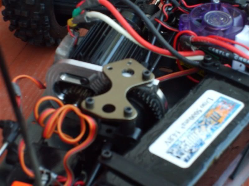

Heres my Yusa I just finished.
http://i65.photobucket.com/albums/h2...s/S5000318.jpg
http://i65.photobucket.com/albums/h2...s/S5000319.jpg
http://i65.photobucket.com/albums/h2...s/S5000320.jpg
http://i65.photobucket.com/albums/h2...s/S5000322.jpg
http://i65.photobucket.com/albums/h2...s/S5000321.jpg
So far it has a 7XL on 4S 5Ah Maxamps lipo, geared 18/46. I used the Kyosho motor mount that mike sells. The batteries are mounted with associated cups to a sheet of lexan that is bolted to the chassis. The body is a trinity wasp made for a mp7.5, and the tires are proline badlands on panther dish wheels. Ill let you guys know how it drives when I have a chance to do that.
lutach 10.17.2007 05:04 PM
Very nice. I like that body.

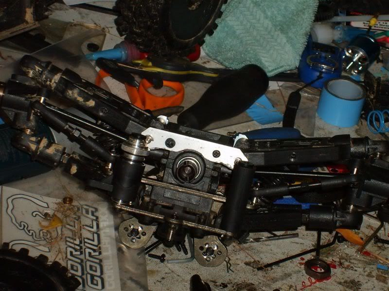

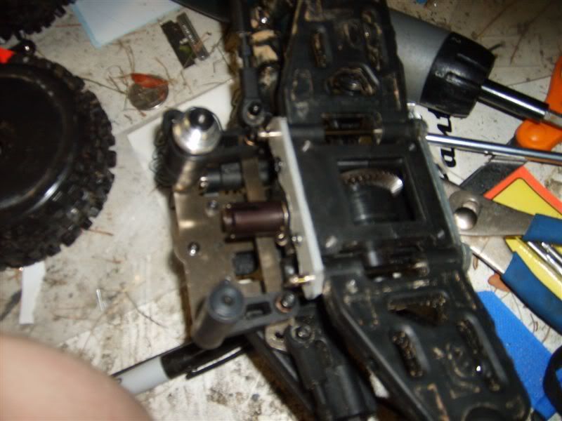

Okay i have finished mine too. Well i will be changing one more thing. I am going to add a HB LSP center diff as soon as it is shipped to me. Let me know what you think.
[IMG]http://i237.photobucket.com/albums/f...Picture340.jpg[/IMG]
[IMG]http://i237.photobucket.com/albums/f...Picture339.jpg[/IMG]
[IMG]http://i237.photobucket.com/albums/f...Picture338.jpg[/IMG]
[IMG]http://i237.photobucket.com/albums/f...Picture337.jpg[/IMG]
B15 10.18.2007 08:48 PM
Why the LSP diff? Do you have the same front to rear slop in the center diff I do? It seems like the kyosho motor mount leaves some extra space for the center diff to slide back and forth on its bearings.
Mike_D 10.19.2007 08:14 AM
That is exactly why. I tried the center diff from my LSP and it worked a lot better. It's a pretty cheap fix.

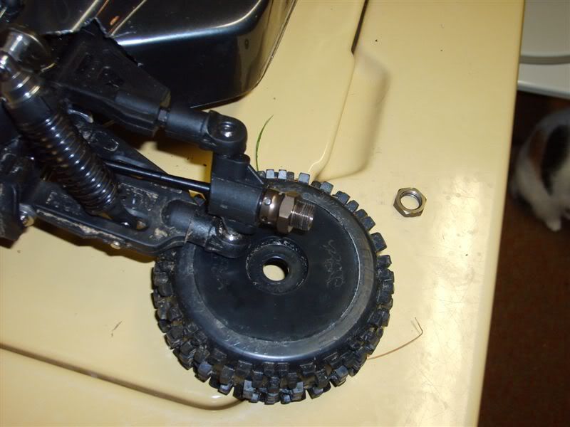

So today I drove it for the first time, and I already broke it. I was driving around my backyard and a birdfeeder pole got in the way at about 30mph. It snapped the front inner suspension arm mount at one of its mounting holes. This a relatively simple part, so I cut a new one out of a sheet of aluminum. The one I broke is plastic, so hopefully this one will hold up if I repeat todays incident. I forgot to get pics of the wreckage, but heres some of the new arm mount going in, and a pic of my first mod to this buggy, the color matching offset hubs.
http://i65.photobucket.com/albums/h2...s/S5000326.jpg
http://i65.photobucket.com/albums/h2...s/S5000327.jpg
http://i65.photobucket.com/albums/h2...s/S5000328.jpg
I also have an LSP center diff in the mail. Thanks for that idea, Mike D. These have 50t spurs correct? Did you have to dremel the chassis at all to clear the extra diameter?
Mike_D 10.20.2007 07:14 PM
No i did not have to, i am using the Kyosho 46 tooth plastic spur gear.

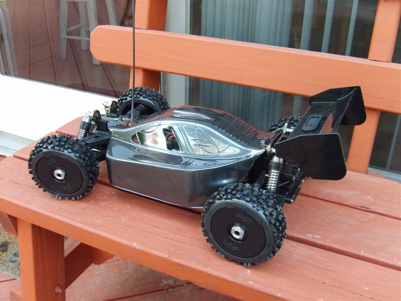

MetalMan 10.20.2007 11:29 PM
Mike_D, that body you're using, it's a Proline Crowd Pleaser for Hyper 8, with Racing Finish Metallic Blue, isn't it? I have that same (or VERY similar) body on my Hyper 8 with metallic blue fading to black.
Mike_D 10.21.2007 02:38 PM
Metalman, you have a very good eye (no pun intended). I went with that body just because i like the way it looks on the hyper 8 so i bought it and just cut it to fit the Yusa, it works. I always go with a solid color because i suck at painting and my bodies don't usually last me long enough to put in much of an effort to try and do a good paint job.
