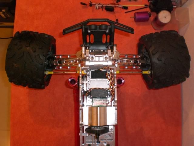

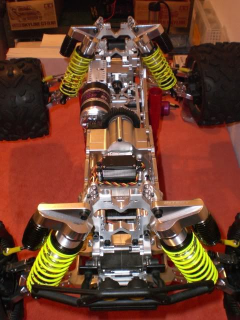

You can see where i replaced the single tabs with 'full length' tvp braces(forget the name?) in this shot - look for the larger 4mm screws in the chassis' deck, one is covered by the esc mount - had to countersink the holes a lil tho =)
http://i211.photobucket.com/albums/b...20There/07.jpg

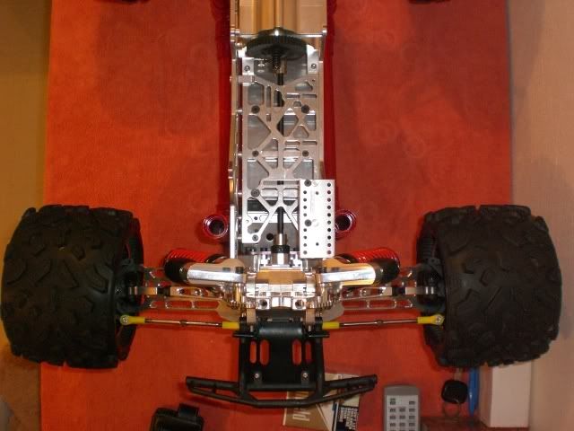

Front birds-eye
http://i211.photobucket.com/albums/b...20There/08.jpg
I got a real clean/spoofy/bling idea for hiding all the wiring too - not spilling anything on that tho - you'll see when it gets done =) (not that it's all that intriguing -lol-) But you can see the power wires for the bec already kinda tucked away sorta under the tranny kinda in the bottom left, so you can see where it's all headed... i have every wire planned out hehehe - not thAT THINGS HAVE BEEN GOING TO PLAN LATELY - BUT IT ALL WILL WORK OUT IN THE END HEHEHE
Bloody caps lock - not going back to redo that hey, sorry
http://i211.photobucket.com/albums/b...20There/09.jpg
Anyways - hope you enjoy - please let me know if you can spot anything wrong/potential issues etc etc or just have some good advice, would be appreciated =)

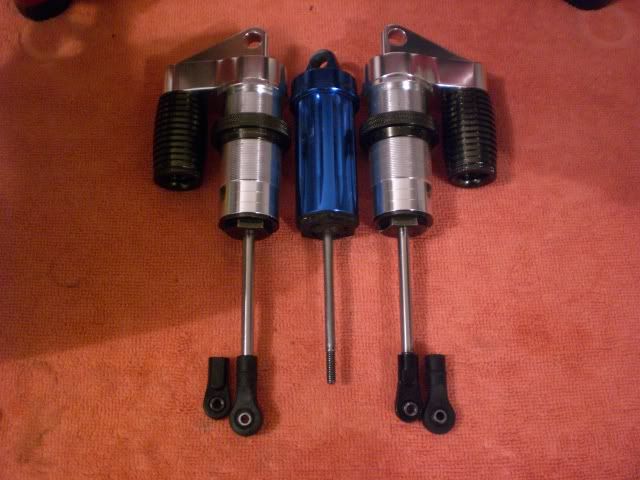

anyways - the shocks...
Integy Piggybacks for the LST
Kinda mixed... some good and some bad... but after initially being pretty unimpressed with these shocks (problems solved as you'll see further on), i'm thinking they should hold up and perform just fine =)
Compared to a stock shock...
...(comparing to the stiffer 'Yellow' Losi Springs) the red springs that Integy supply are slightly thinner than the Yellow Losi springs, and they are also (from memory) around 10mm shorter aswell!
...the body appears to be longer on the Integy shocks... you can see in the picture below - the bottom of the shock body, and the start of the thread on the Shock Shaft, are lined up exact on both the Integy and Stock LST shocks, but as you can see, the top mounting hole is clearly out of line
...the shafts are maybe 1-2mm thicker on the Integy shocks, and they feel a bit firmer - but wont know for sure untill i get it running =)
...the Shock or Rod Ends are pure junk on the Integy shocks - they're too small and WAY too brittle, and when i put the stock LST Ends next to the Integy ones, i knew straight away which ones i was gonna be running - pretty clear to see in the pic - sorry, they're jumbled, but the shock on the RIGHT has the INTEGY Ends and the LEFT shock has the STOCK LST End =)

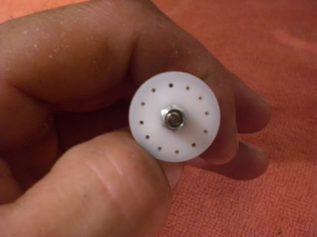

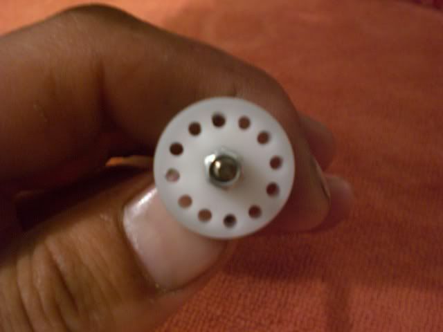

The holes in the pistons clearly needed to be drilled out larger - compression was stiff as even with 20wt oil and no springs!
here's a before...
http://i211.photobucket.com/albums/b...gybacks/03.jpg
OOPS!! maybe went a little too large to start with, considering i plan on strictly using the truck as a basher -lmao- Would suit racing perfectly tho with the stiffer Losi yellow springs (as i have on the truck right now) - forget what size drill i used, but clearly needed the next size down hehehe
http://i211.photobucket.com/albums/b...gybacks/04.jpg
Might need to look into some new pistons before i go jumping it too hard, but other than that it's all going well so far - i'll be back with another update shortly - just some pics of the motor adaptors i got and the truck with the 2230 and shocks mounted up, but for now, i'm ghost =)

I got too very stiff Losi shocks, i have filled them with 500 oil, very liquid stuff... But if i let the car fall on the floor: PLOFFF....
So i'm gonna make the pistonholes too more open because for off-road is sucks with very stiff shocks. On-road it will be VERY good. But i got for that stiff springs:)

Drilling those pistons was the best thing i could have done for those shocks hey - i had a slightly smaller drill around, but i'm impatient, and couldn't find it, so went with what was on hand -lol- I'm thinking i might move up to 35 or 40wt oil, and grab some of the RC Raven progressive springs for these, as i plan on giving it a good kick up the arse on some big jumps i found about 20 minutes away from my house =)
Thanks for the comment mate =D The front has heaps of toe-in cause there are no shocks mounted in the pics, so the arms are hanging a bit lower than normal, but i'm still yet to play with that also =)

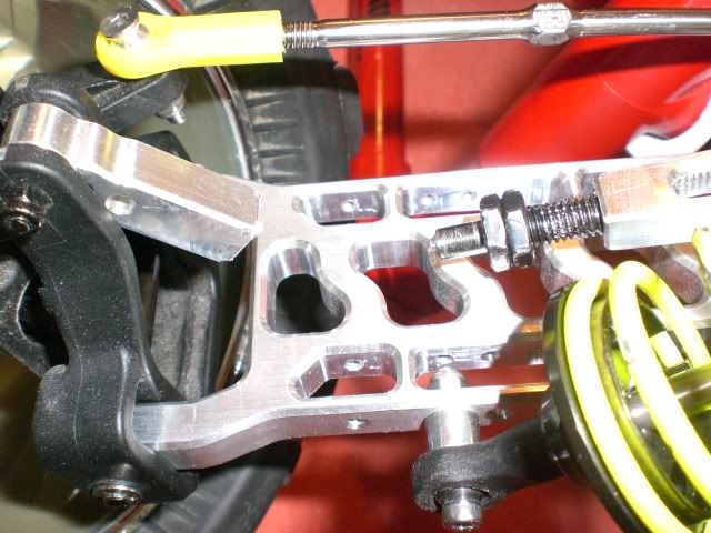

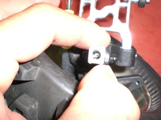

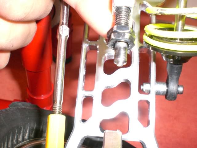

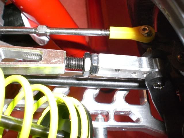

I've run into a small problem with one of my FLM upper arms tho... ok it's bigger than a small problem hehehe
As i was locking the 2 nuts to the outer section of the arm (to stop the play it has there), it appears i tightened them down way too much and didn't realise it, because I've managed to twist the thread so much inside the outer end that it snapped the thread itself! -lol-
will get some pics up soon that will explain much better than my words - been a bit hard to find any time to do anything tho lately, have heaps going on here atm...
***EDIT***
This is what i was shooting for....
http://i211.photobucket.com/albums/b...0Kit/Oops2.jpg
Unfortunately, this is what i ended up with...
http://i211.photobucket.com/albums/b...0Kit/Oops3.jpg
Dunno how good your eyes are - but this is inside the outer arm...
http://i211.photobucket.com/albums/b...0Kit/Oops4.jpg
You can see how it bevels down into ½ the thickness of the threaded rod inside the end of the outer arm...
http://i211.photobucket.com/albums/b...20Kit/Oops.jpg

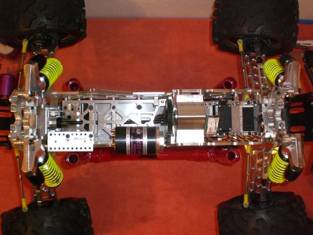

I've also got the 2230 mounted up too, but only a few 'whole truck' shots before i snapped the arm -lol- Uploading em now - there's like - 18 pictures - mostly useless, but gonna add em in here anyway, simply cause i can -lol- Will post back soon =)

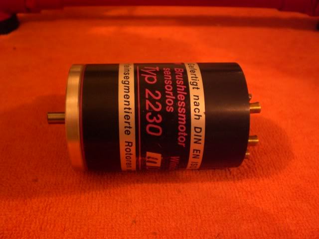

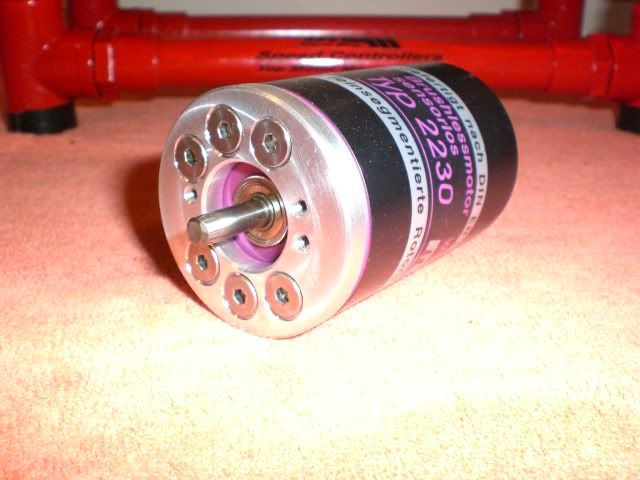

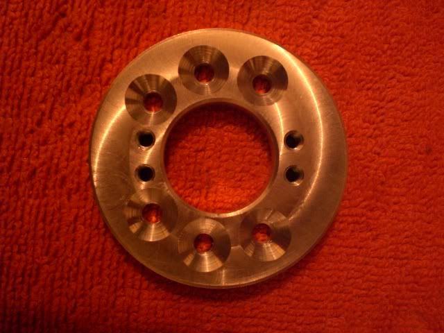

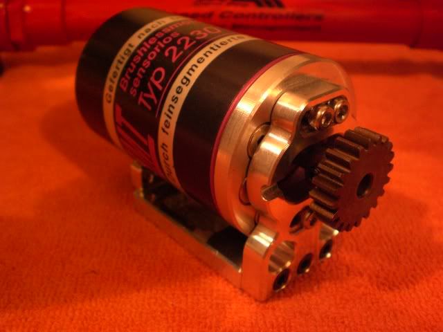

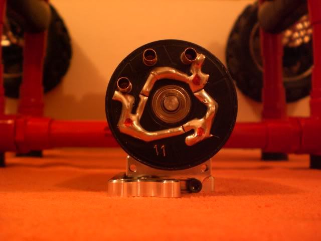

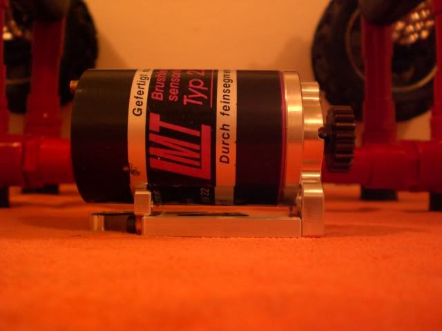

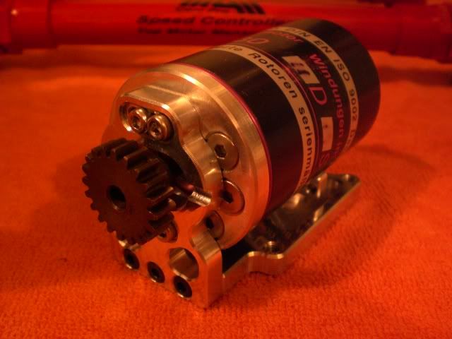

Here's the RCM motor adaptor i received from Mike so i could mount up the 2230...
http://i211.photobucket.com/albums/b...Mounted/08.jpg
I had to drill out and countersink the 6 holes in the plate, so i could get the screws through, but no big drama, and was a 2 minute fix - just wish i had a dril press sometimes though =)
http://i211.photobucket.com/albums/b...Mounted/09.jpg

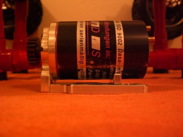

Side shot with the adaptor plate mounted to the 2230...
http://i211.photobucket.com/albums/b...Mounted/10.jpg

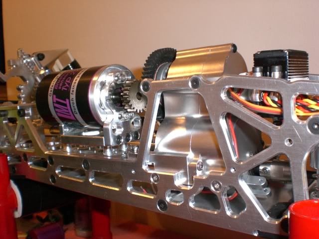

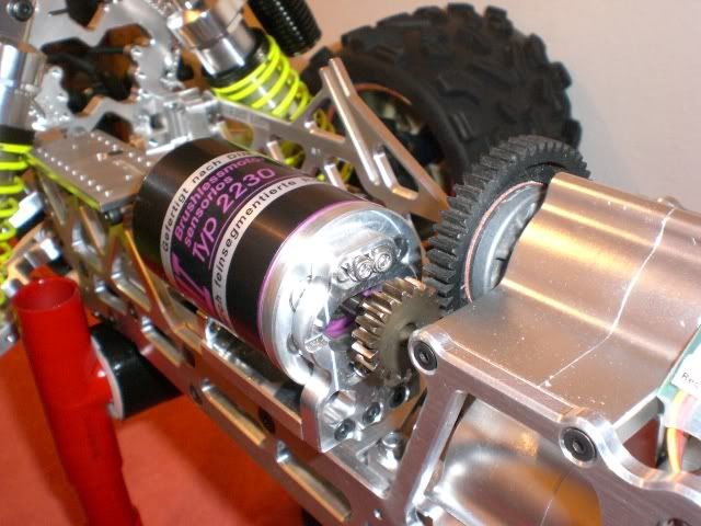

The following couple shots are just different angles when mounted to the FLM motor mount - FLM include 2x Rear Motor Supports - 1 for a standard 540 dia. can, and another for... the next one up, or the 22series - what size is it? 720 or something?
http://i211.photobucket.com/albums/b...Mounted/11.jpg
http://i211.photobucket.com/albums/b...Mounted/12.jpg
http://i211.photobucket.com/albums/b...Mounted/13.jpg
danhfvcsd 11.01.2008 11:15 PM
That's an RCM 20T Pinion in case you are wondering =)
http://i211.photobucket.com/albums/b...Mounted/14.jpg

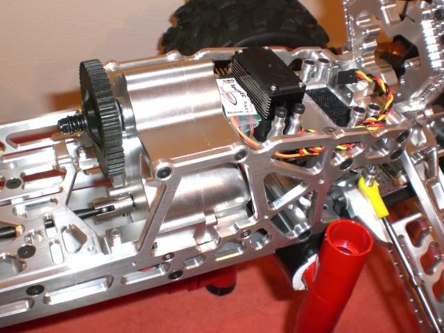

View from the front end of the truck...
http://i211.photobucket.com/albums/b...Mounted/16.jpg
View from the Right side of the truck...
http://i211.photobucket.com/albums/b...Mounted/17.jpg
Birds-eye view - General
http://i211.photobucket.com/albums/b...Mounted/18.jpg
danhfvcsd 11.01.2008 11:16 PM

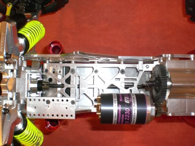

Birds-eye view - Motor/ESC/Battery area...
http://i211.photobucket.com/albums/b...Mounted/19.jpg

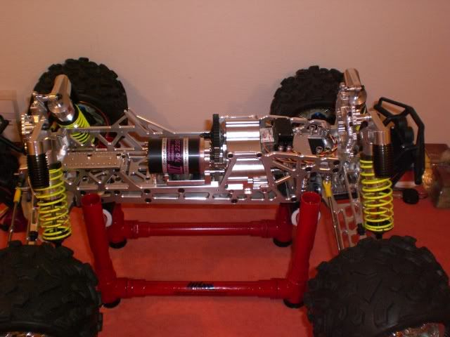

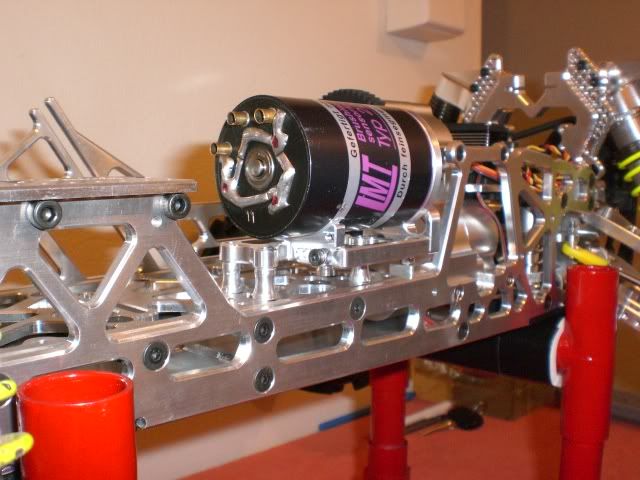

Diagonal/Side - Looking towards the front of the truck... You can see the spacers i have used to raise the motor up a little like a few others users here have done, in order to create a little more room for the batteries... I can't remember, but they're just the spacers included with either the Shock towers (spacers to mount Savage Shocks) or they came with the FLM LST Shock Conversion Kit... pretty sure it's from the shock towers, but i cant be certain...
http://i211.photobucket.com/albums/b...Mounted/20.jpg

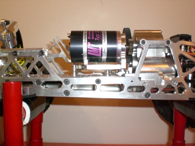

Side view
http://i211.photobucket.com/albums/b...Mounted/21.jpg

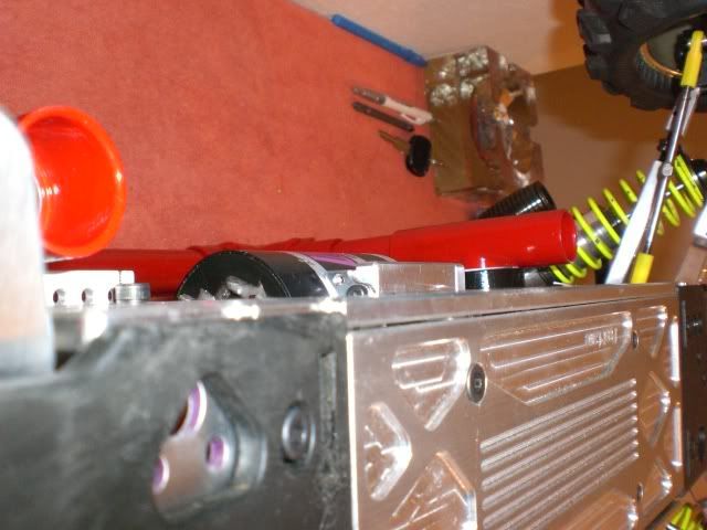

Ants-eye view? Just to show overhang over edge of chassis...
http://i211.photobucket.com/albums/b...Mounted/24.jpg
