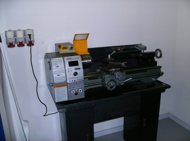

Nice, but you will *most likely* have to also buy their $150 lathe stand.

I have some really sturdy metal tables, that I can use as a stand.

SnoopMaxx 09.24.2008 03:21 PM
Looks a little like the one I have at work
http://i190.photobucket.com/albums/z...x/HPIM1620.jpg
