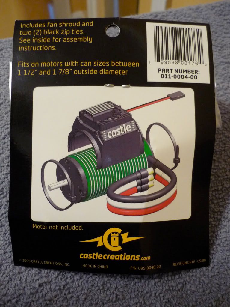

It will fit my Neu 1515 finned motor.It fits 1-1/2" =1.50" =38mm to 1-7/8" =1.87" or 47mm the Neu is 1.73 inches or 44mm.I ordered 1

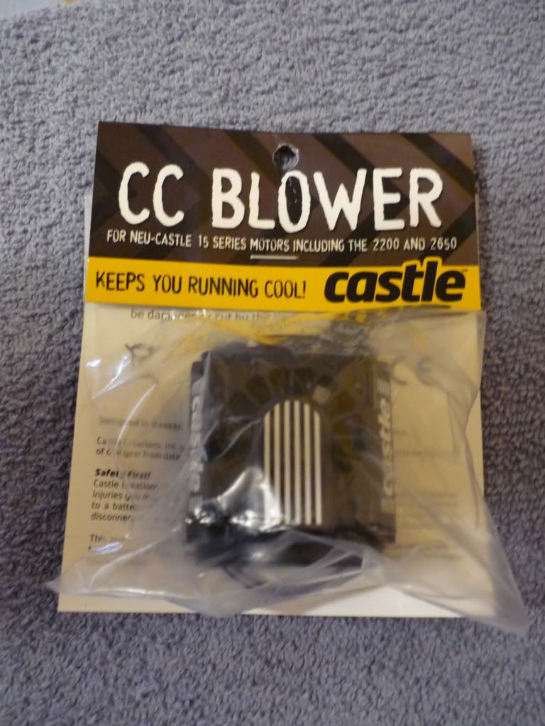

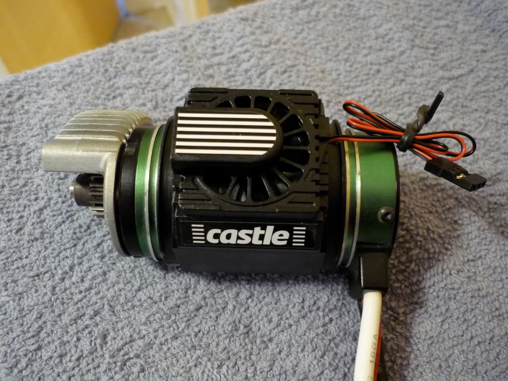

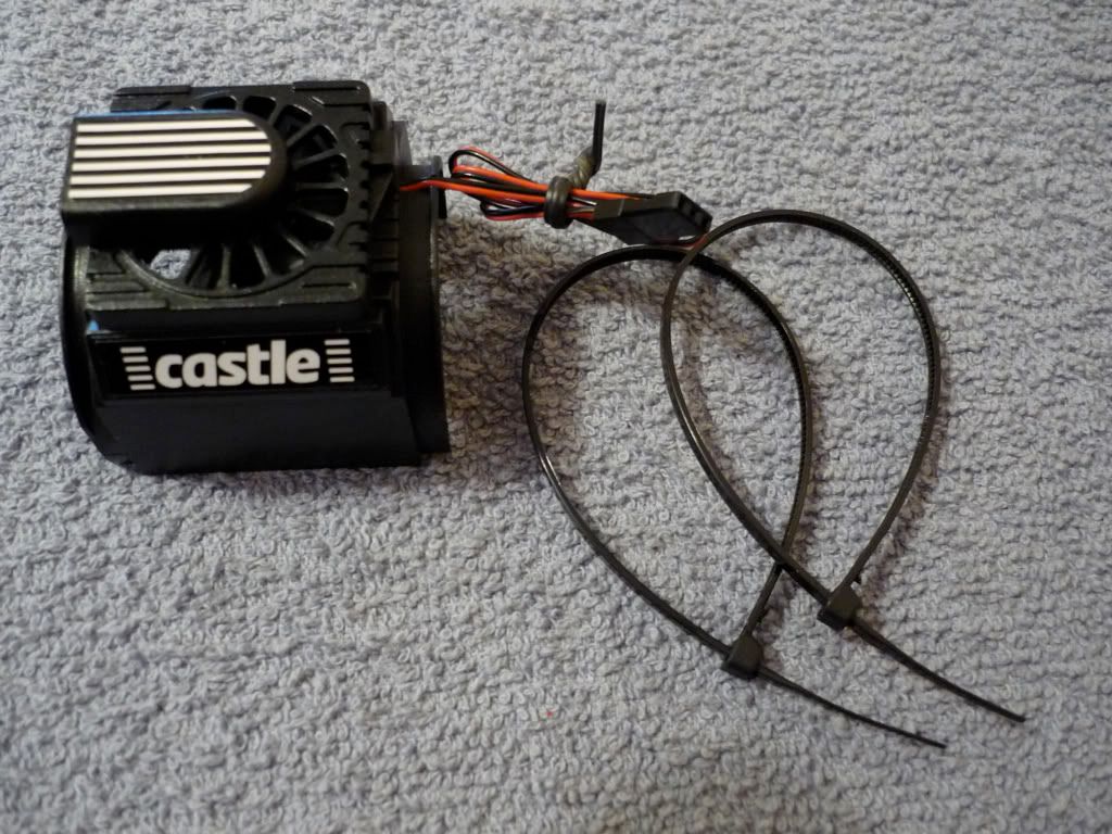

Allright, here is the new CC Blower!

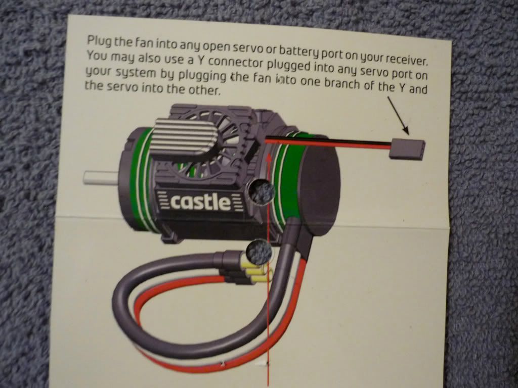

It is made of all plastic (seems pretty sturdy), so it's only a fan and shroud, no heatsink. The plug is a standard servo plug with red/black wires (no signal wire of course). The wire is a bit smaller gauge than standard servo wire, would have been nice to have a little bit thicker wire.
The shroud over the fan seems to have an intake of sorts, almost like the blower on the hood of a hot-rod. The top of the fan is open so I'm not sure how functional this intake will be, but maybe there is a reason Castle put it on there. If you look at the way the plastic case is shaped it almost looks like they were trying to make it look like a V8 engine (could just be my imagination though)

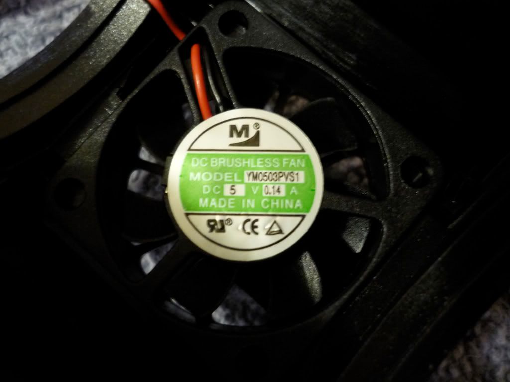

The fan uses a DC brushless motor. It's rated for 5V and will draw 140mA at that voltage. The fan model number is YM0503PVS1. It has a small logo on the label but I'm not familiar with it, maybe someone can make it out in the picture.

the shroud could be made of aluminum so heat would be dissipated better :(
whitrzac 09.24.2009 04:04 PM
that would cost$$$$$$$$$$$$$$$$$$$$$$$$$$$$$$$$$$$$$$$$$$$$$$ $
BrianG 09.24.2009 04:15 PM
lol, it does look like a V engine... one with a HUGE crankcase. :smile:

same fan as the mmm. oh well it will work for a while at least
