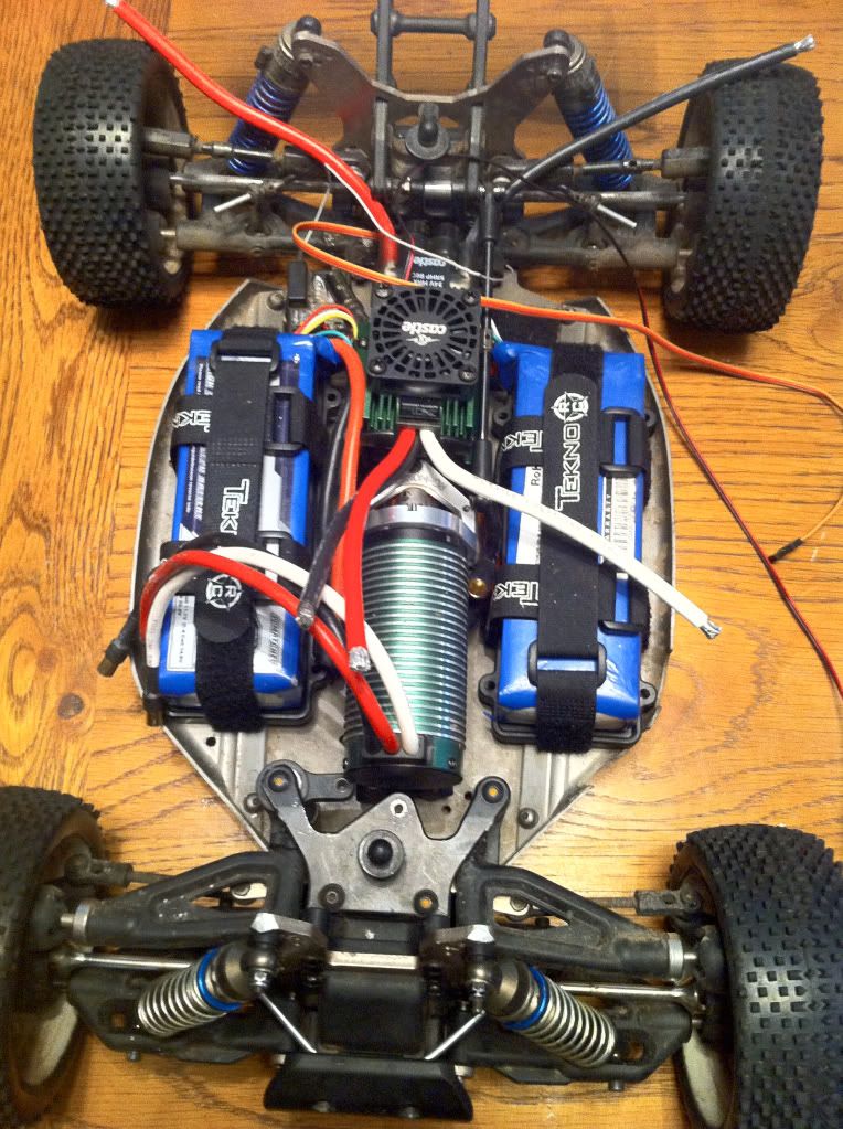

I also received my Mamba XL and have started looking at the new layout. Seems that the rear diff relocation will have to wait until I begin fabbing a new chassis.
[IMG]http://i217.photobucket.com/albums/c...5/8c37954d.jpg[/IMG]
The XL really is extra large...
[IMG]http://i217.photobucket.com/albums/c...5/d8bbdba2.jpg[/IMG]

What's the full RTR weight on that thing?
DrKnow65 01.12.2011 03:00 PM
Dunno exactly, but I believe in it's previous state, with the MMM, it was right at 10.2lbs ready to run. At first I was concerned about the weight, but after running it on even 6S it is in need of all the traction I can muster. With the XL and swapping the motor forward I hope to shift even more mass twards the front end. As it is the front tires barley contact the ground on acceleration, at 8S it will be even more aggressive.
I'll try to run it over to the post office after the XL is in and get the exact weight.

Better start building a stockpile of diff gears and CVDs. Thing looks like it would eat hardened steel and sh*t Integy aluminum LOL!
lincpimp 01.13.2011 12:15 PM
Man, space is a premium on that chassis!!! Where are you going to stick the steering servo? Looking good, what speed do you plan to gear this beast for? 80mph?!?!?!?!
DrKnow65 01.13.2011 12:29 PM
Linc, the steering servo is under the front driveline, the RCM mount sits a little high providing enough space :-) I'd say finding a spot for the servo was the most difficult thing so far.
I'll take a few more pics and a video tonight, it's not actually all that tight in there. I tried to leave plenty of room around the XL and 1518 for air flow, when you look through the front window (cut out) on the body you can see right out the back on either side of the shock tower...
I haven't got into gearing much as I'm going to rely on the data logging and temps for the best ratio. I may be looking into a 1527 1.5d sooner than later to get everything I'm after. Should know after a bunch of test and tune this weekend.

Reno, I know the thread title makes it seem like I don't have an idea of how to accomplish the goal but I am realy more looking to the gents here on the forum to watch my progress and offer helpful advise (like simplechamp suggesting silicone oil vs. The grease I thought would be sufficient). At this point the car is driveable, but no where near complete, so I will still need gobs of advise as it progress'.
I still want to make a custom chassis and shift around the components as the motor and XL are pretty high above COG and it's not as weight forward as I think it may need to be.

I was thinking that another place to mount the servo could be on top of the steering post mount. May not help with mounting a body, but should work.

Not alot of real estate on a buggy chassis, you have a pretty good layout, IMO. I doubt you will be able to re-arrange the components to get any more weight forward.
Having the motor up high does hurt the cg, but if you want to run dual battery trays it is about your only option. If you wanted to stretch the chassis and put both trays in the front and have the motor behind one tray nad the esc behind the other you could get the cg down. But you would have a truggy + long chassis.
Only thing I can see to help front weight bias would be to move the battery trays as far forward as you can, but considering the motor is up front I doubt it will make that much difference.
