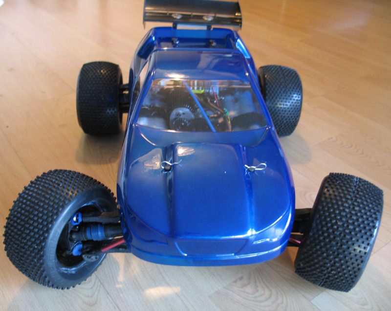

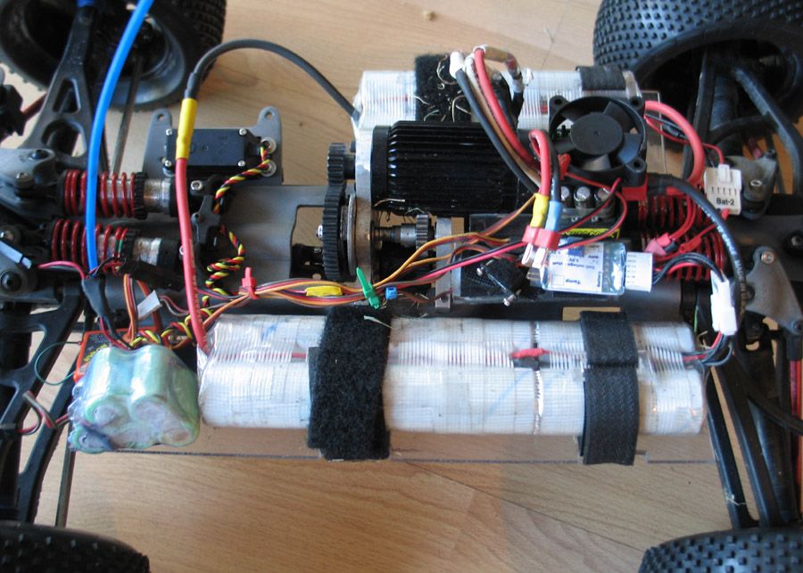

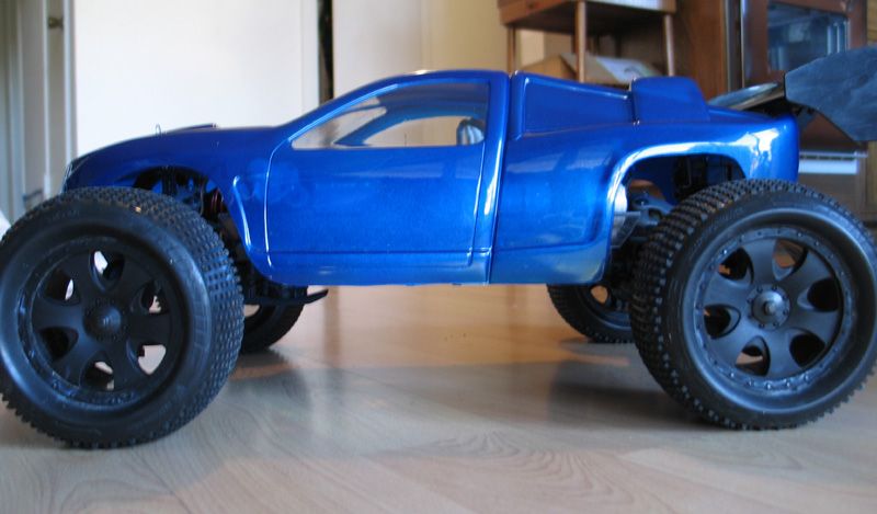

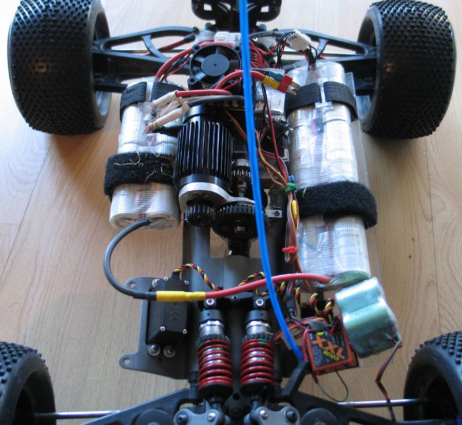

Anyways, here are the long-awaited pics, as well as my freshly painted body (Crowd Pleazer 2.0 for MGT/LST, didn't have one for the Revo 3.3):
http://img.photobucket.com/albums/v1...o/IMG_4932.jpg
http://img.photobucket.com/albums/v1...o/IMG_4937.jpg
http://img.photobucket.com/albums/v1...o/IMG_4938.jpg
http://img.photobucket.com/albums/v1...o/IMG_4940.jpg
http://img.photobucket.com/albums/v1...o/IMG_4944.jpg
http://img.photobucket.com/albums/v1...o/IMG_4945.jpg
http://img.photobucket.com/albums/v1...o/IMG_4947.jpg
http://img.photobucket.com/albums/v1...o/IMG_4948.jpg
Sylvester 01.15.2007 07:33 PM
Looks good MM!
That body looks BIG on that revo ; where are the stickers at? ;)
BrianG 01.15.2007 09:17 PM
Nice!
BTW: One of your pillow ball boots is torn...
