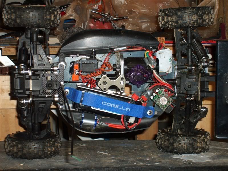

B15 11.06.2007 09:37 PM
The Power Racing parts fit, for the most part.
http://i65.photobucket.com/albums/h2...s/S5000357.jpg
The carbon front upper brace fits fine, as do the lower arm mounts. The upper arm mount fits, but I had to mount it on the underside of the front brace, the opposite of the stock location. It also doesnt match the picture on their website, so I think they might have sent the wrong one. The front brace tie rod isnt what I had hoped for, its meant to brace the front upper brace to the chassis plate. I will have to move things around if I decide to use that.
I also finished the cooling setup on my mm.
http://i65.photobucket.com/albums/h2...s/S5000360.jpg
Since I took these pictures, Ive flipped the servo and saver arm over to the inside to make room for a future second battery on that side. Maybe 6s on a MMM. Id like to do 8s and buy a neu 1515 2y and an MGM 9032, but thats too much money for me.
