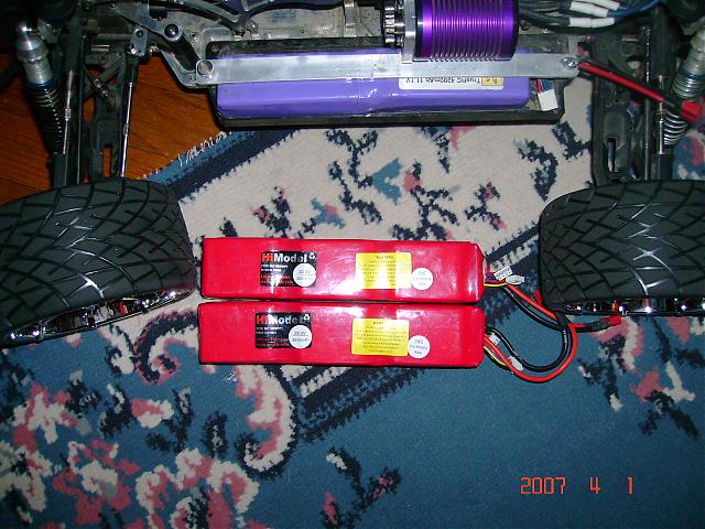

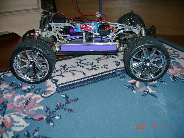

You can try and see if 12S 2200mAh (4 x 6S 2200mAh) in a long style pack will do. The pack inside my truck in the pictures show how a 4400mAh 3S2P long pack looks like. That pack can be 6S1P for 22volts. Some places has good 25C and 30C 2200-2600mAh 6S packs. Thunder Power has the following: TP2600-6SXV, 22.2V, 6-Cell, 410g, 44x39x125 and $179.99 or TP2200-6SXV, 22.2V, 6-Cell, 340g, 51x33x107 and $149.99. You can also use the long type higher mAh packs like the following: http://www.kongpower.com/product_en/...pkind_recno=KP or http://www.airthunder.com/5000mah222...erypack-2.aspx. I know Flight power makes the long type packs as well. With the higher mAh pack all you do is put one on each side of the chassis and make a plug to hook up both controllers to them. The only weak link now will be the moving parts.
