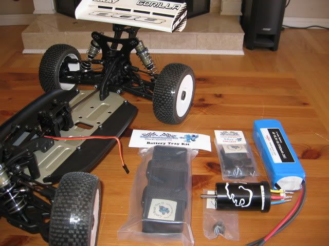

TDC57 06.01.2008 02:15 AM
Good morning team,

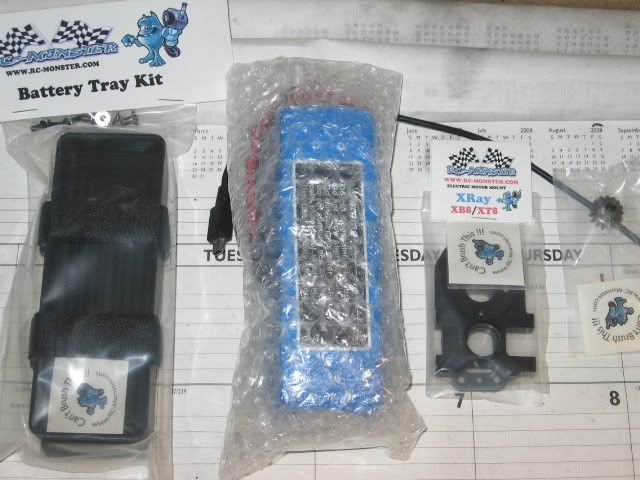

I just thought I would share with you some updates on my buggy. The Monster came through and got me all of my parts today and with the kid’s in bed and Pink Floyd playing in the background I decided to make some forward progress.

Builders side note:
As once stated by Backfire and I quote him “the diff height in the RCM mount is designed to work with the tall center bulkhead of the XB8EC and XT8. The 808 uses a much shorter mount. I couldn't find my spare center bulkhead, so I just used some of the 1mm bulkhead shims from XRAY(#354032) to raise the height even. In fact, I always have used one set of these shims under both bulkhead pieces to raise the motor slightly off the chassis”.
Truer words where never spoken.. Thank you Backfire for warning us that would happen, it did and I was fully prepared for it.
Now I just need to receive my MGM controller I bought off a fellow member to show up and install the radio and she’ll be ready for a test run??... Well I also need to get my body back from the painters but that not another 10 days.. (bbboooo),,
Thanks for your time and have a great one team!!..

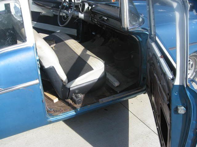

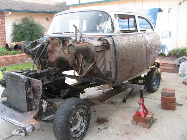

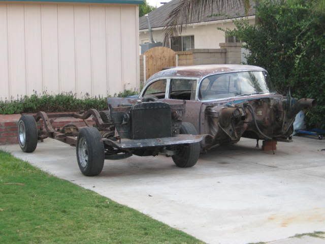

Thanks for the kind words it’s been a great build, as for a bigger and more challenging builds, well I’ve got that as well going on. I'm performing a complete ground-up restoration on a 57 Chevy as we speak.
http://i264.photobucket.com/albums/i...05-5-07009.jpg
http://i264.photobucket.com/albums/i...05-5-07018.jpg
http://i264.photobucket.com/albums/i...9-18-07009.jpg
http://i264.photobucket.com/albums/i...9-18-07020.jpg
http://i264.photobucket.com/albums/i...9-18-07026.jpg
Of course it will require a little longer to complete then any of my RC builds, but she’ll be worth it in the long run..

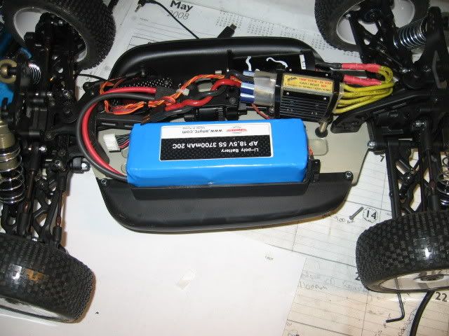

Buggy updates!.
Good morning team,
Thank you all for your above comments!!.. I really appreciate the feedback..
Here are some updates is should have included in the last one. Sorry me bad..

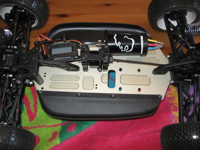

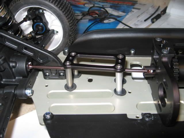

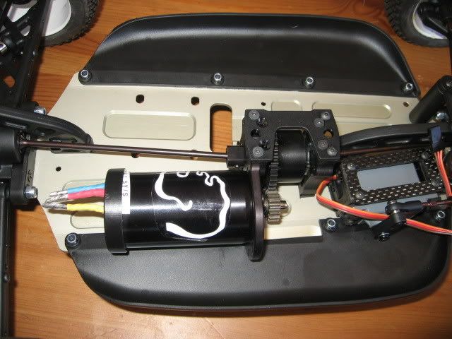

I thought I would take a second out and share with you the three modifications to date that I’ve had to perform in order to switch this Nitro burring, gas spewing, ozone depleting, garage smelling bad boy!. Into the environmentally friendly, local park driving, neighbor liking (E) buggy that kind of (hhaa haa) stand here today!..

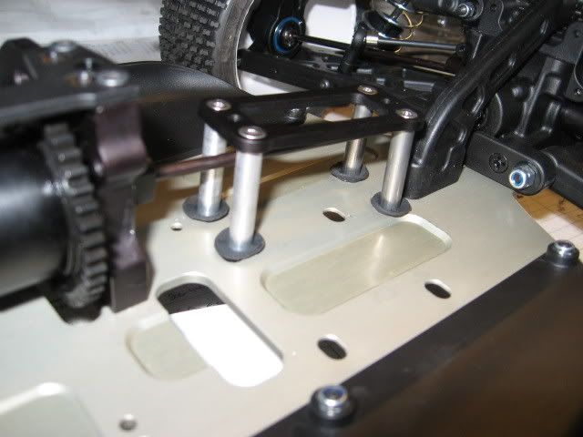

The first modification required in order the fix the height deficiencies when installing a RCM engine mount. This modification was needed to increase the front side height of the canter diff. I ended up cutting a piece of carbon Fiber and drilled two holes on it to match up with the existing center shaft tower mounting holes.
http://i264.photobucket.com/albums/i...7/IMG_2948.jpg

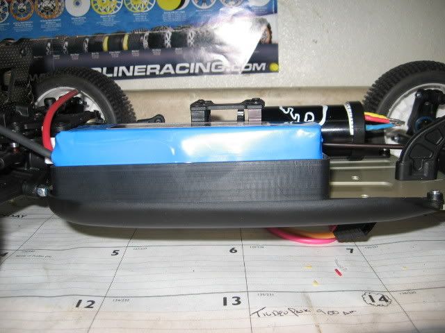

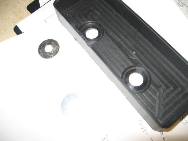

The second modification was to the battery tray.
I used a ½ forstner bit and drilled down just until the bit penetrated the base holder, this allowed me to countersink the existing body screws into the holder and use a longer bolt with a counter sink ¾ washer on the top allowed me to secure the battery holder to the chassis. I also noticed that I could take the battery try and use my belt sander to takeoff another 2mm getting me to 39mm in deck height. I'm just not sure what the stock deck height number is?? Do you know??.
http://i264.photobucket.com/albums/i...7/IMG_2947.jpg
http://i264.photobucket.com/albums/i...7/IMG_2960.jpg

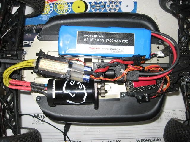

Once I mount my ESC and receive my body back I’ll be able to fine tune the battery try holder for maximum wait distribution. At its current location with a 5s 3700mAH on board it sits exactly 40.97mm (41mm) above the bottom of the chassis.
http://i264.photobucket.com/albums/i...7/IMG_2950.jpg

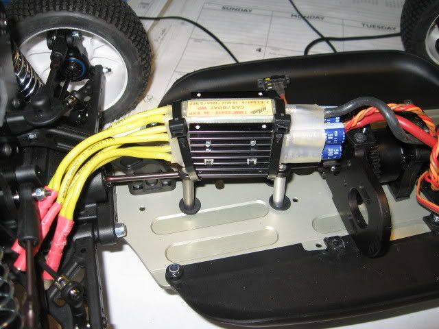

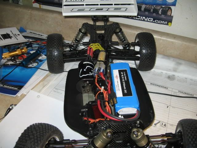

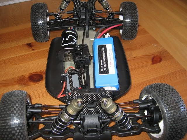

The third and final modification was to accommodate the ESC, after reviewing several other member threads and trying different locations / placements it was decided that it really needed to be mounted in the center rear for (Ease of acess, clean wire runs and CG) but I need to lift it off the chassis and mount it over the rear drive shaft.. after several deep thoughts and a glass or two (hmmmm) I used the alum servo holder that I had and used (4) of the ½ double threaded spacers that come in the GorillaMaxx kits allowed me to screw it from the bottom and top and made a simple secure stand, I also used (4) rubber washers at the bottom of the stand over the chassis to help cushion the blow for my ESC.
http://i264.photobucket.com/albums/i...7/IMG_2955.jpg
http://i264.photobucket.com/albums/i...7/IMG_2956.jpg
http://i264.photobucket.com/albums/i...7/IMG_2957.jpg

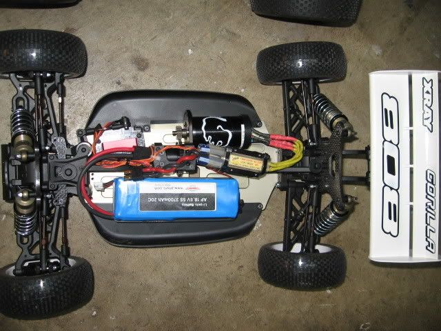

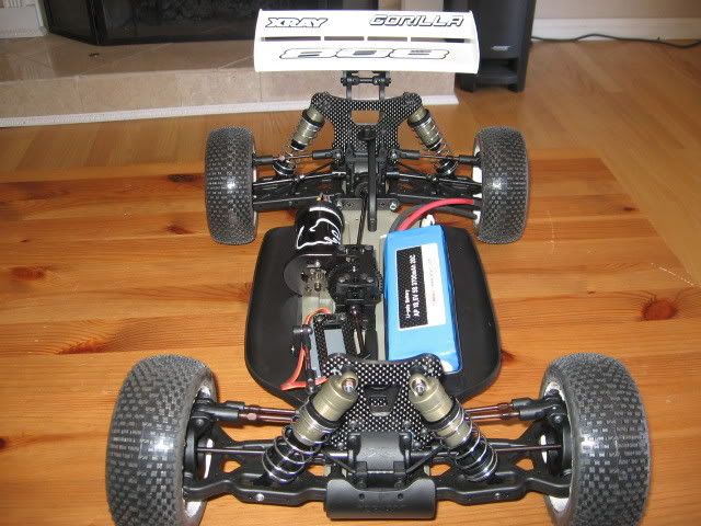

Here are a few more shoots of it almost completion, I need to install my RX box, antenna and install the Velcro battery straps. She’ll be running this weekend!!
http://i264.photobucket.com/albums/i...7/IMG_2961.jpg
http://i264.photobucket.com/albums/i...7/IMG_2962.jpg
http://i264.photobucket.com/albums/i...7/IMG_2963.jpg
http://i264.photobucket.com/albums/i...7/IMG_2964.jpg
Well thanks again for your time in reviewing and for leaving your comments.. Have a great one Team..
