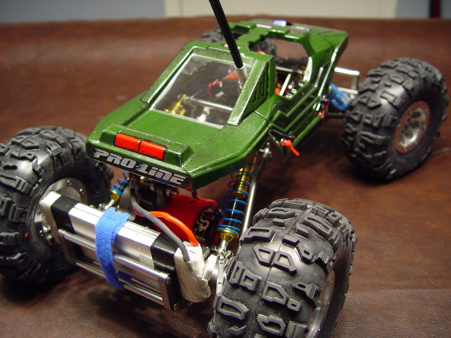

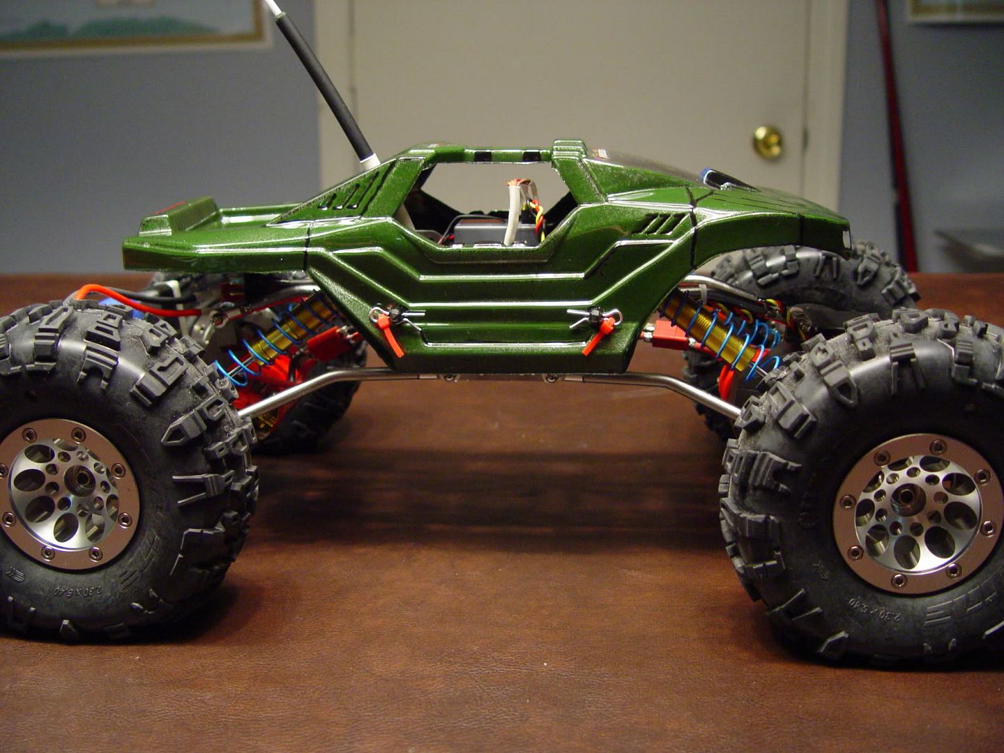

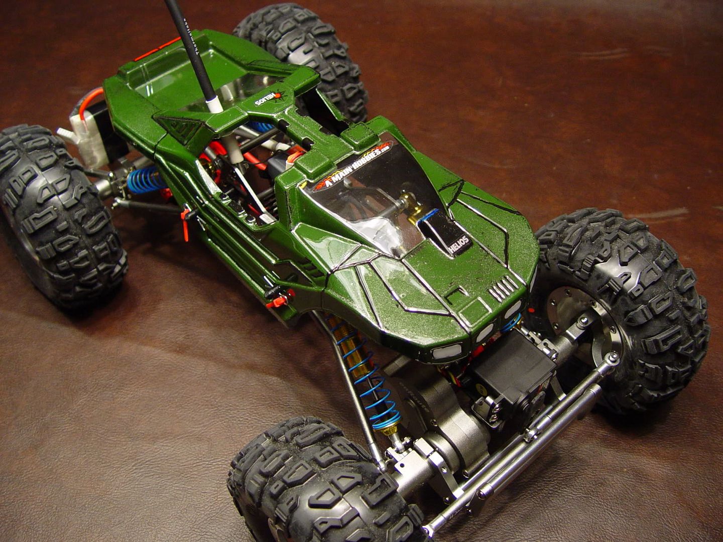

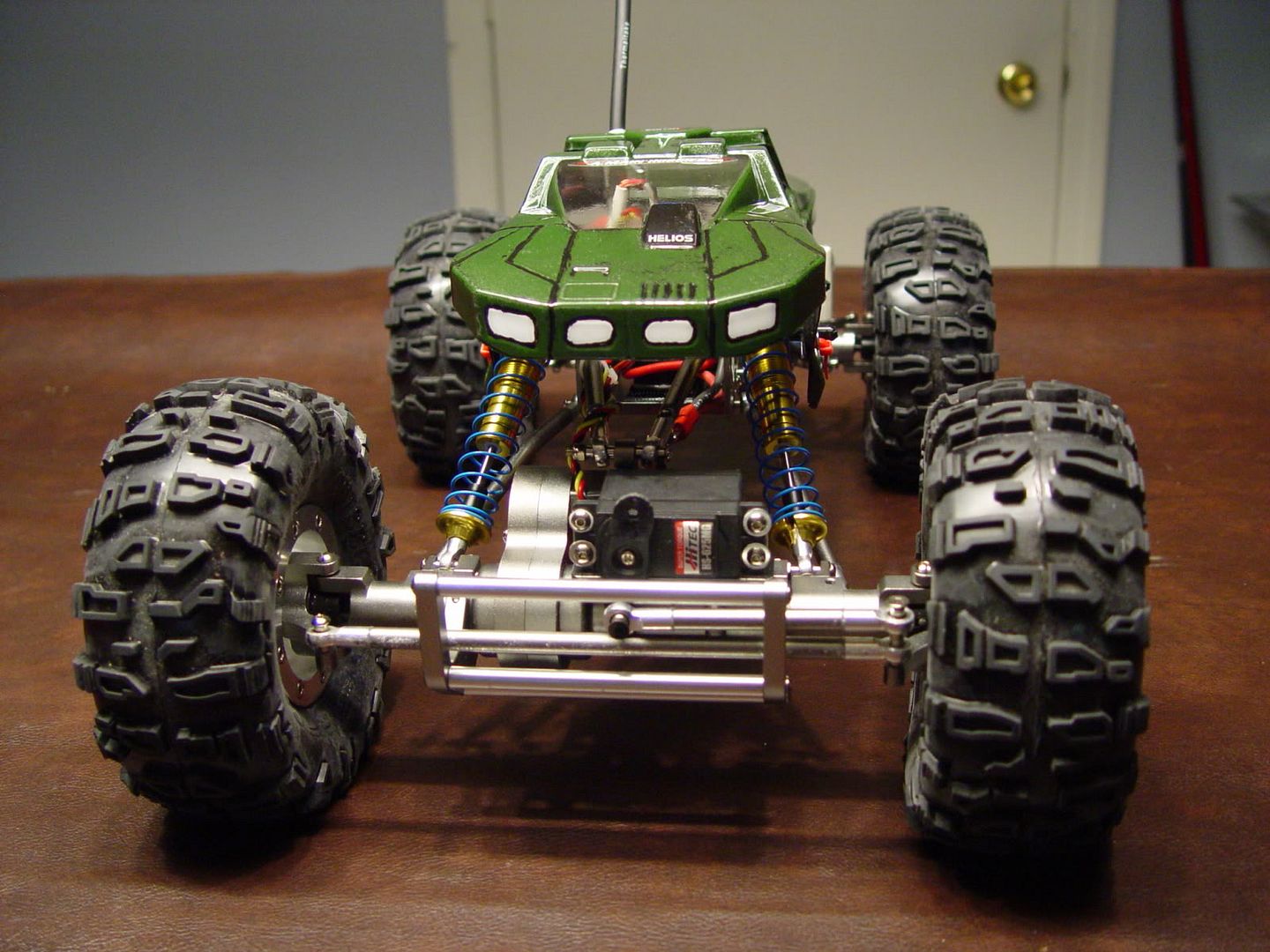

http://i52.photobucket.com/albums/g4...h_DSC00379.jpg http://i52.photobucket.com/albums/g4...h_DSC00374.jpg http://i52.photobucket.com/albums/g4...h_DSC00373.jpg http://i52.photobucket.com/albums/g4...h_DSC00370.jpg
I got the G8 Chisels mounted up. They are VERY soft, especially with the memory foams. I painted the body (DUH). I'm pleased with the results, though if I had a better detail brush (than the cheap plastic one in the testors sample pack), the lines would be straight... :smile: I plan on installing LEDs in all of the appropriate places- and maybe some inappropriate ones. I hope somebody reads this!
