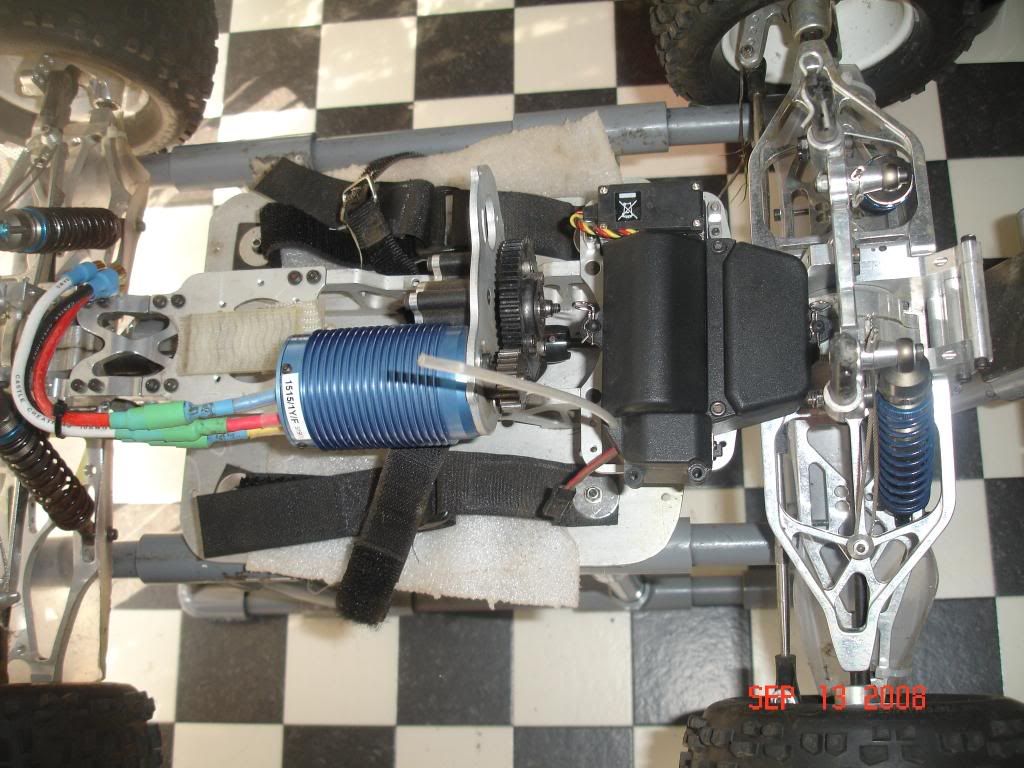

I installed a Mugen radio box to house the rx and 6V 2500 mah NiMH batteries which I'll be using in preparation for the new ESC I bought from Lutach. The box itself is held in place on the chassis by 2 screws.
http://i256.photobucket.com/albums/h...Picture128.jpg

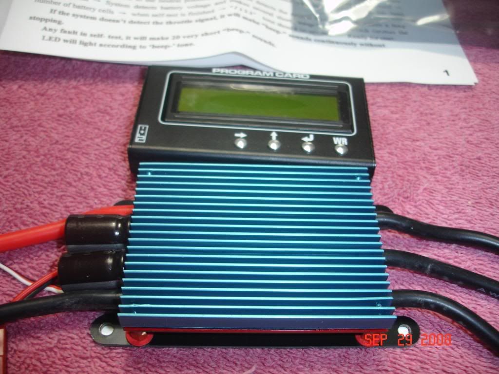

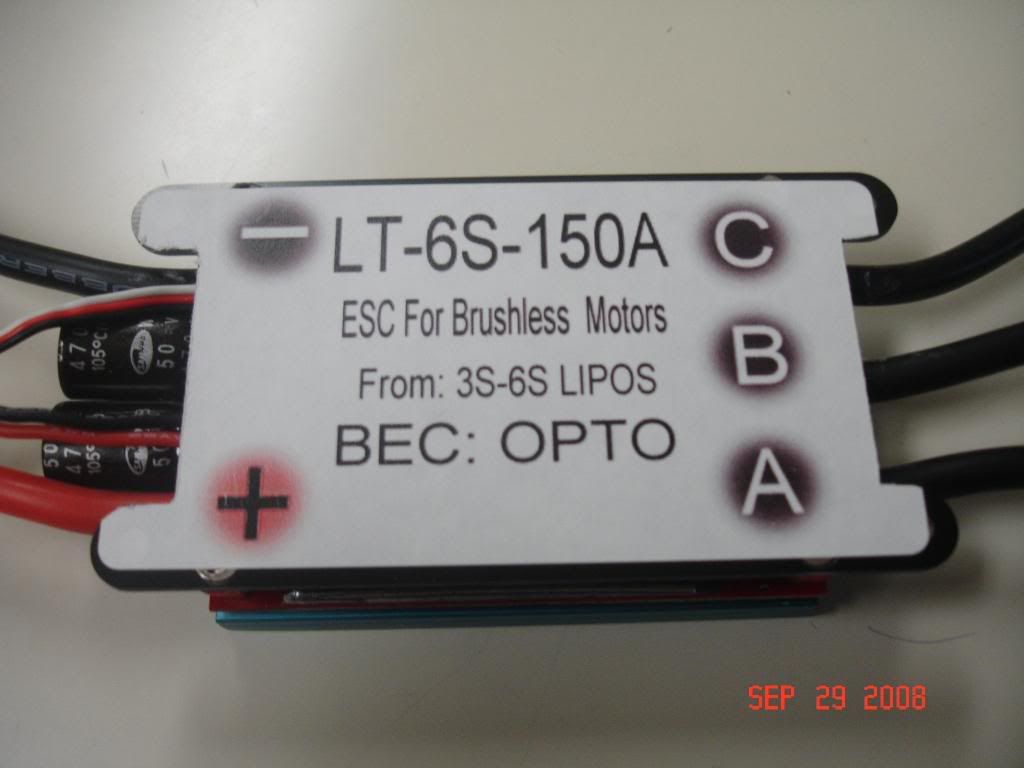

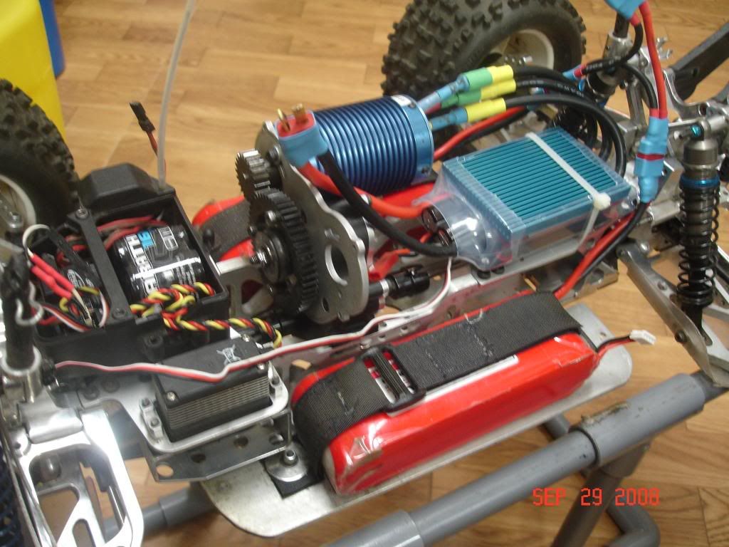

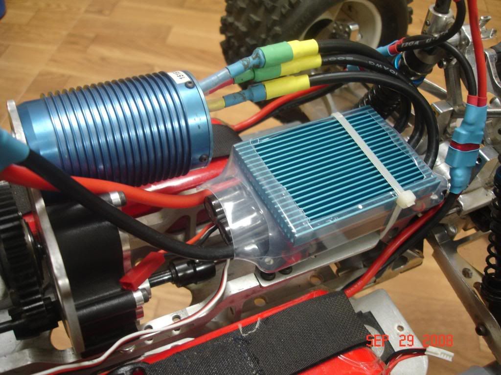

Anyway, I received the ESC from Luciano(Lutach) this afternoon. I finished the installation and setup but can't do an all out test run because of continuous rain. Hopefully it will clear out tomorrow.

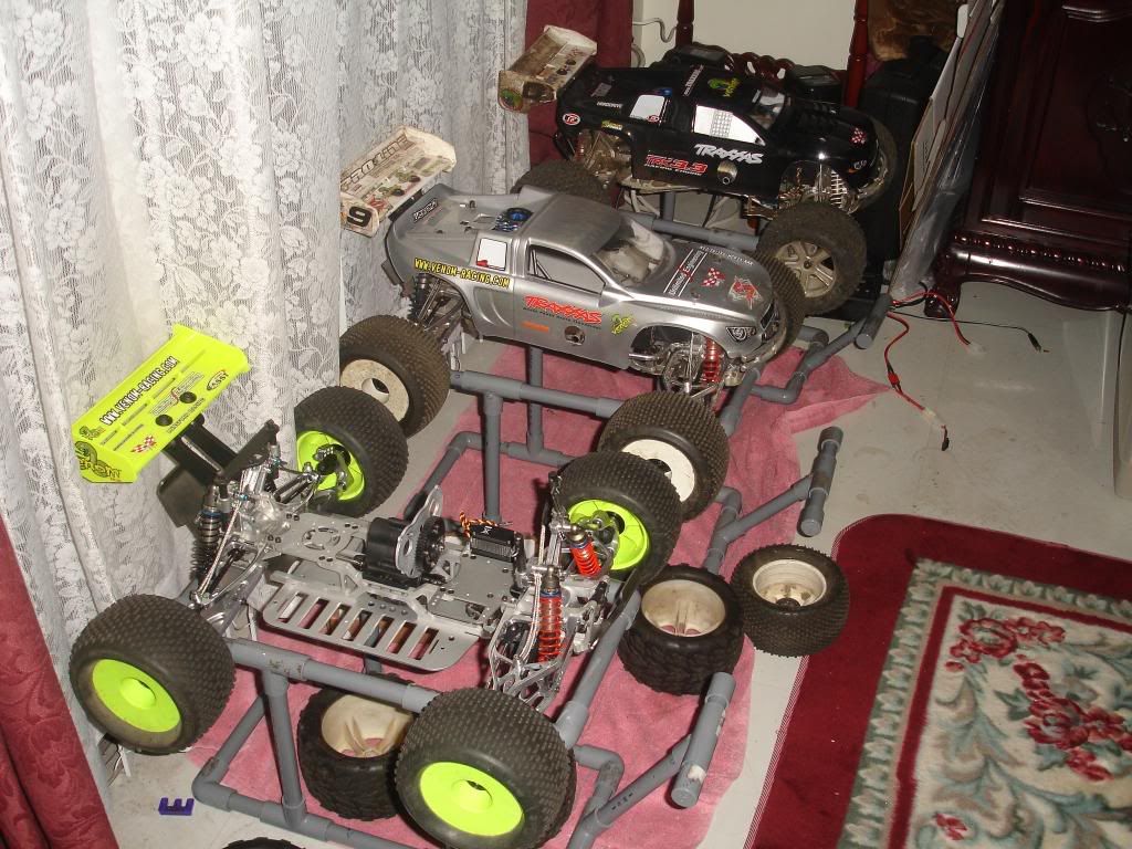

My test truck:
http://i256.photobucket.com/albums/h...Picture143.jpg
http://i256.photobucket.com/albums/h...Picture142.jpg
My daughter doing an inspection of the truck :yes:
http://i256.photobucket.com/albums/h...Picture139.jpg

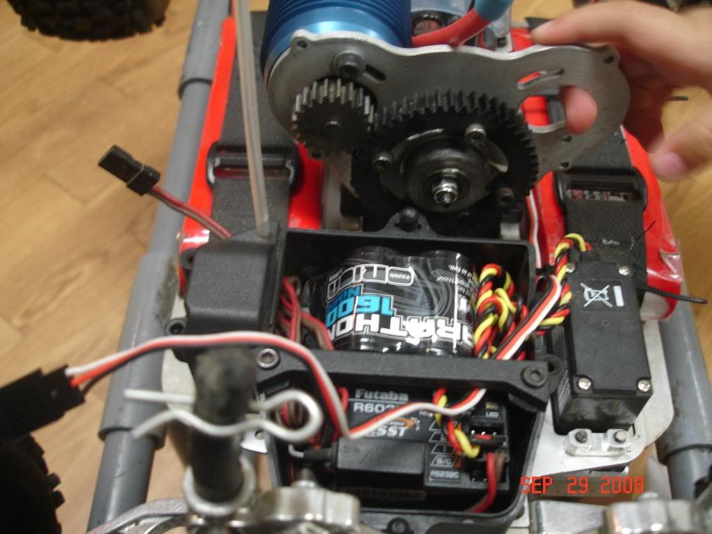

Mugen radio box containing the rx pack and Futaba rx:
http://i256.photobucket.com/albums/h...Picture145.jpg

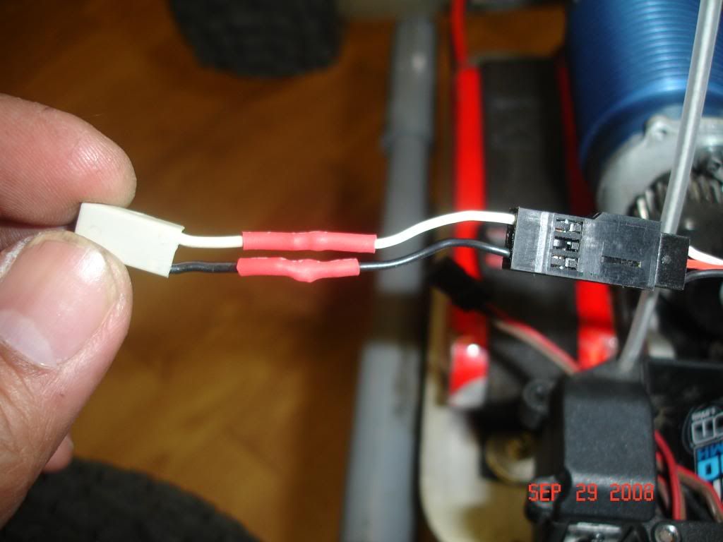

The adapter I made so I can still program the ESC with the wire and program card.
http://i256.photobucket.com/albums/h...Picture144.jpg
http://i256.photobucket.com/albums/h...Picture132.jpg
http://i256.photobucket.com/albums/h...Picture134.jpg

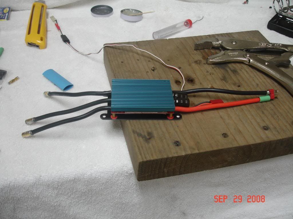

Soldering 6.5mm bullets and dean's:
http://i256.photobucket.com/albums/h...Picture136.jpg
