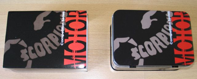

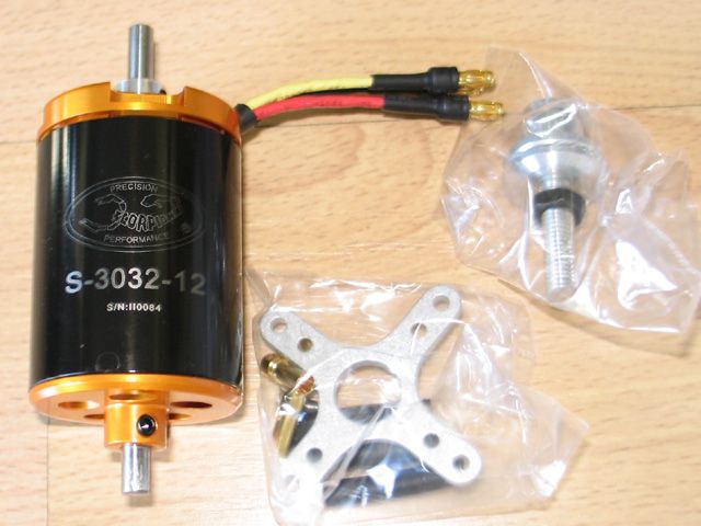

Something nice came in the mail yesterday!
http://img.photobucket.com/albums/v1...k/IMG_7979.jpg
http://img.photobucket.com/albums/v1...k/IMG_7983.jpg
http://img.photobucket.com/albums/v1...k/IMG_7988.jpg
http://img.photobucket.com/albums/v1...k/IMG_7990.jpg
http://img.photobucket.com/albums/v1...k/IMG_7993.jpg

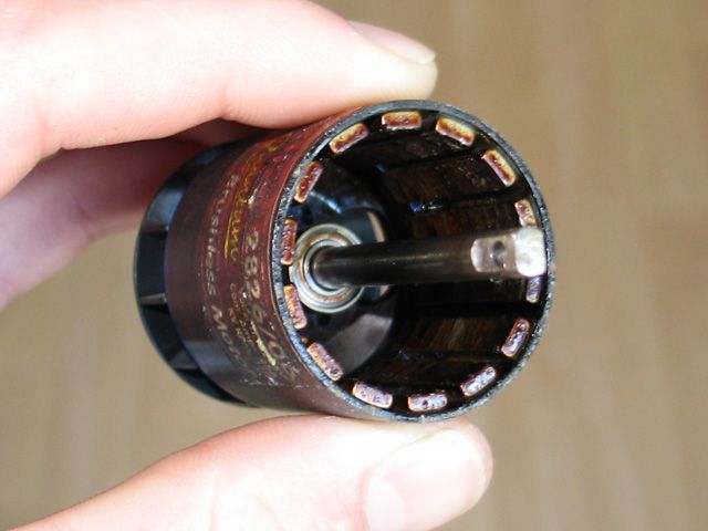

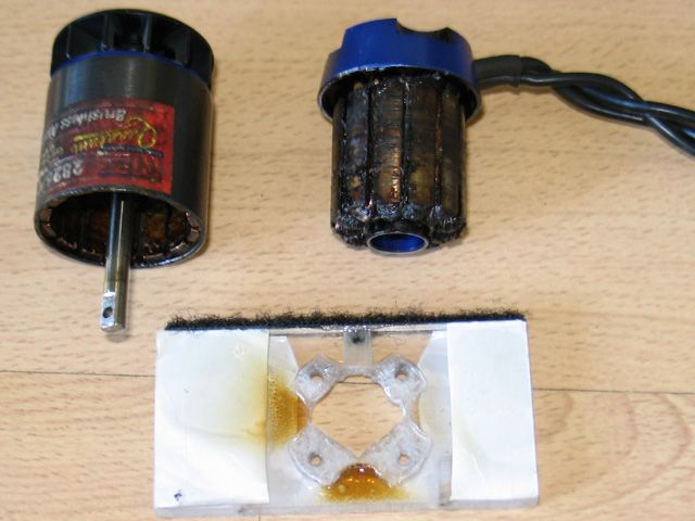

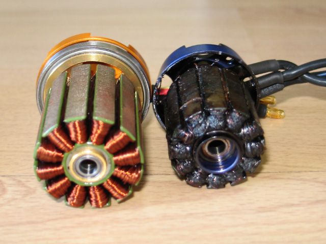

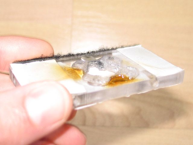

And here is the carnage from the KMS:
http://img.photobucket.com/albums/v1...k/IMG_7995.jpg
http://img.photobucket.com/albums/v1...k/IMG_8000.jpg
http://img.photobucket.com/albums/v1...k/IMG_8001.jpg

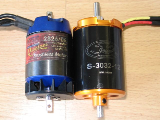

And some comparisons:

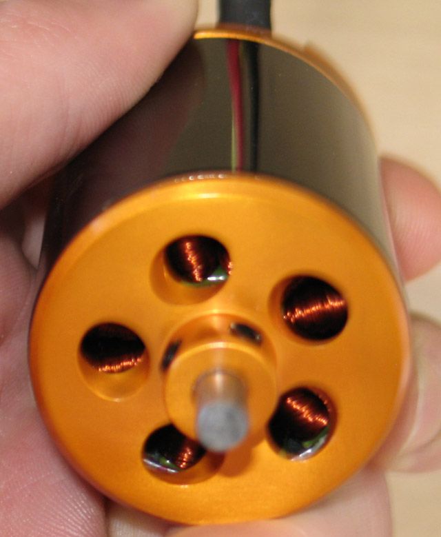

http://img.photobucket.com/albums/v1...k/IMG_8006.jpg
http://img.photobucket.com/albums/v1...k/IMG_8014.jpg

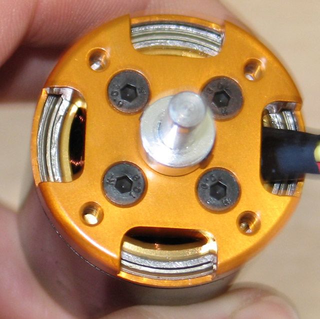

On that last picture, note the large silver ring at the "business" end of the Scorpion motor. That's a ball bearing! It sits inside the spinning part of the motor and provides extra support.
