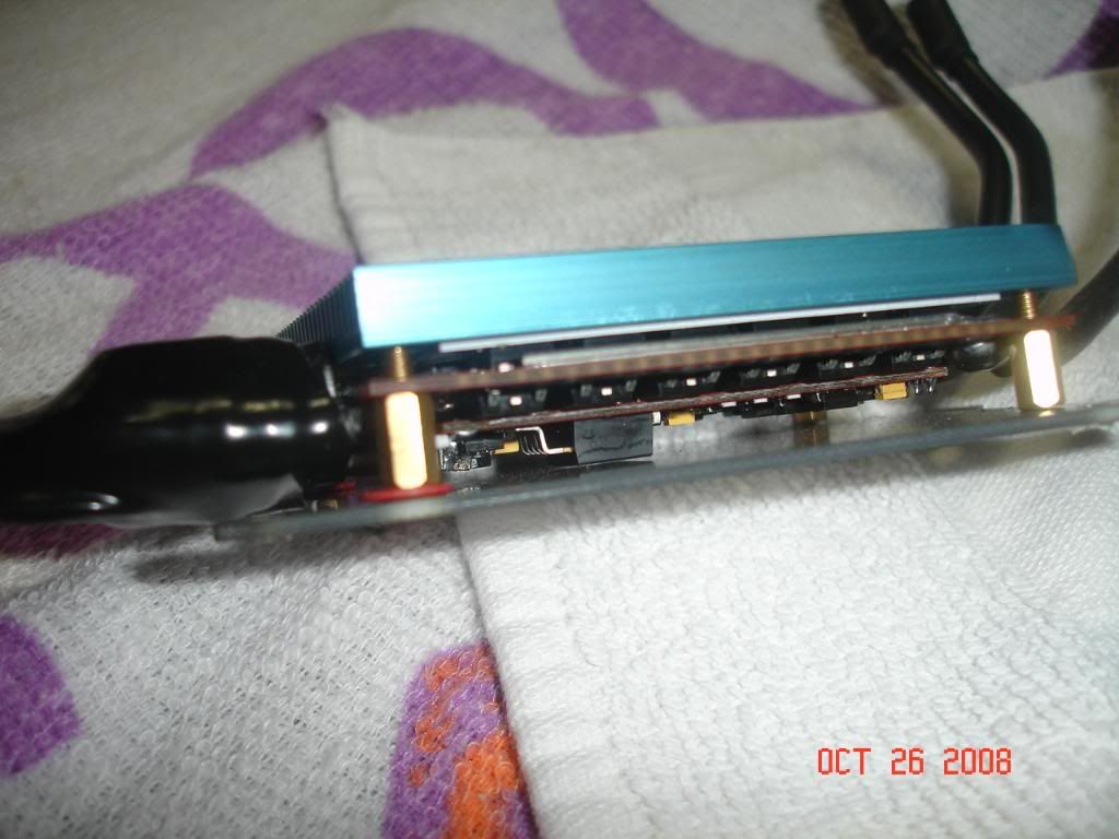

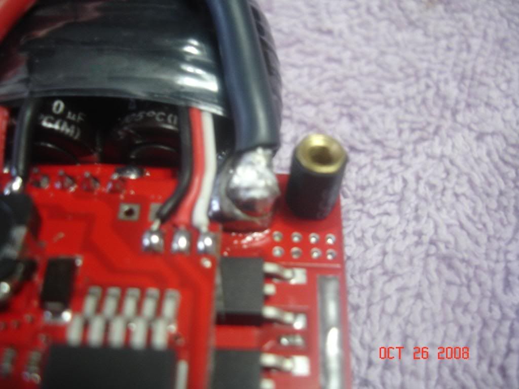

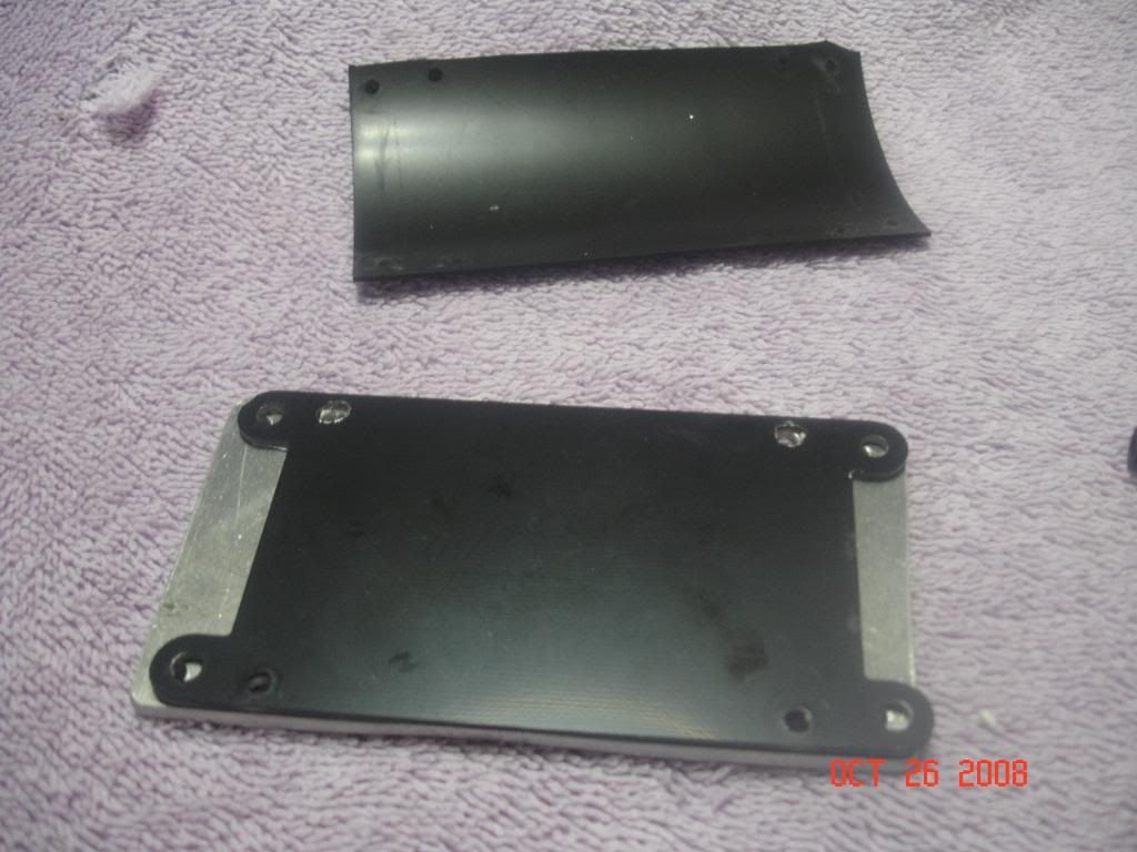

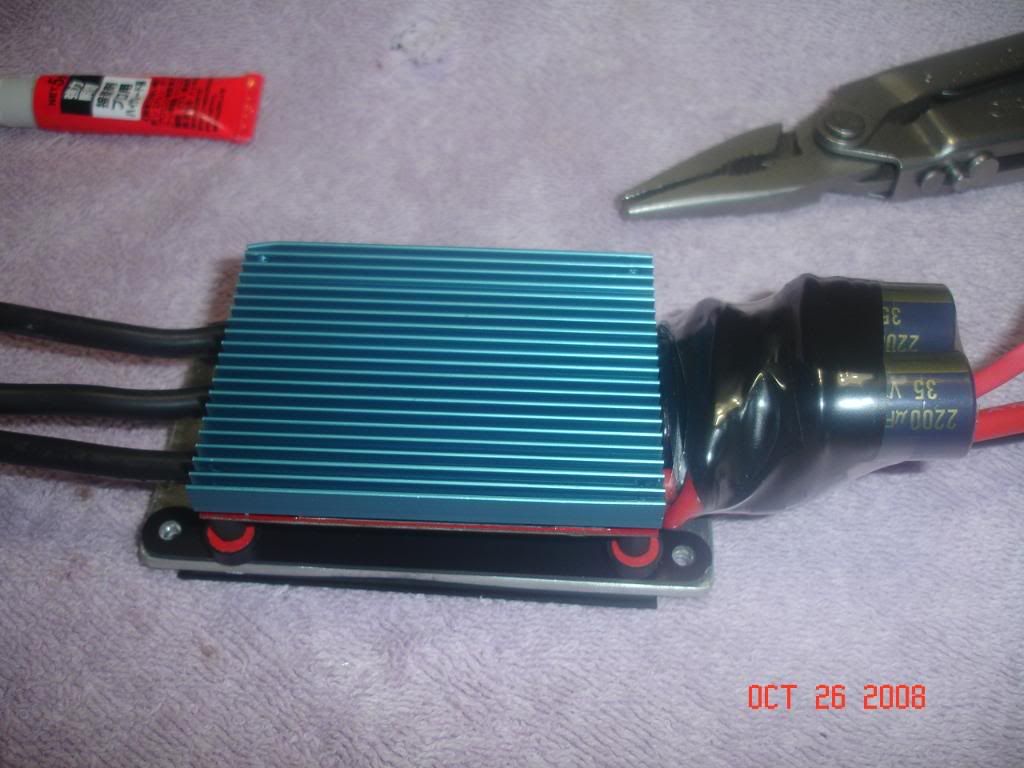

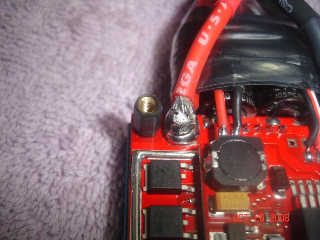

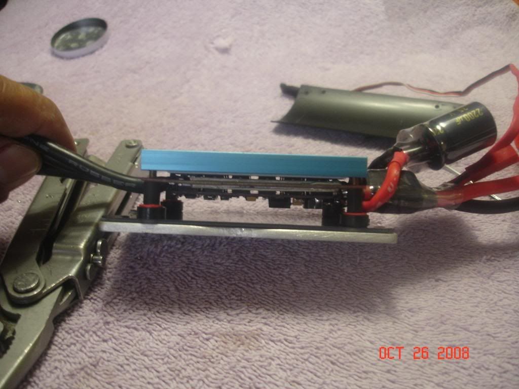

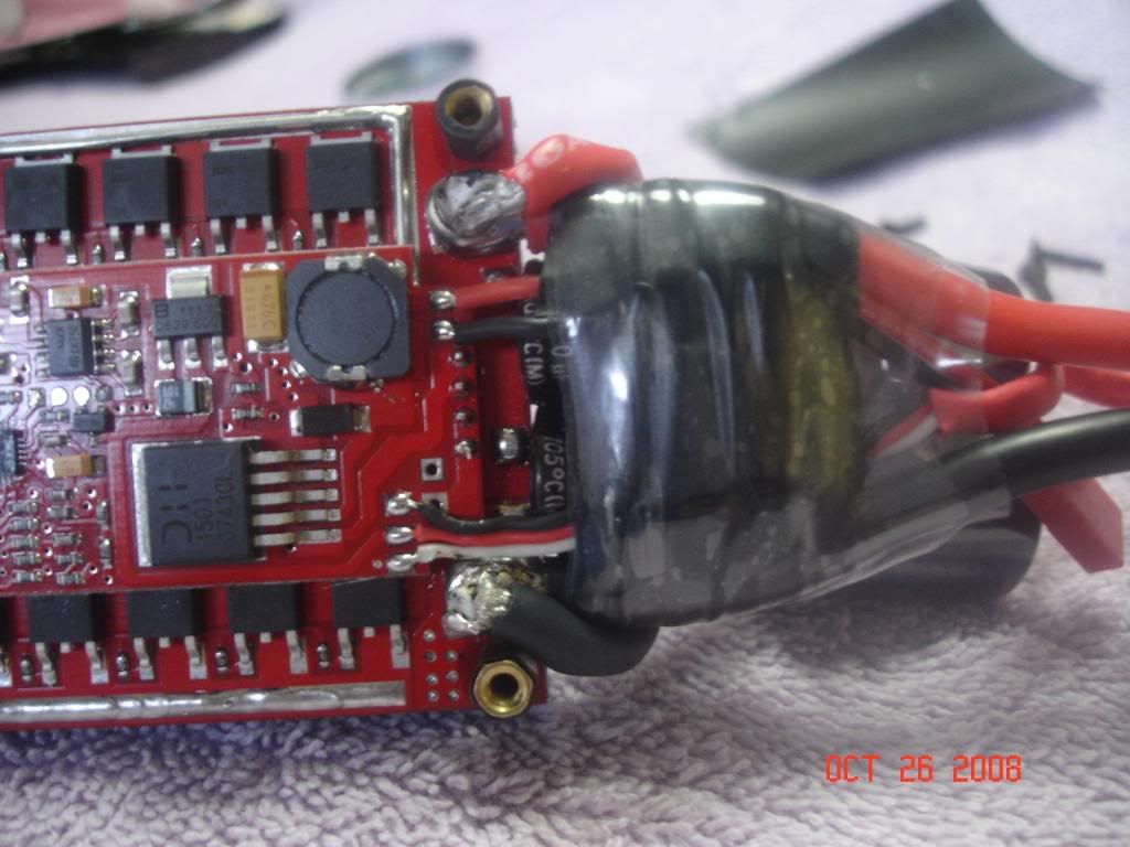

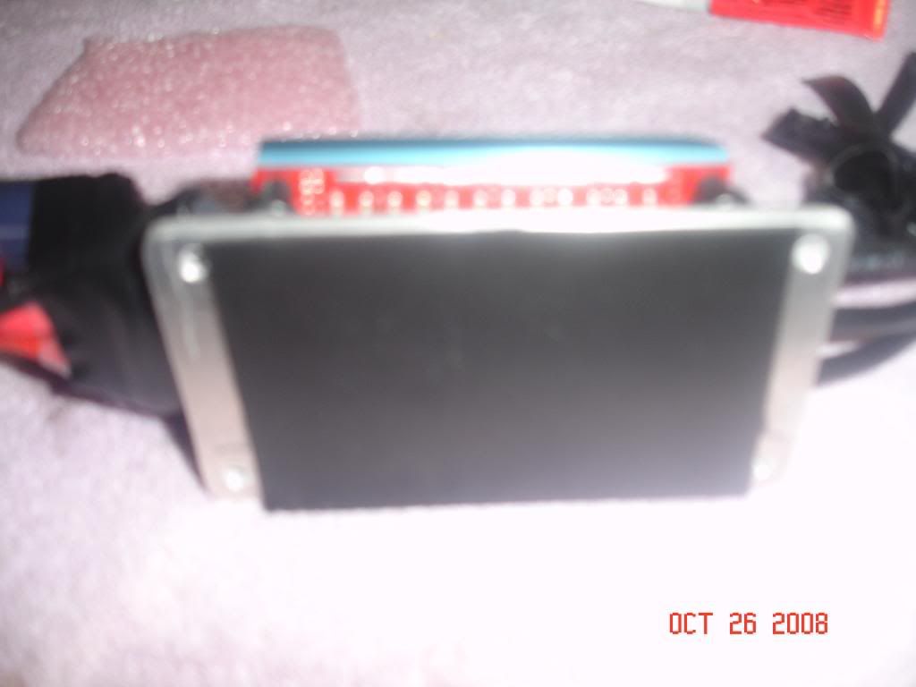

Here are some pictures of the 3mm aluminum plate I cut and installed on the bottom of the ESC. I also added the 2200 caps killajb gave me. Performance wise, I got the ESC temps to 150*F, motor at 112*F, and batteries 98*F yesterday. This was stop and go running on asphalt. I also experienced hesitation when I tried to run wot. Batteries are Neuenergy 25C 5000mah.
Anyway, here are some pictures:
http://i256.photobucket.com/albums/h...Picture171.jpg
Also glued a piece of rubber underneath the aluminum plate.
http://i256.photobucket.com/albums/h...Picture184.jpg

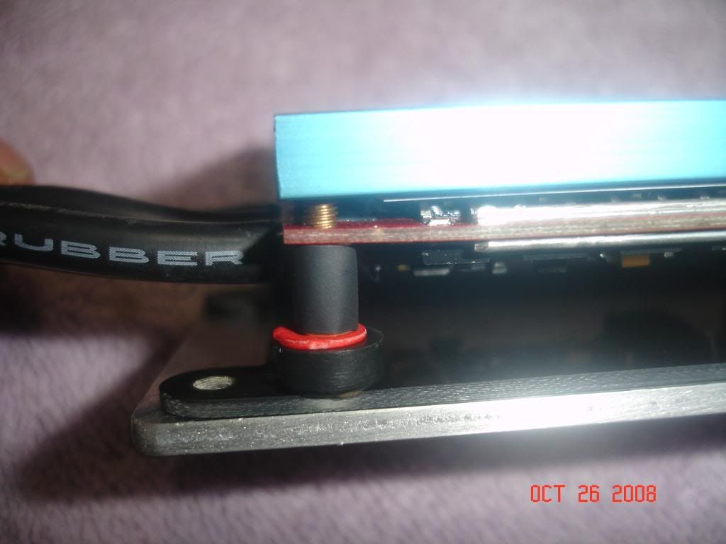

Added caps on the power wire. I also shrink-wrapped the standoffs.
http://i256.photobucket.com/albums/h...Picture173.jpg
http://i256.photobucket.com/albums/h...Picture172.jpg
http://i256.photobucket.com/albums/h...Picture175.jpg
http://i256.photobucket.com/albums/h...Picture183.jpg
I also installed some plastic spacers to clear the capacitor wires. The spacers widened the gap between the board and mounting plate. Better airflow for better cooling. The gap is about 3/8".
http://i256.photobucket.com/albums/h...Picture174.jpg
http://i256.photobucket.com/albums/h...Picture170.jpg
Gap before I installed the plastic spacers.
http://i256.photobucket.com/albums/h...Picture169.jpg
