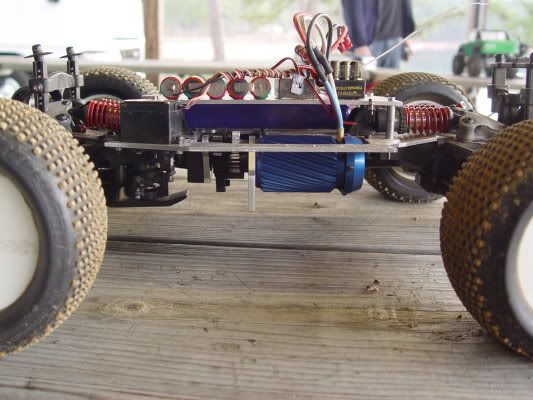

if the pletty fits, anything fits. There is a ton of room left even with the pletty, its an optical illusion..the pic makes it look that way.

I have a question, the more I look at the chassis the more I doubt that feigao/wanderer (not 540c) and Neu's will not fit. The reason is that the motor wires come right out the back of the motor and the chassis is right there and looks like it might hit them. I am sure the feigao 540c's will fit. Am I wrong?....
Look at the pic:

emaxxjeremy 01.18.2007 11:09 PM
with rear exit motor wires, the motor could be rotated to clear the chassis. the pletty is much larger than the average motor in length and diameter, so the wires could be snuck next to the motor

Oh and as Jeremy pointed out, if the bigmaximum will fit, anything will fit with a ton of room to spare.
the XL Feigao is 74mm long and 35mm wide, the Big max is 80mm long and 43mm wide. This is a waaay bigger motor.

I dont know, but it looks as if the 1950 for instance will have an issue getting the wires up on the chassis since the wires are horizontal.
Bomb-Proof 01.19.2007 04:17 PM
as long as the motor can be rotated, and the wires arent solid steel coming out of the center of the motor, shouldnt be a problem.
