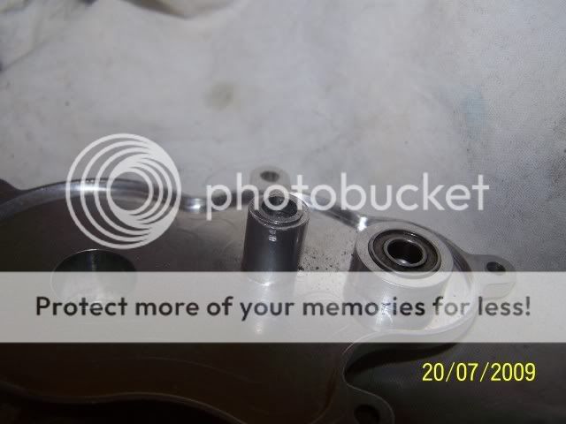

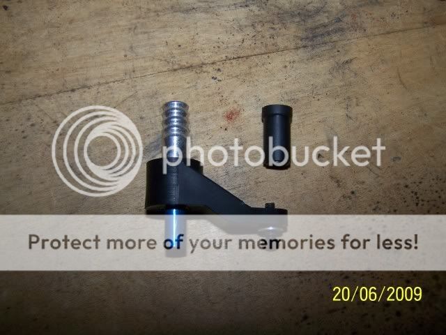

Kcaz25 07.20.2009 11:07 PM
Originally Posted by Chadworkz (Post 305053)
Good deal, man...glad you got everything working smoothly. Can you take pics of what you did? I will be needing to do this very soon, so I would like to see exactly where/what I need to do...thanks in advance!
Okay so check it: After further investigation I found it was still far too binding.
http://i420.photobucket.com/albums/p...a/100_1003.jpg
Can you see right where the camera is focusing? At the end of the idler gear shaft carrier their is a ring that sticks out to catch the inner part of the ilder gear bearing, yeah well that must be cut down some... just go by feel I suppose but the amount I grinded down here was perfect.
http://i420.photobucket.com/albums/p...a/100_1004.jpg
Here is the part I mentioned earlier. You see the left side of the gear? The side facing the threads? It is a raised section that is made to ride the bearing rings just like mentioned just above. It must be ground down. Don't go by the amount I ground because I cut too much off giving a little play back and forth. Just go by feel.
Thats it! :yes: Smooth as butter. Still this tranny has soo many problems. Like the screw holes are all way to shallow. Its really a shame. :no: Its like they never actually installed this thing.
I hope this helps! :smile:
-Zack

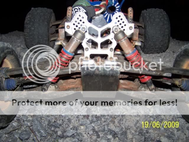

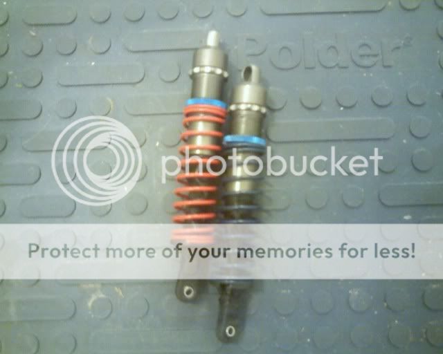

Yeah I didn't have time to finish my post... I wanted to ask everybody opinion on how to the local track back "on-line". It really needs a grass cutting and some weed eating but how would I go about helping stir interest?
Also I loaded my 4 UE Super Shocks with 80wt fluid blue springs in front and black in rear and still its bottoming out after any 10inch drop!! I hate that! Would it help to use 4 of my TRX Big bores as bypass shocks or as 4 regular shocks in addition to my Supers?
Any help in either of these areas is much appreciated.
-Zack
Bondonutz 08.08.2009 11:41 AM
My 2 cents;
A couple years ago I built a complete American CNC Machine EMaxx I tried just 4 Ofna shocks but had to have 8 shocks to keep it from bottoming out, It was 16.5lbs.
I also think if you install 4 more shocks regardless what brand you'll find the 80wt being to much. I settled for 50wt all the way around with extra firm springs,don't remember what lb rating the springs were ?
SnoopMaxx 08.08.2009 11:50 AM
I use Hyper 7 front shocks in the back with Savage Flux red or pink springs
Kcaz25 08.08.2009 11:56 AM
What about 40wt in the big bores and 80 in the supers?
Yeah Snoop I like my Supers and they are easy to find on the bay. Do you run all 8 shocks? 60wt right?
SnoopMaxx 08.08.2009 11:58 AM
4 in the front with T-Maxx heavy springs and 40wt
and 2 in the back with 60wt
I had to strengthen the RPM tower
http://i190.photobucket.com/albums/z...x/HPIM3258.jpg
http://i190.photobucket.com/albums/z...x/HPIM3257.jpg
