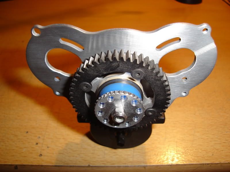

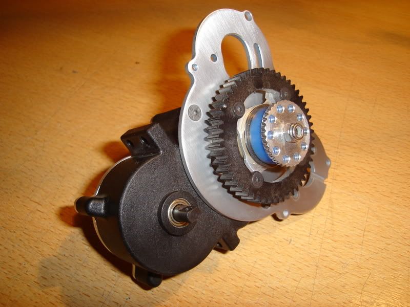

Thats very odd. Assuming the slipper is put together correctly, there should be plenty of thread left for another nut- got a close up & in focus picture of your slipper? Im baffled...
Hardstyle 10.15.2008 04:07 AM
Sure. Found these from here, I hope Dafni wouldn't mind for borrowing 'em. But relly the problem is same
http://i18.photobucket.com/albums/b1.../tranny001.jpg
http://i18.photobucket.com/albums/b1.../tranny003.jpg
<a href="http://picasaweb.google.com/lh/photo/wgq--YR4_HDtuSuID1CA_A"><img src="http://lh6.ggpht.com/olbero/SPWlywS17KI/AAAAAAAAAr4/D9FoZ2-ZDpc/s400/IMG_0525.jpg" /></a>
feistyacorn 10.15.2008 04:14 PM
Hi Hardstyle! I have a Strobe slipper too and what I did was look at what way the nut spins when you push the truck forward. The spur should spin in a counter clockwise direction when you look at it. This causes the nut to tighten or not move at all when the slipper is active. If your spur is going in a clockwise direction you can flip the diffs to get the spur to go in a counter clockwise direction. It’s kinda hard to explain in writing but I hope this helps. Sweet build by the way! :yes:
Hardstyle 10.15.2008 04:52 PM
Thanks! Yes, I know what you mean.. So basically if I pull 180 to the gearbox, it would tighten the nut all the time when driving forward? When I got the roller the gearbox were the other way around.. Have to look more into it. That was good tip!
suicideneil 10.15.2008 05:41 PM
Ah, you have a Strobe slipper, that explains it. Yeah, if you flip the tranny around, then switch a couple motor > esc wires around, the truck will still travel forwards when you pull the throttle, but the nut on the slipper wont undo as the gears are spinning the opposite direction to before.
