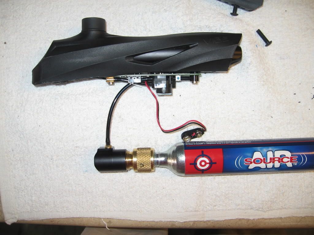

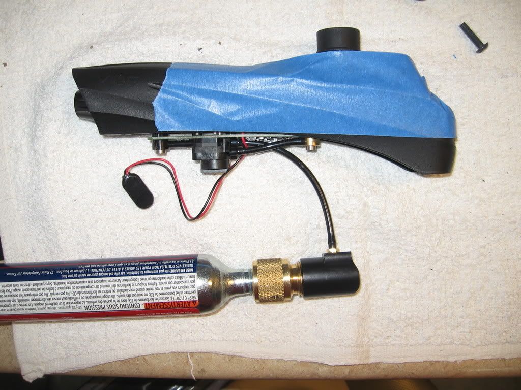

I’ve got questions paintball questions
• Can you please look at these shoots and then try your best to answer the following questions:
• Will this bottle setup work ??, I basically removed everything down to as far as it goes and I'm doing a direct connect now.
• Do I need to worry about any air reducers, diaphragm or what not’s ??
• Where can I buy this small black house ?? if I extend it will have a negative effect one the gun ??
• I'm thinking about just permanently locking the trigger switch on the main circuit board and running the it’s power supply to my 3rd channel on my RX (that way in theory) I just need to hit my 3rd switch and it goes live and starts shooting (???)
• let’s talk hopers shall we.. Do I want to use just a gravity feed one or the one I have ?
• I’ve gone to several paint stores but I couldn’t find a smaller one (is there on
• out that holds like 50-75 shoots in lue of 200 ??
• will my 9mm bottle get things cold with this setup (?) if so what insulation should I use to protect what little hose I have
• Any ideas on what to use the cover / protect the curict board, you’ll notice that I have elevated above the Truggy drivetrain so I'm good there but I need to cover / protect the boards from dirt and bashing..
More questions to come.. Thanks in advance for your time..

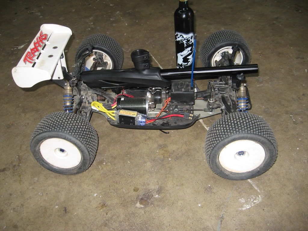

Dry fit in the Truggy.. Dam this fits great!!!
http://i264.photobucket.com/albums/i...7/IMG_3588.jpg
http://i264.photobucket.com/albums/i...7/IMG_3589.jpg
Look at the clearance I have, but how do cover / protect the board
http://i264.photobucket.com/albums/i...7/IMG_3590.jpg
Ok this is basicly where I whant it, I just need to extend the small black hose (bottle to gun / curict board) but can I, and where can I get the hose ??? :neutral:
http://i264.photobucket.com/albums/i...7/IMG_3591.jpg
Last questions. Will I ever get rid of my headache (ooooowwwwww) my head still hurts from all the K1..

t-maxxracer32 10.04.2008 05:35 PM
Originally Posted by TDC57 (Post 219249)
Thanks for the comments guys..
If that workedi would be very suprised. you have no regulator for the co2 tank so there will be WAY too much pressure for those poor hoses.
Im guessing you mean regulator? ya you will definetly need one of these to make the gun be able to hold all the pressure from the co2.
here is a link to the solenoid hoses http://www.paintballgateway.com/wgpaupnho.html extending it should not effect it too much but again.... i am almost positive you will need the regulator that game with the gun
this could work the problem is that when you hold down the trigger while turning on power to the gun it will go into programming mode.. so it will not shoot. maybe you could get a servo attach a horn to it and just turn the servo causing the horn to hit the trigger when you want it to shoot
since you already bought an electric one i dont see a reason to get a gravity feed. they are basically the same size. you could go with something smaller such as this http://www.paintballgateway.com/50ropohocl.html
above link
i honestly dont think it will work the way you have it. turn the gun on. if the hoses do not blow immediatly i will be very very suprised. even if they do not blow then... i am sure it will blow after a couple shots. these guns are meant to run at around 250 psi and without a regulator you will be well over the limit. you could buy a low pressure compressed air tank but these are much larger and much more expensive
http://www.paintballgateway.com/dxscoairtasy.html
electrical tape? you wont be launching this thing or bashing it crazy while the gun is attached im guessing?:neutral:
Shaun.
hopefully some of these answers are what your looking for!

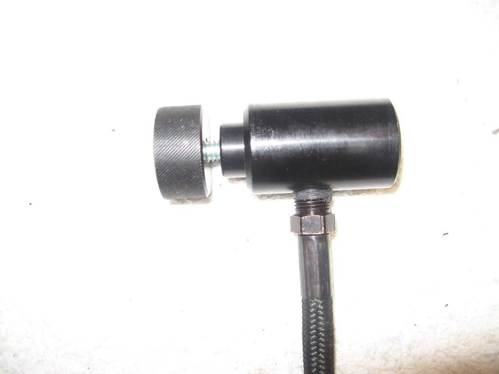

On the back of gun I’ve a star that I thought controls the amount of air ?? if not what does it do ??
What the hell is this and do I need it ??
http://i264.photobucket.com/albums/i...7/IMG_3593.jpg
So if I go back to the setup I’ll be fine because the regulator in the handle right ??
http://i264.photobucket.com/albums/i...7/IMG_3594.jpg
http://i264.photobucket.com/albums/i...7/IMG_3595.jpg
Can I still extend the small black hose like 10” ????
this star controls air for the bolt that is inside the gun (the bolt moves back and forth shooting the ball out) it does not control how much air goes into the solenoid hoses. if you mess with the knob it will cause the ball to drop extremely back and probably will make you chop. id keep it at stock settings. if you want to adjust how fast the balls go then you need to adjust your regulator.
heres a quick explanation.... star is what makes the gun consisten.
reg is what tells how fast to let the ball go
basically what this does is it allows you to put the tank in your pocket. its for people who go in the desert and want to be all sneaky.
correct. you just need this reg and it will be good.
should not matter if the hose is extended. you may lose some accuracy consistency or fps but im sure you really dont care about that
Thanks a buch..
glad i can finally help:na:

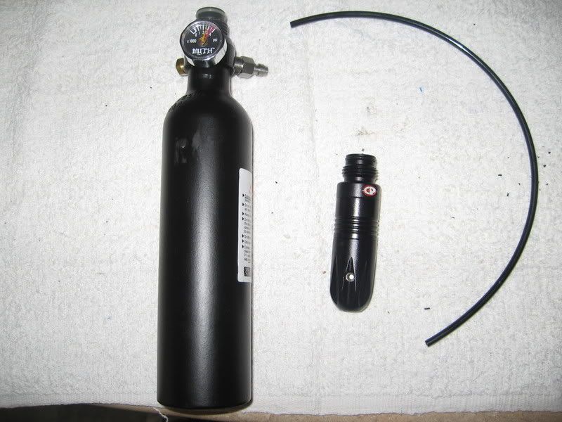

After reading up on what I should done a week or two ago (thanks for education T_maxxracer)I went back to the stores and got the following
• Smallest high pressure regulator I could find
• Smallest scuba compressed air I could tank I could find. (this shouldn’t get cold)
• And I got extra tubing to accommodate for the relocation of the tank..
