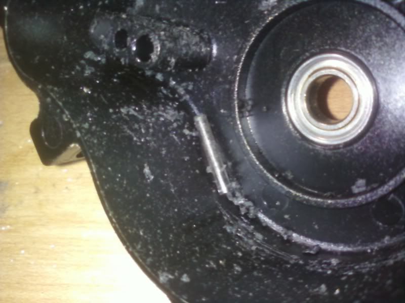

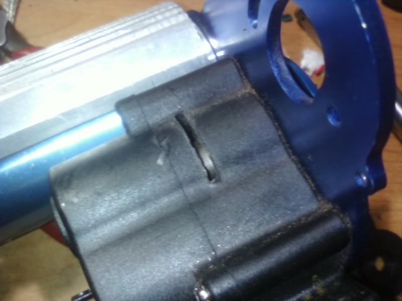

Originally Posted by brushlessboy16 (Post 266616)
Something Went in the transmission.. was running out in the snow and watched a small fragment of something go flying out of the truck then had no power to the wheels. upon further inspection there is a gauge mark on the top of the transmission where a pin(i think) came out the top.. And now the top gear shaft and slipper can slide in and out of the transmission about 1/2 inch. I tried the truck out in 1st gear to diagnose, and found nothing, but in second the truck runs fine until the top shaft jumps out.. this leads me to beleive that the 1st gear roll pin came out..
What do you guys think.
Can i tell you that it is a PITA to get the trans out of an emax..
Sounds like the input shaft roll pin. Use a piece of an allen head wrench or a steel drill bit cut down to fit. That with steel idlers and your tranny should be rock solid.
brushlessboy16 03.04.2009 07:52 AM
Yeah, i replaced it with an allen wrench end. The idlers have 0 wear as far as i can see. :)

Originally Posted by suicideneil (Post 266663)
Yep, roll pin has left the building!
Its not that hard to remove an emaxx tranny really, only 8 screws... :whistle:

brushlessboy16 03.04.2009 08:01 AM
http://i152.photobucket.com/albums/s...1236168030.jpg
http://i152.photobucket.com/albums/s...1236168015.jpg
http://i152.photobucket.com/albums/s...1236167995.jpg
Finnster 03.04.2009 11:15 AM
Nice to see the 8XL is back to destroying maxx trannies :)
It did even kill an allen wrench fix once. Then I drilled out the hole a bit and used a bigger pin. G/L
