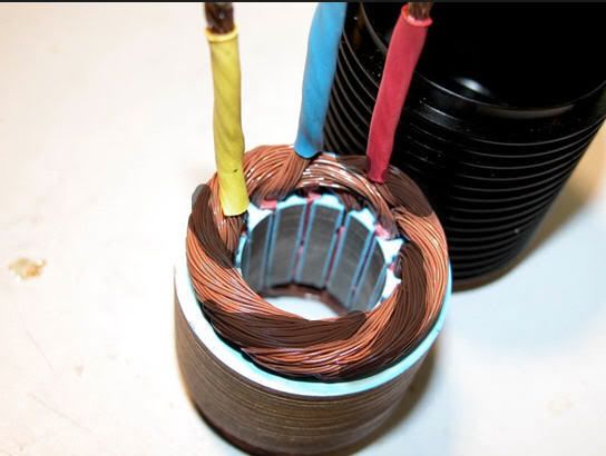

Well... I still don't have my camera to take pix of the motor. So instead, here is a screen shot of a Neu motor, and I just drew on it to represent what the coils look like.
As you will see... the wire from one of the three motor wires is what is burnt looking... and I'm guessing that can't be good. So, did the ESC cause that to happen, or did the motor fail and fry the ESC? We'll probl never know.

suicideneil 07.20.2009 12:28 PM
Remember that the motor pulls current, the esc doesnt push it, so in likely hood a phase shorted out somehow, causing the esc to fry also (nothing like trying to deliver current to a shorted piece of wire to cook your FETs)...
Is there any damage to the wire/ insulation where it enters the motor can?

No apparent damage to the wires leading into the can, no. Yer talking about the Blue, Red, and Yellow wires right? They seem ok. But I noticed that whatever wire has blackened, it's that way thru the entire can because it's the same way on the opposite end.
SURELY this the motor is going to have to go in for repair to Neu right? I'd have to assume it's repairable too. It would need rewound, but i'm sure it can be fixed. The motor spins freely by hand, but that's doesn't mean much.

Ok, here is an update on where I'm at. Still waiting on the MMM to come back from CC. However, something interesting has came about regarding the Neu. I sent pix to Neu and they responded saying that it looks like one of the wire leads had shorted, which means it will have to be sent back in for repair. He said that they would have to replace the stator.
A friend of mine was telling me that Neu now does something different with their leads because they were having problems with them shorting out on the can. This makes me think... what if the motor shorted out and THAT is what smoked the ESC?
YES, I was overgeared, and YES that isn't good. But as I've said before, I hadn't been running the truck hard AT ALL with those Moabs, only by PURE LUCK. My situation wasn't such that I was able to get on it. I was only putting around the yard and low to med speed, and only for about 20min tops. Sure the tires could have did the ESC in, but I don't think the ESC fire caused the motor to short. Wouldn't it seem more like the other way around? Just a thought.
