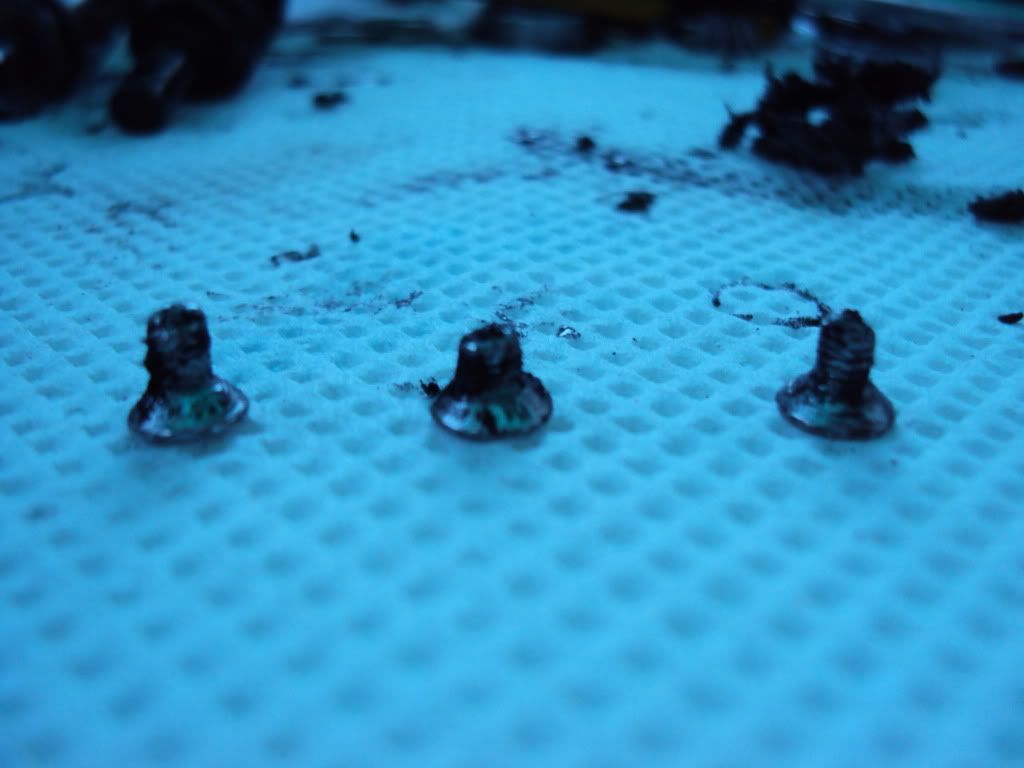

After my last run on saturday doing jumps, i noticed a perculier sound coming from the diffs, and then before you knew it i had thought i had stripped my BP Diffs...
Upon inspection and checking them yesterday... this was found to be NOT the case... My ring and pinion are absolutely fine... So what happend???

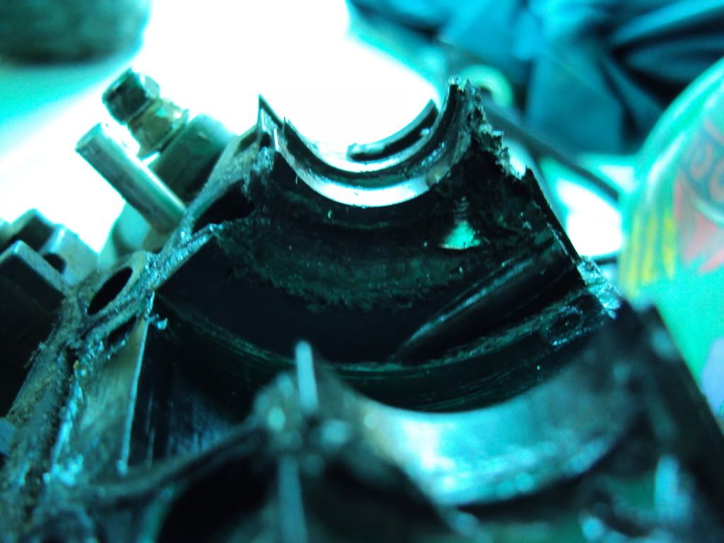

All 4 screws backed out of the diff casing holding the ring gear on.... What was the result??? psh... look at these pics...
http://i878.photobucket.com/albums/a...7/DSC00482.jpg
Crazy!!! So i was then thinkinig... where the hell is the 4th screw head? I looked everywhere in the diff grease and couldnt feel or see it......
Where did i find it in the end??? Check this pic of the bulk head. And notice the groove cut out by the screws that muse have slided it up upon backing out...
http://i878.photobucket.com/albums/a...7/DSC00483.jpg
I am happy as no gears were damaged, and it shows that you really should not get any diff oil in teh screw holes or the loc tite wont work...
I knew this but i was in a rush to get it running....
I know the inside of the bulks are destroyed, but i really want to run this weekend so i am going to give it a go... if it works, then great... if not, then what ever... but i think its time for some GH Alloy Bulks (but no deniro at the moment so will have to do with stock...)

the screws them selves came out of the steel diff housing. So loc tite does work, but in my rush to assemble and fill with diff oil... some of the oil got in the screw holes. And the loctite obvioulsy didnt work causing the screws to back out...

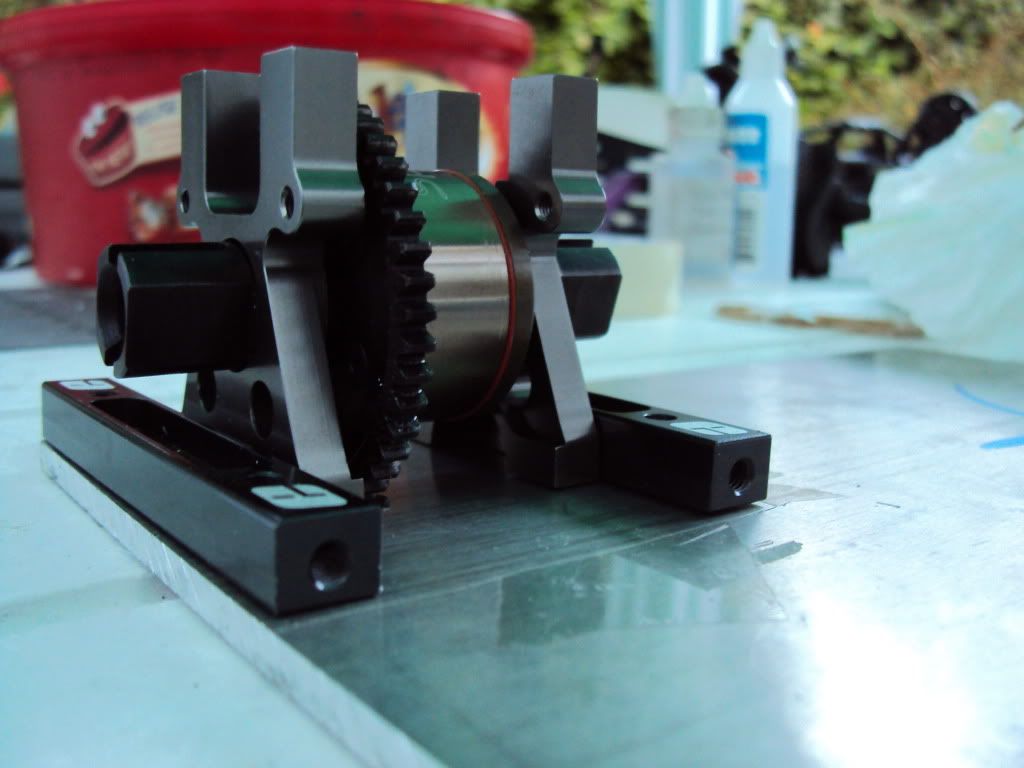

Jahay 07.22.2010 04:28 PM

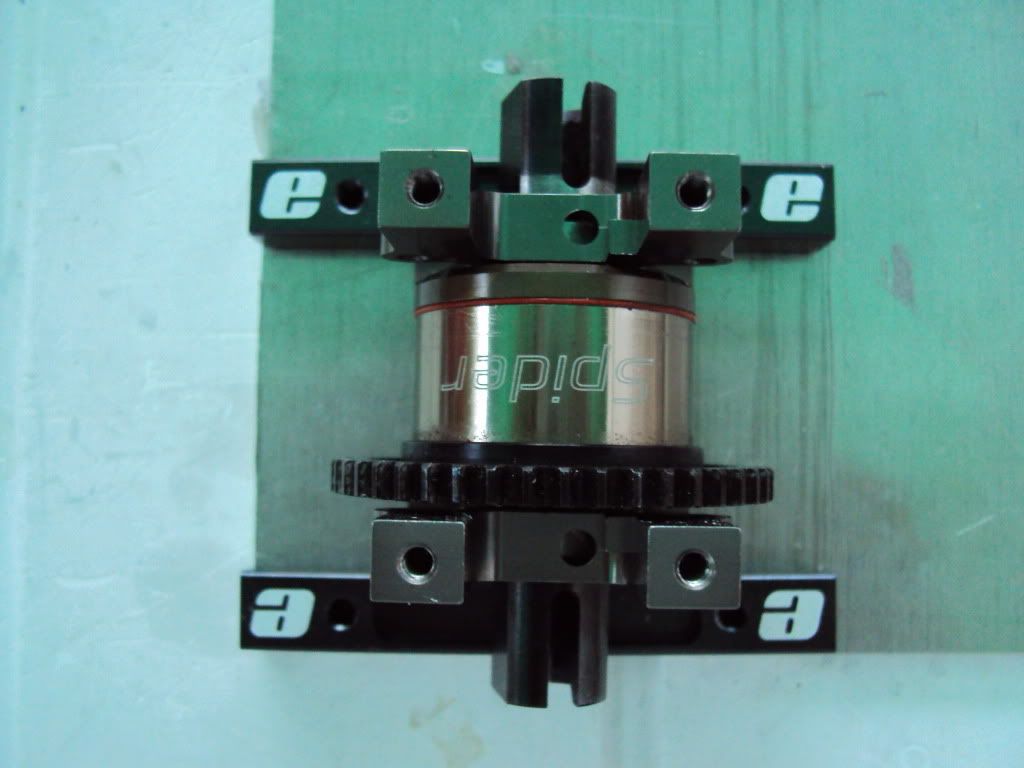

Thanks to _dv i have been able to start my Centre diff conversion

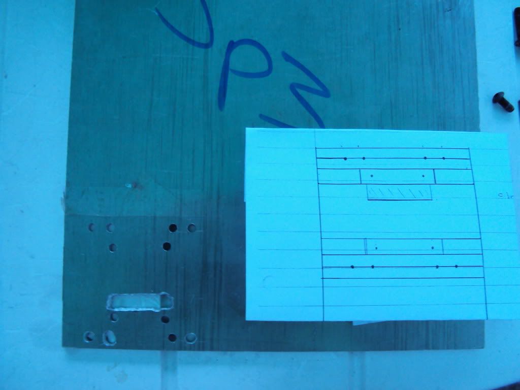

... Ive been rushing the work so it hasnt been so accurate but it will work well once i am finished... would have been so much easier to get it cnc'd if i had done a cad drawing, but hey, it really isnt that hard and just takes a bit of time to get everything to line up
Ok So i am using a 4mm alloy plate as the base plate...
Here are some pics of my progress so far...
http://i878.photobucket.com/albums/a...7/DSC00486.jpg
http://i878.photobucket.com/albums/a...7/DSC00487.jpg
http://i878.photobucket.com/albums/a...7/DSC00488.jpg
I will get fitment finalised properly tomorrow...
then
find the best mounting between the tvps which allows me to utilise my originial front drive shaft so i will only need to get one custom rear drive shaft made up.
_dV 07.24.2010 09:23 PM
What's the weight of that center diff? Outside bearing measurement?
You'll be happy to know that my diff mount has had no issues in the few test runs i've done.
One small bit of advice, make the cutout for the spur wide enough so that you can easily remove the diff from mount closest to the spur when the opposite mount is removed.

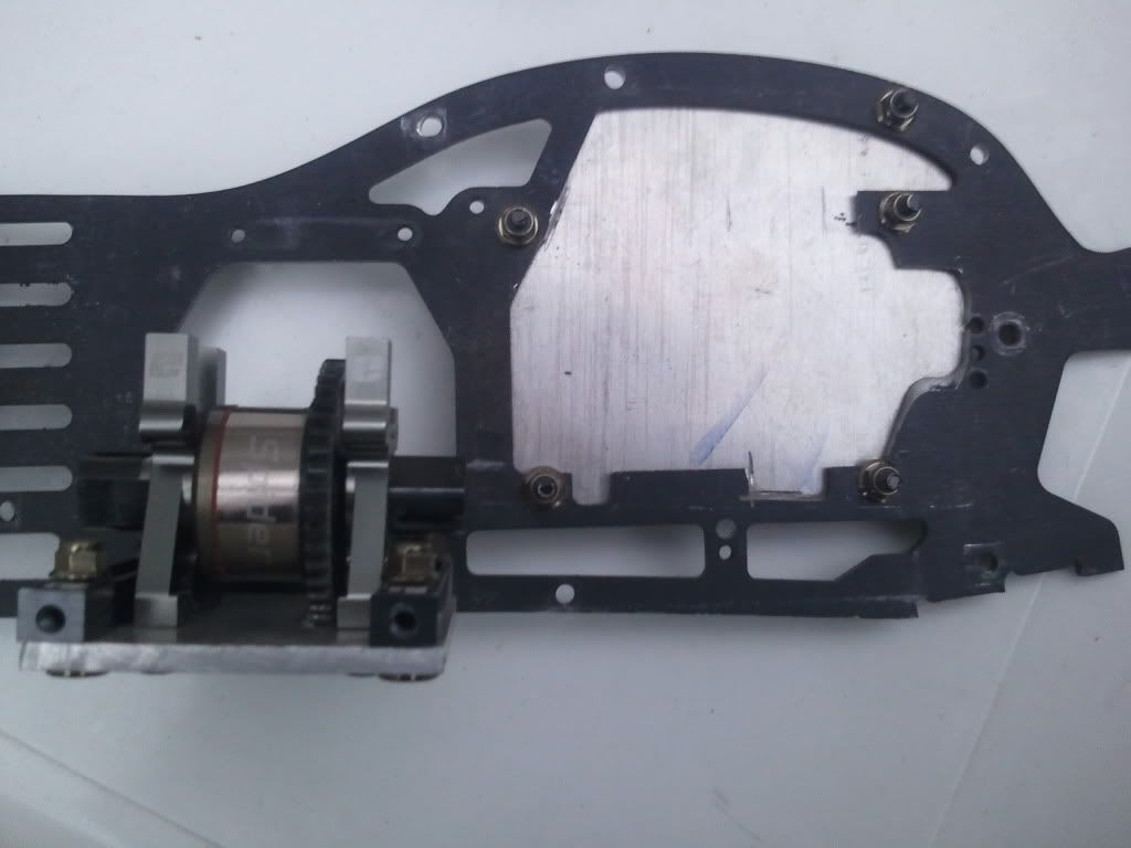

Jahay 07.25.2010 06:53 PM

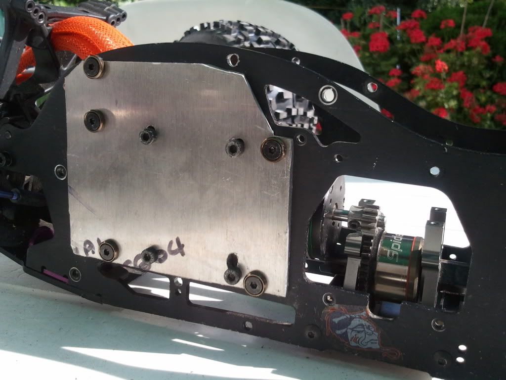

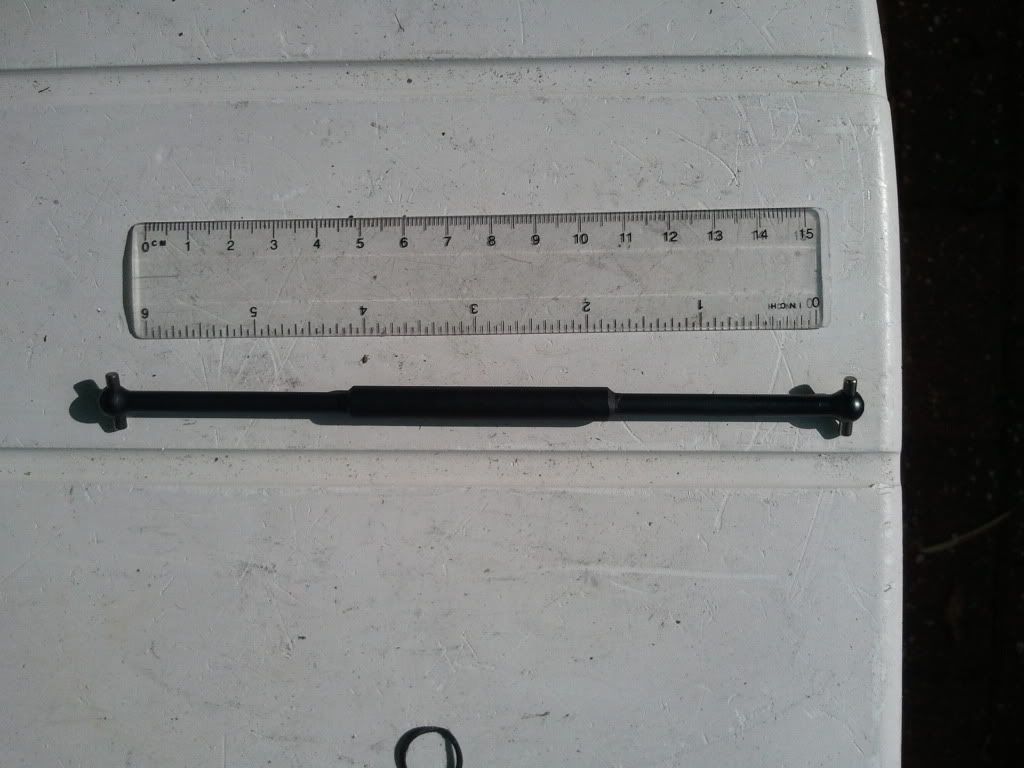

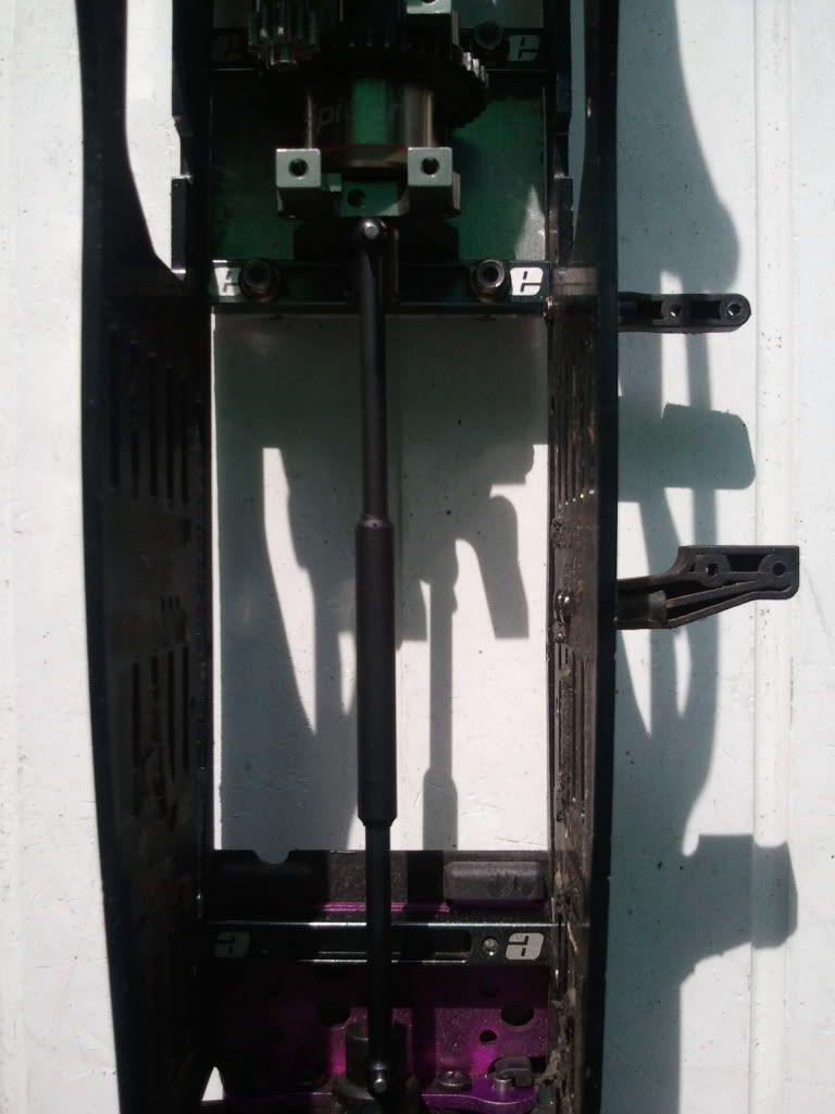

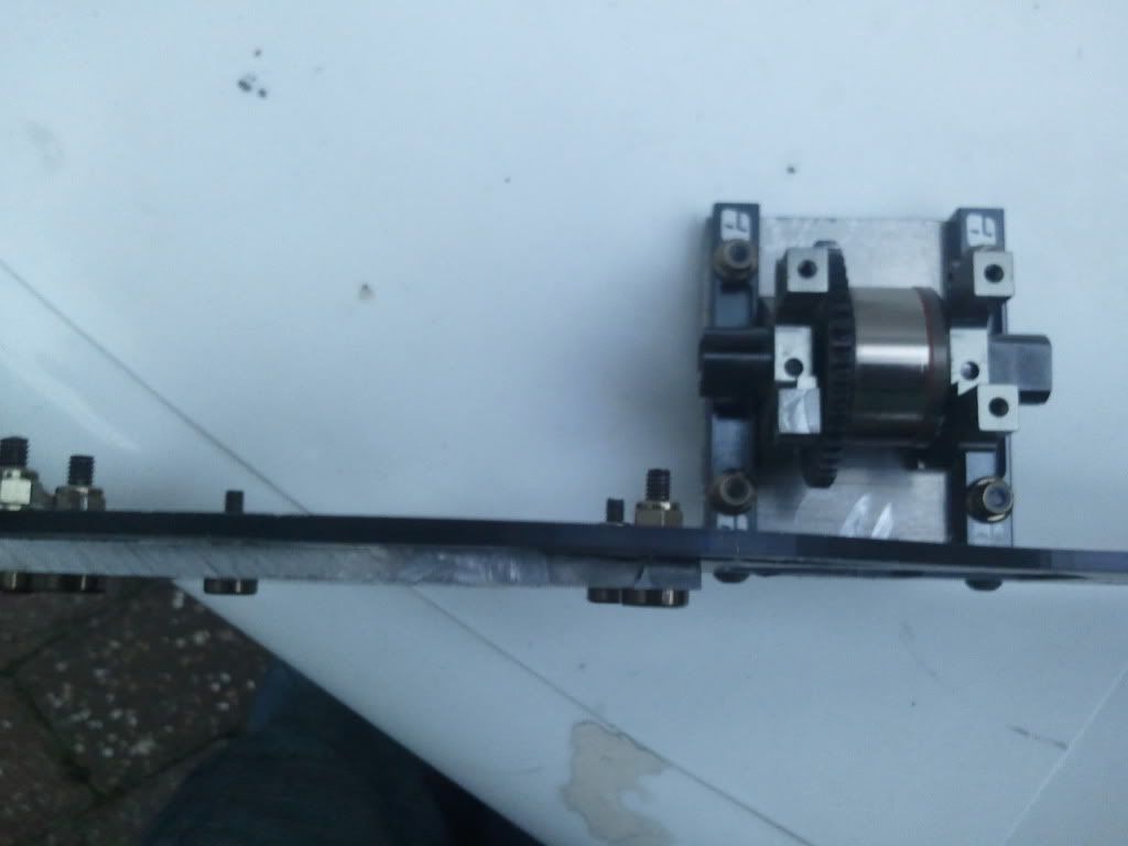

I made some progress today... I have mounted the diff to the TVPs and worked out i need a 16.5cm Rear drive shaft made up...
I also cut a alloy plate which will act as my motor plate and will be bolted to the side of the TVPs...
http://i878.photobucket.com/albums/a...7/DSC00498.jpg
http://i878.photobucket.com/albums/a...7/DSC00497.jpg
http://i878.photobucket.com/albums/a...7/DSC00494.jpg
This is how the motor plate may look with the motor attached to the plate...
http://i878.photobucket.com/albums/a...7/DSC00496.jpg
http://i878.photobucket.com/albums/a...7/DSC00500.jpg
_dv thanks for the advice, i will do that... i will get the dimensions of the diff for you tomorrow.

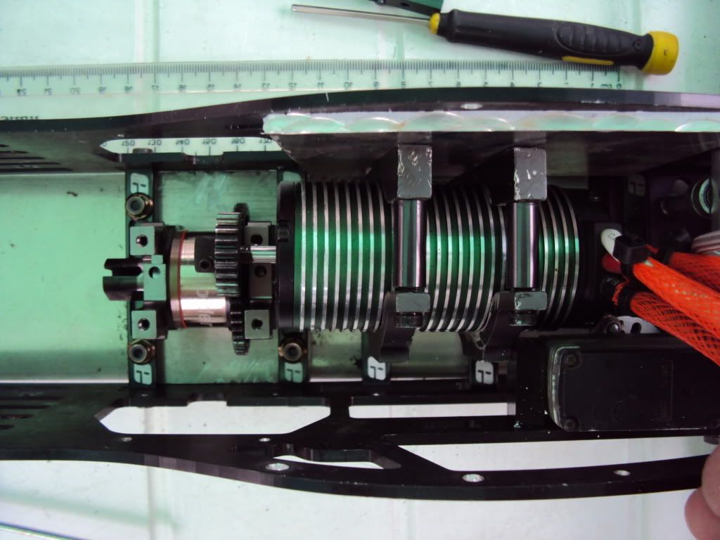

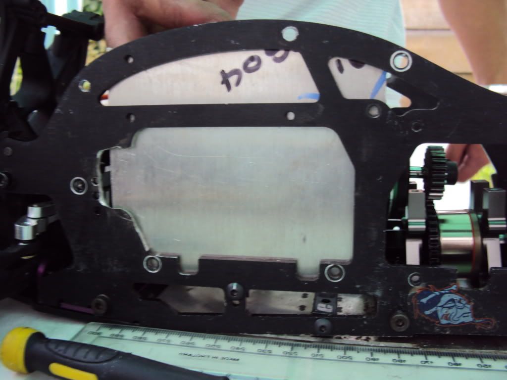

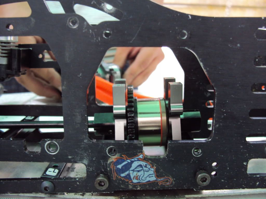

further update... getting there now
Tiny update.. things are moving slow but at least they are moving...

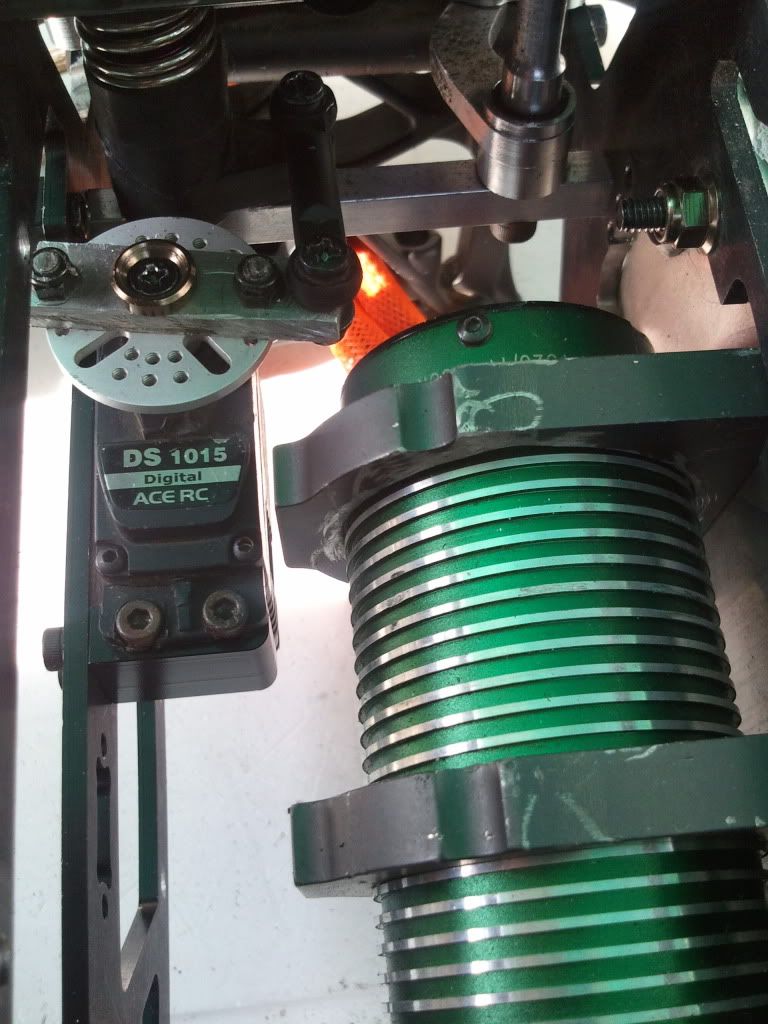

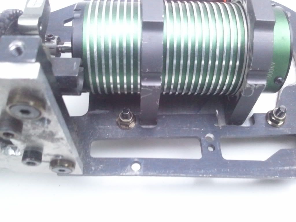

I have now managed to mount the motor to the plate. Wasnt the cleanest job, but it does the job. Some pics for all yall :)
In this image... you can see where i had to cut some slots in the tvps for the motor mounts to slide down enough to provide the right mesh.
http://i878.photobucket.com/albums/a...8-05203448.jpg
You can see what i mean in this pic below
http://i878.photobucket.com/albums/a...8-05203521.jpg
All connected with a nice mesh
http://i878.photobucket.com/albums/a...8-05203557.jpg
You can see how thick the alloy plate is... must offer a little structural rigidity to the tvps considering i have chopped them up a little bit
http://i878.photobucket.com/albums/a...8-05203741.jpg
This is what it looks from the outside...
I know i know, it ugly... But what i will do now as its all fitted... i will sand the edges smooth and angle them towards the chassis, and i will paint any alloy bits black for now, so it all blends with the tvps. Anyway this will be covered by the lipo boxes soon... 9s here i come :)

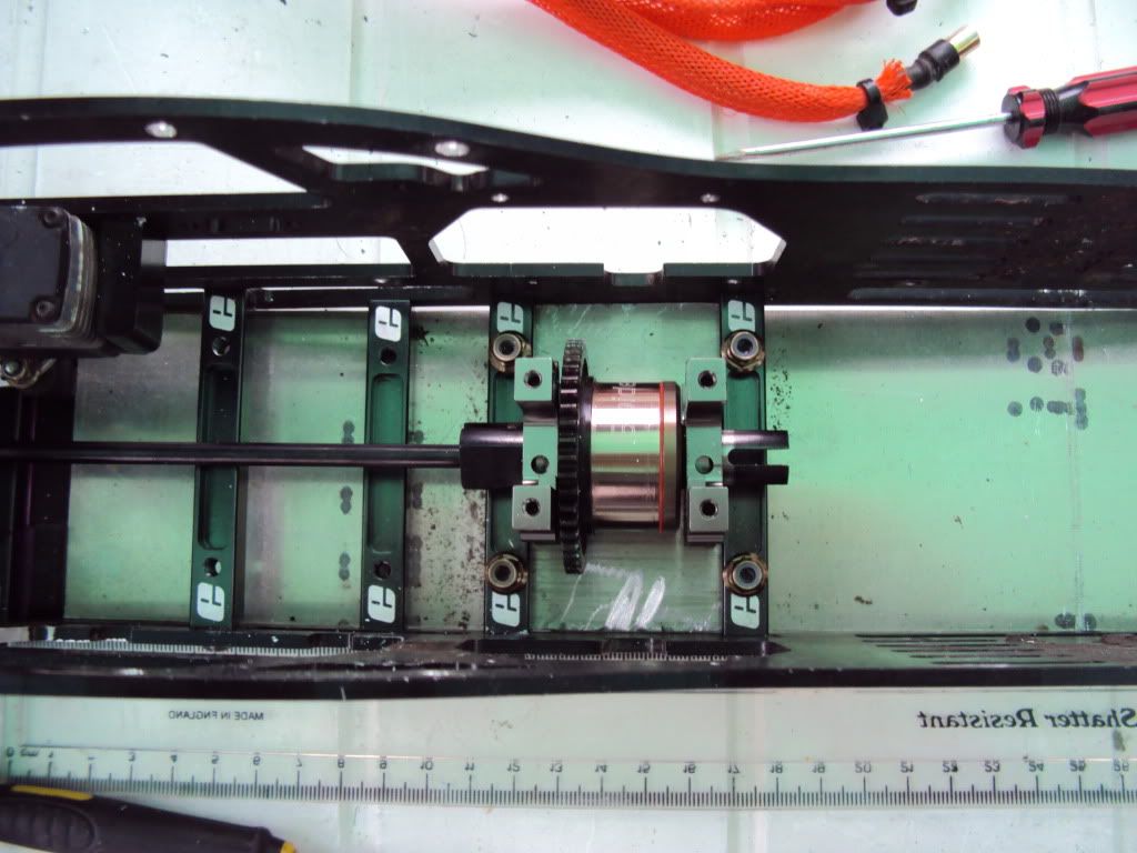

What it looks like on the inside all assembled
http://i878.photobucket.com/albums/a...8-09092308.jpg
And my new Rear drive shaft sent from Chris at GCM... Thanks buddy!!! arrived quickly and fits perfectly! Legend!
http://i878.photobucket.com/albums/a...8-09092522.jpg
I had to cut a little away from my batter tray as the thick centre part was hitting it slightly... not a big issue though and was expected.
http://i878.photobucket.com/albums/a...8-09092458.jpg

nuz69 08.10.2010 03:52 PM
Hello,
This setup is lighter than your previous gear box no ?
Don't forget to cover the front motor holes with tape to avoid the dust to go in.
Still all good with your 1520 ? I race with mine now, it rarely breaks 40°C (geared for 40 mph), so :yipi:
NuZ
