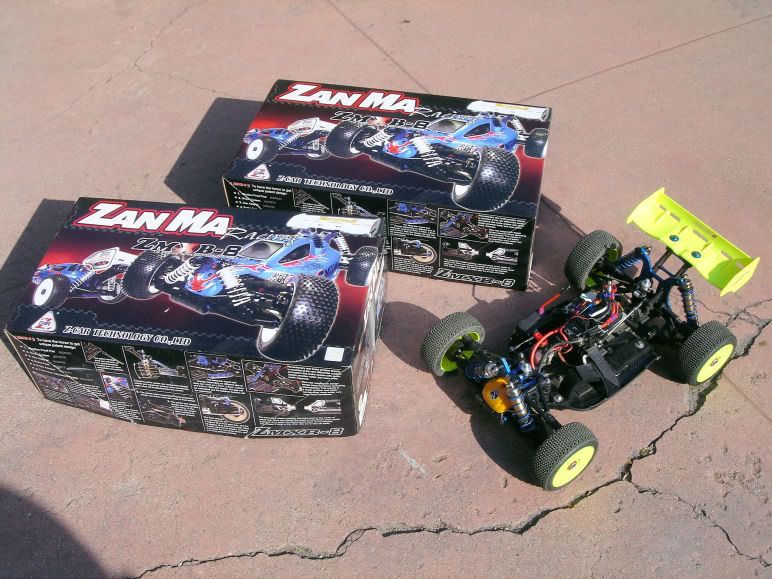

Shark413 01.11.2009 04:48 AM
Here is my Z-car and I also got a box full of spare parts.
http://i142.photobucket.com/albums/r...3/DSC05265.jpg

Shark413 01.12.2009 01:46 AM
Originally Posted by Cain (Post 251124)
dumb question, but when you moved the chassis brace, did you need to drill a new location or just use different holes, and, could you use the stock chassis brace or did you need to use a tubed brace?
Cain, I had to move the chassis brace over because I needed more room for my TeknoNeu 1515 brushless motor. I could not move it over enough to use the smaller pinions, it would hit the chassis brace. To move the brace you need to cut a small slot on the bulkhead brace for the top mount. I used the tubular Kyosho rear buggy brace because it lined up with the existing hole in the chassis. The stock brace when moved over did not line up with any of the existing holes. If your going nitro you want to leave the stock brace where it is.
