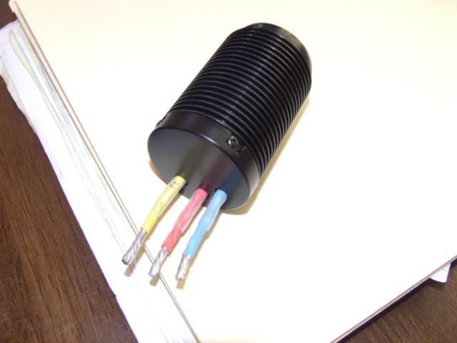

i little heads up NEU has released another update on there motors and if you get one of the motors from the latest batch Mikes cover will not work, they have increased the thickness of the can where the screws go into the rear endbell, its now too large to fit in mike cover's i talked to mike about this last week when i found it out on my motor (which was from their newest batch) and he is working on an updated cover for these as you cant just cut out for the screws, but you also have to dremel out the entire inside diameter alot, so much that with the newest motors the screws heads stick out FARTHER than the fins and the cover, i havent gotten around to it yet but tonight i will try to get pictures up of what i am talking about. BUT by now mike might already have new covers worked up since its been over a week.

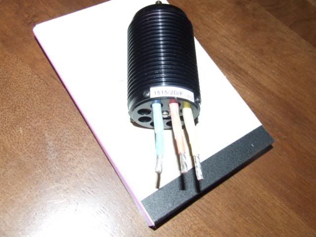

I just recieved a 1515/2d today made 7/2/08, it has the clear covering over the colored heat shrink on the motor wires, the endbell screws are phillips head not hex and the RCM cover with the predremeled slots is too small in diameter, the motor must be 1mm larger Dia. or something. On that note im buying some calipers.

It gets worse - I have seen a few Neu motors with the screws rotated about 25 degrees from their "normal" locations. I now have 3 versions of the endbell covers. The "original" with screw reliefs for motor made before July '08 (ish - not sure of the exact date), and 2 versions for the latest motors with the larger diameter(one "normal" and one with the screw holes rotated). The latest Tekno motors also have the larger diameter according to Neu (FYI, Tekno Dan - I also left you a voice mail regarding this).
Of course, this makes it hard to determine which cover you might need if you get the motor seperate from the cover(like from somewhere else). I may need a picture to determine the actual correct version!

and jayjay take a dremel with an endmill and just go around and around in end bell cover keeping the same light pressure at all times and just mill it out, this is what i had ot do to mine, and youll also to to cut reliefs for the screws, but becareful milling it out and onyl take of a tiny bit at a time and check your fit you do want it to be tight but not need two hands to put it on tight..........hope that helps ya.

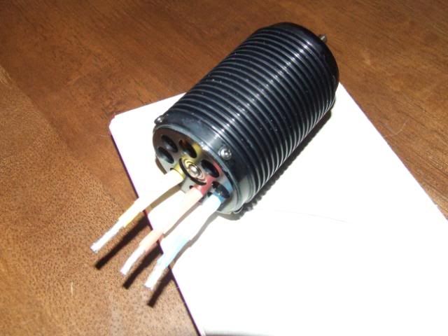

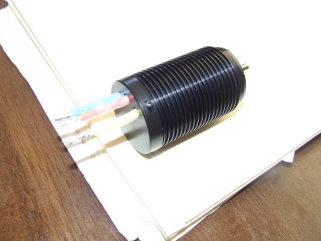

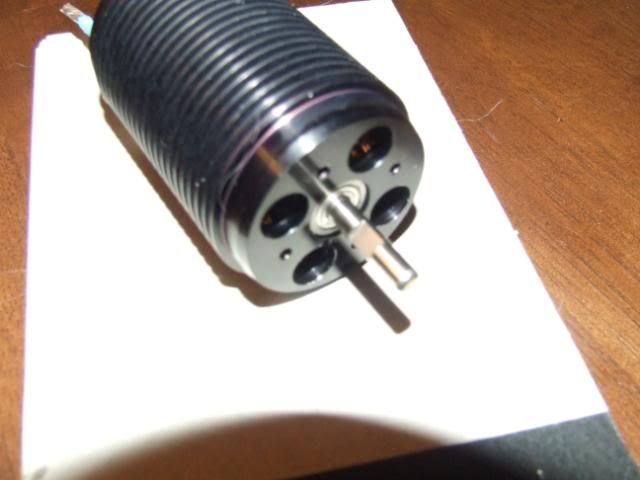

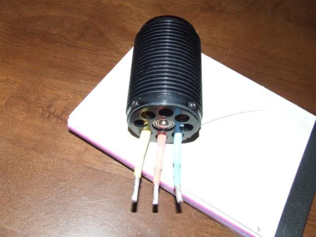

jayjay283 08.15.2008 01:21 AM
Thanks Rootar & Mike, Ill post the pics here so you can check it out and see which I need, No big deal if you dont have larger ones I can just dremel it up like Rootar suggested..ive bought 3 Neus in about 8 months and everyone is different LOL Steve needs to cut that crap out...
1515/2d/f
http://i278.photobucket.com/albums/k.../2d4rcm002.jpg
http://i278.photobucket.com/albums/k.../2d4rcm005.jpg
http://i278.photobucket.com/albums/k.../2d4rcm004.jpg
http://i278.photobucket.com/albums/k.../2d4rcm008.jpg

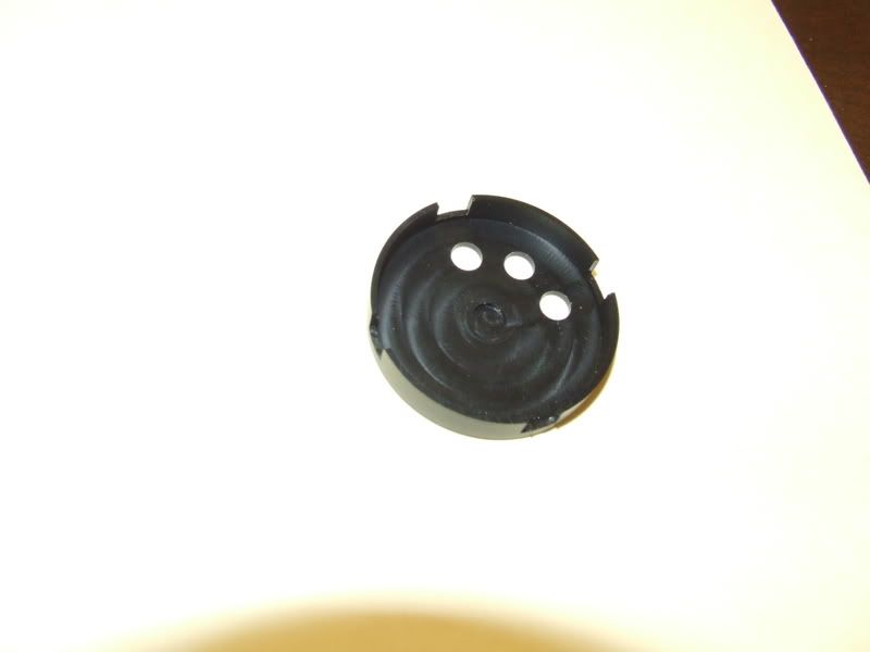

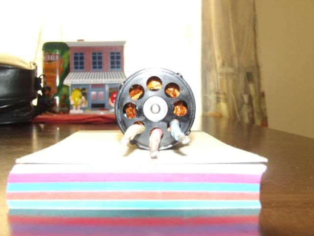

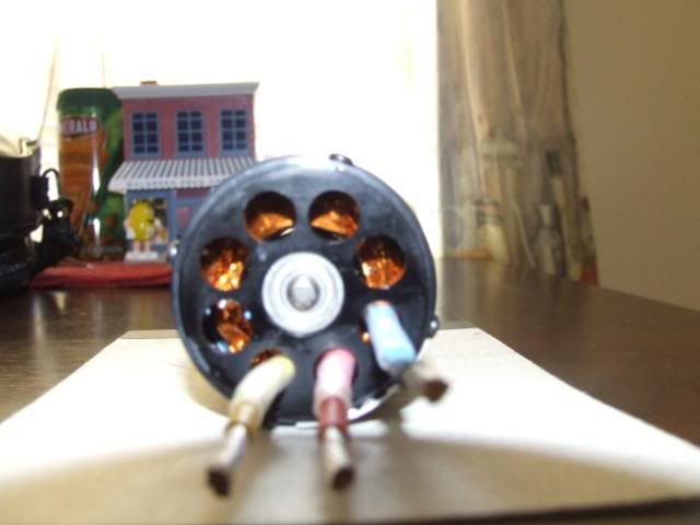

jayjay we need a pic like my first below of yours, alos notice how the screw is the farthest thing out of the motor and take note on the placement of the screws in relation to the motor wires, my second picture show where i took the endmill to it on the inside, if i were you id just go ahead and do this and save you and mike the trouble of waiting to get a new cover, itll only take 10 mins and you can make it fit however tight you want it too, mine almost snaps on.
good luck and remember just use light pressure, high speed, and testfit often.

Yeah the screws stick out farther than the fins
http://i278.photobucket.com/albums/k...eu2dboo004.jpghttp://i278.photobucket.com/albums/k...eu2dboo006.jpg

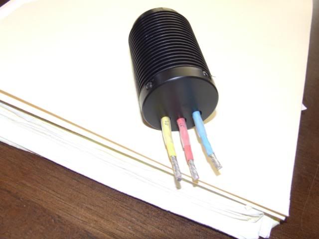

Dudes ! .. Mike made up a neu cover for the new Neu specs and shipped it out to me Friday (same day I posted the pics for him) and I have it today. What a friggin cool dude. Its a perfect fit, good to go. Nice job and Thanks, you seriously rule..
http://i278.photobucket.com/albums/k...eucover010.jpghttp://i278.photobucket.com/albums/k...eucover012.jpg
http://i278.photobucket.com/albums/k...eucover008.jpg
http://i278.photobucket.com/albums/k...rinside003.jpg
