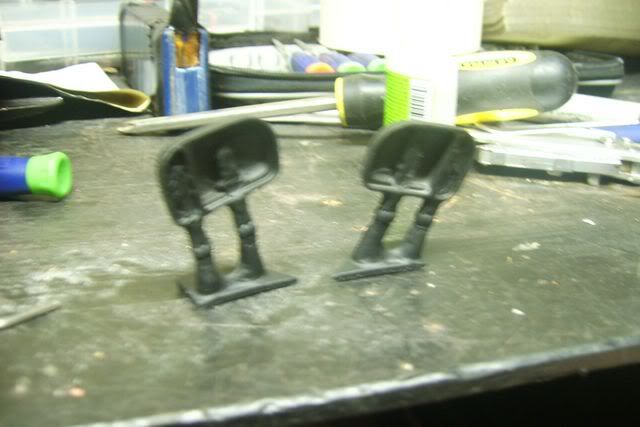

Started on some hinges for the mirrors so they will fold in.
http://img.photobucket.com/albums/v4...0F-350/yep.jpg
http://img.photobucket.com/albums/v4...F-350/yep2.jpg
http://img.photobucket.com/albums/v4...F-350/yep9.jpg
http://img.photobucket.com/albums/v4...-350/yep10.jpg
http://img.photobucket.com/albums/v4...-350/yep11.jpg

Got the mirrors all glued up. Just have to smooth out the glue and get them all nice looking and they will be done.
http://img.photobucket.com/albums/v4...F-350/body.jpg
http://img.photobucket.com/albums/v4...-350/body2.jpg

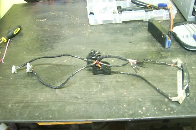

Here is the lights and receiver. There going to stay attached to the bodt and i just pull the 3 servo wires loose and it all comes off with the body. I took the light box apart and smeared it all with some dielectric grease and stuck it in a ballon. Also did the same for the Spektrum receiver. Just need to put some silicone aroudn the lip of the ballons and it will be ready for some submarine action. Wrapped all the light wires in electrical tape to clean it up a little bit and make it look a little better.
http://img.photobucket.com/albums/v4...waterproof.jpg

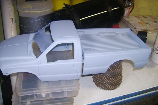

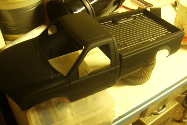

Also filled some more holes and started sanding the body prepping it for paint. I might paint it tomorrow if I have enough time.

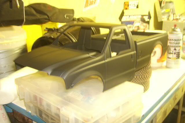

Foxracin 06.15.2009 09:30 PM
Smoothed the mirrors a little bit and painted them.
http://img.photobucket.com/albums/v4...-350/paint.jpg
Started painting the body.
Primer.
http://img.photobucket.com/albums/v4...350/paint4.jpg
Flat black.
http://img.photobucket.com/albums/v4...350/paint2.jpg
http://img.photobucket.com/albums/v4...350/paint3.jpg
Ill paint the bottom 2 tone deal and the bedliner tomorrow when I get a chance.

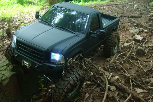

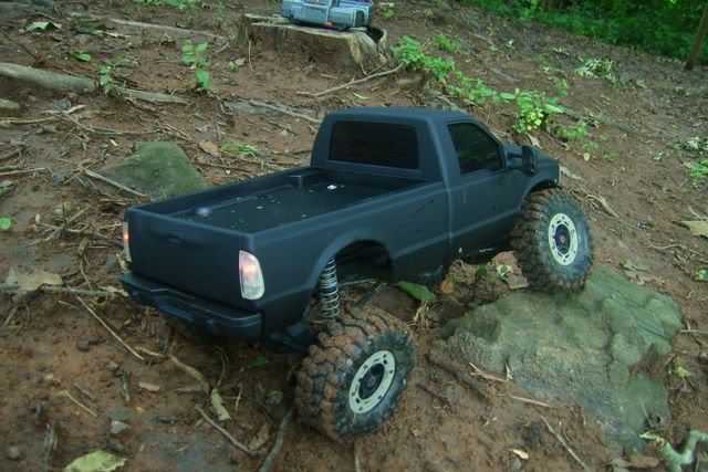

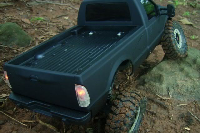

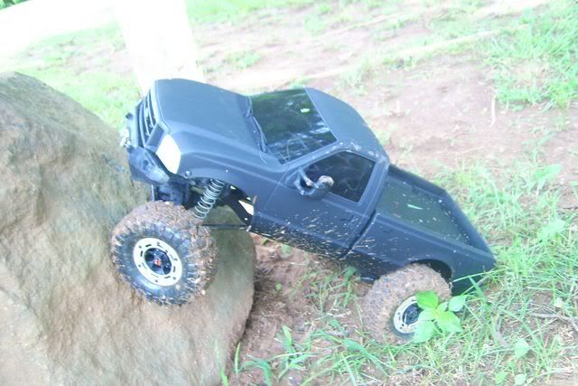

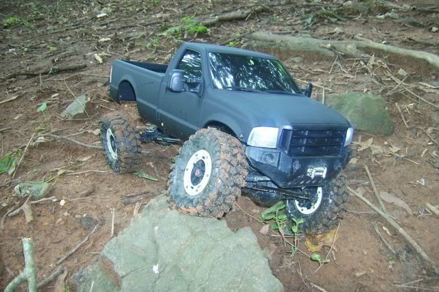

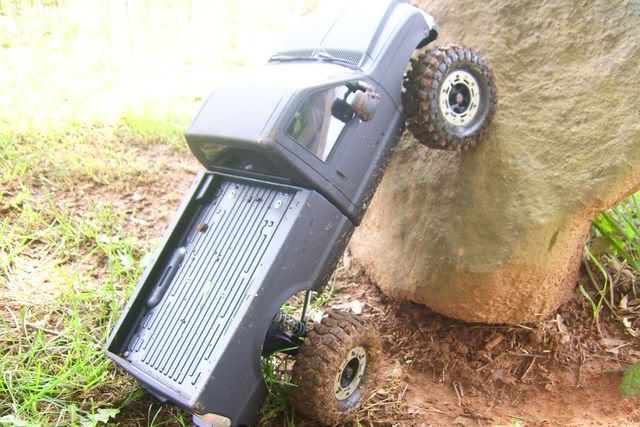

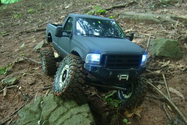

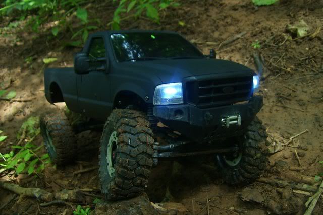

Foxracin 06.16.2009 03:26 PM
Finished the paint and took it for a little spin.
http://img.photobucket.com/albums/v4...001640x480.jpg
http://img.photobucket.com/albums/v4...002640x480.jpg

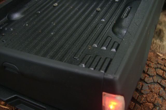

Bed liner.
http://img.photobucket.com/albums/v4...003640x480.jpg
2 tone deal.
http://img.photobucket.com/albums/v4...004640x480.jpg
Random pics.
http://img.photobucket.com/albums/v4...005640x480.jpg
http://img.photobucket.com/albums/v4...007640x480.jpg
http://img.photobucket.com/albums/v4...006640x480.jpg
http://img.photobucket.com/albums/v4...008640x480.jpg
http://img.photobucket.com/albums/v4...009640x480.jpg
http://img.photobucket.com/albums/v4...011640x480.jpg

What's_nitro? 06.16.2009 08:35 PM
Sweet. I really like how the body looks with the flat paint. How are the mirrors holding up?
johnrobholmes 06.16.2009 09:17 PM
My favorite kit ever. Doesn't it just crawl like a champ?
Great looking rig there.
Foxracin 06.16.2009 09:45 PM
Holding up great so far. Rolled it a few times and they just folded right in.
Foxracin 06.16.2009 09:46 PM
It suprised me how well it works. lol

Well I stole the sidewinder out of my other crawler to put on here to get it ready for the 3 cells. I put it in the radio box. It doesnt fit unless you take the heat sick off but I didnt want to do that so I just trimmed them all down just a tad. Doesnt take much at all. I took maybe a 1/8" off all of them and it fits great now. Also cut off the switch so I just use the deans for the switch now also.
http://img.photobucket.com/albums/v4...idewinder5.jpg
http://img.photobucket.com/albums/v4...idewinder6.jpg
http://img.photobucket.com/albums/v4...idewinder3.jpg
http://img.photobucket.com/albums/v4...idewinder4.jpg
http://img.photobucket.com/albums/v4...idewinder2.jpg
Now I just need to seal it off with some silicone so it will be waterproof.

My version of "truck nutz"
http://img.photobucket.com/albums/v4...-350/accs5.jpg
http://img.photobucket.com/albums/v4...-350/accs6.jpg
What's_nitro? 07.01.2009 02:43 PM
