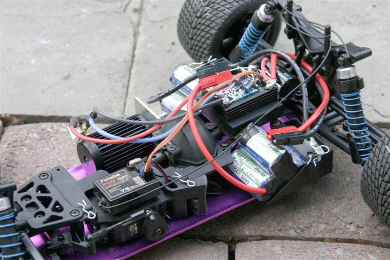

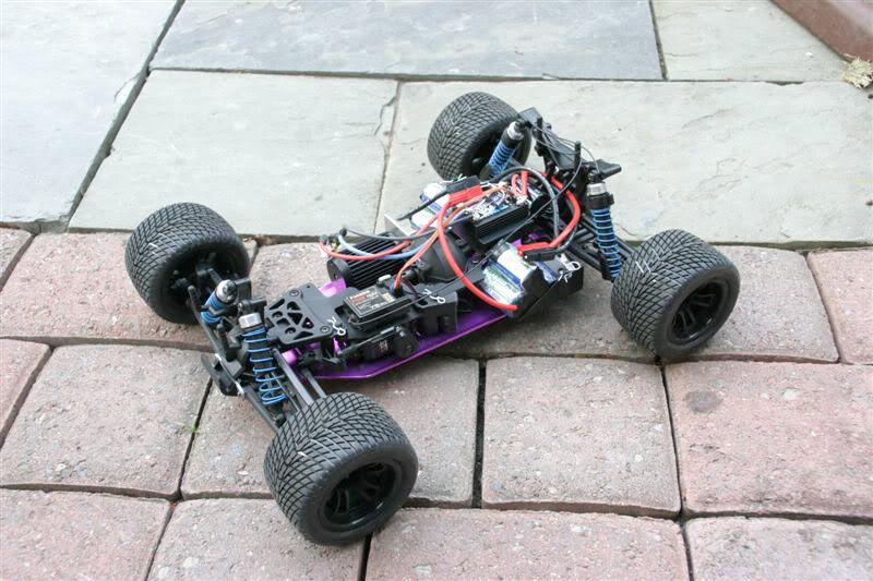

GeeReg 06.21.2006 08:00 PM
*UPDATE*
Well it's finally together....or was.

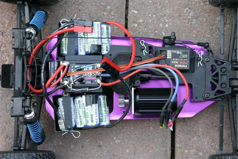

Before the first battery pack...
http://img.photobucket.com/albums/v2...6419Medium.jpg
http://img.photobucket.com/albums/v2...6420Medium.jpg
http://img.photobucket.com/albums/v2...6421Medium.jpg
http://img.photobucket.com/albums/v2...6422Medium.jpg

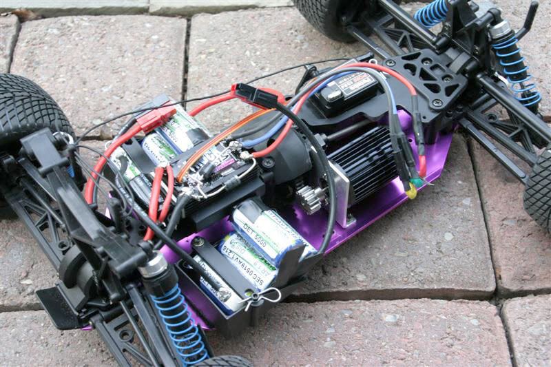

Aaaand this is after the first pack...
http://img.photobucket.com/albums/v2...6424Medium.jpg
Full throttle + Water pipe thing sticking out of the lawn = that
First impressions:
Well, it's FAST. This is my first real brushless other than my SS5800 in my T2. I was going to put the gps on it tomorrow but now I can't. From a dead stop if I nail it it'll veer to the left and I can't keep it straight.
It handles pretty well and seems to jump ok off of the tiny jump I had. I'm pretty happy so far. The controller was getting pretty warm though with not even a full pack ~135-140, the motor was maybe 130. I'll probably add fans eventually. It's geared 52/15 right now with the Road Rages.
Oh and it's pretty noisy, is that just the sound of mod1 gears? The mesh is good so I think that's just how it is.
It needs a few tweaks but overall I think it was a success! :dft012:

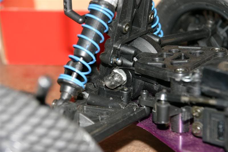

A question about the veering, I filled the front and rear diffs with 3 or 5000 wt silicon. Would that cause it? Or is it just the torque?
cart213 06.22.2006 05:38 PM
It shouldn't be the torque causing it to veer. My MT2 doesn't veer, and my 540c-9L has a lot more torque than your 380c-6L. I'm not sure about the diff fluid. I just use grease in mine. How did you seal the diffs?
Btw, the gears are noisy on these, and not just the spur/pinion. A lot of the noise comes from the front and rear diffs.
GeeReg 06.22.2006 05:53 PM
I didn't seal them, but they haven't leaked as far as I know. I'll have to do more testing when I get it fixed.
