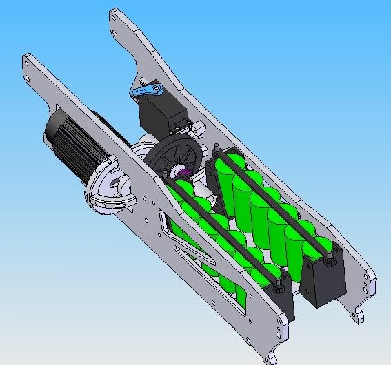

I'm working on a couple savvy conversion ideas and want to know how many guys out there would actually buy one if I ever got them to market. Here are what they will probably end up like.
Stage 1: A $15 to $20 drop-in plate that uses the stock tranny.
http://i14.photobucket.com/albums/a3...ge1blsavvy.jpg
Stage 2: A center slipper clutch mounted on two plates that mount to the center skid plate. Built for any TVPs that can use a center skid plate. Probably going to run $75 to $100.
http://i14.photobucket.com/albums/a3...ge2blsavvy.jpg
Stage 3: Basically the G2R of the Savage. Milled TVPs, center slipper mounted on plates that are mounted to the TVPs, a center skid, a battery mount, the works. I'm aiming for a price of about $200 to $250. That might be a bit low, but I think it's possible.
http://i14.photobucket.com/albums/a3...ionmounted.jpg
I'm still a while away from being able to sell these as none are finished and I don't have the SolidWorks commercial license. Please give me some feedback.
JB

jagboy 06.21.2006 01:01 AM
I've worked a bit on 3. Heres an update. I'm glad you guys like it.
http://i14.photobucket.com/albums/a3...onmounted3.jpg
JB

@ben, i spent alot of time making a savage conversion as well, mine will have a centerdiff. and you need to make the lower supports from one piece, those small things (i guess they are based on a FLM skid) won't hold up in crashes.
Serum 06.21.2006 01:36 AM
And the first motormount;
How is it supported? the two screws that are in the frame are not beefy enough to hold a motor.
jagboy 06.21.2006 02:07 AM
No doubt there is much testing that needs to be done, but I have made something like the first one using some chassis braces and a piece of alum-polyethylene-alum sandwich and it worked surprisingly well. Hopefully it will be able to take a beating, but if not it's back to the drawing board. I did make the holes M4 because M3 seemed extremely small.
http://i14.photobucket.com/albums/a3...y/DSC03064.jpg
http://i14.photobucket.com/albums/a3...y/DSC03066.jpg
Which lower supports are you referring to?
JB
Serum 06.21.2006 04:32 AM
The supports that hold the skid. (the 4, you need to make them like 2 long ones.
The mount on your pictures don't look too reliable to me, the thread of the M4 screws will eat it's wat thru the TVP's and cause play sooner or later. You need to make a brace to support the motor.
I will post a few pics of my current low cg motormount later.. And a few pics of my centerdiff converted savage
jagboy 06.21.2006 12:58 PM
Cool, I'd love to see the pics.
Personally, I didn't think it looked reliable either, but my 2 speed clutch failed. before that mount did. I didn't have it locked in second, which is what I'll do once I get my savvy running again. Don't worry, if it's not reliable, I wont make it. I am a basher and know how frustrating it is to buy parts and have them fail. I will test the heck out of all of these parts. If it works well, I'll pursue it. If not, I'll drop the design.
Don't forget these are basically concepts as of now. I'm very opent to all critiques and comments.
JB

jagboy 06.21.2006 01:29 PM
Most can probably be milled. There may be some places where fillet meets chamfer that cant be milled, but who knows.
What about the price range guys? Would you buy 3 if it was around $250?
JB
Sneeck 06.21.2006 01:49 PM
Only if it where a full chassis, with center slipper or diff option, spurgear, pinion, tpv's, skid plate, brace's, hardware everything ready to go. Like a drop-in chassis upgrade.

@Sneek: That's what I'm aiming for. I'm also going to try to use as many stock savvy parts as I can. Hopefully it will be able to use savage spurs.
@cemetery gates: That's the target market; people who want the power of BL but don't want to spend a ton on a conversion. The problem is that if you dont lock the tranny into second, you don't get reverse and need to use mechanical brakes. That's fine for those who are dropping it into a stock savvy because they would already have mech brakes, but then you also have to worry about the clutch holding up. Locking it in second is probably the best idea.
JB

jagboy 06.21.2006 03:21 PM
One of my main goals through all this is to keep the weight centralized. The batteries on these conversions sit between the chassis plates. What diff is that that you are using?
JB
Serum 06.21.2006 03:23 PM
Owh, bytheway;
The cool thing about the low cg motorconversion is that it's possible to adjust the gearmesh, without too much effort.
My current design is holding M4 nuts, so if they wear out, you can just replace them.
And the motor is fixed to the moving plate, So you don't need to worrie about stripping them either when adjusting the gearmesh.
Serum 06.21.2006 03:27 PM
But the way you are doing it, makes the motor sit skyhigh.. my goal is to make a low cg. I dislike wheelies. That's a pure lost of acceleration and power. And with the right amount of power, you would still be able to pull wheelies. that's an ofna diff, soon to be replaced, but it's okay for testing. The centerdiff isn't as stressed as the front and rear diff.
I had another plan though, this would more centralize the batteries and still keep the motor in the center, it just uses a savage front/end, and a whole different frame.
I dislike the batteries laying so wide, with the flm add-on, but like i said, it's just a brainfart, and i am sure people would be interested in such a battery holder. It's nicer than the common U profiles imo.

jagboy 06.21.2006 03:38 PM
I'm not quite sure who I am going to get to machine all mine. I think there is a CNC shop in my area. My summer job will hopefully be able to pay for some machining. I hope to have prototypes of at least stages 1 and 3 by the end of the summer.
JB
Serum: No, I hadn't. It looks pretty nice. I found that it needed to be pretty much vertically aligned w/ the spur to allow the batts to sit on the stock motor mount plate, so thats how I designed it.

jagboy 06.28.2006 07:42 PM
Not done yet, but an update. I need to measure a couple things and probably move the motor further back, but this is the general design. I still need to take off a bunch of material from the TVPs and find somewhere to mount more cells. Or maybe a whole different battery mounting system. Oh well. Help me out with you C&C. Thanks.
http://i14.photobucket.com/albums/a3...rsionfull1.jpg
JB
