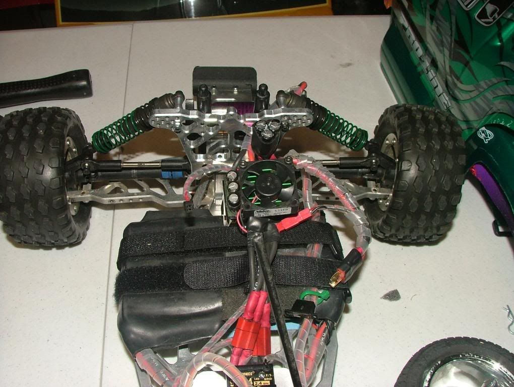

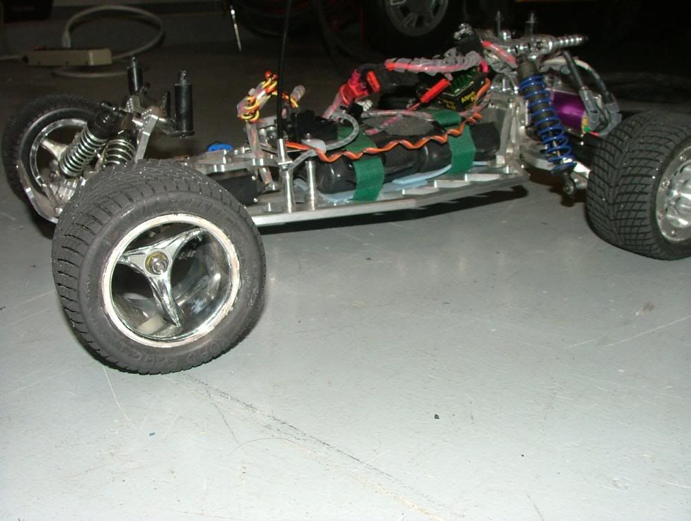

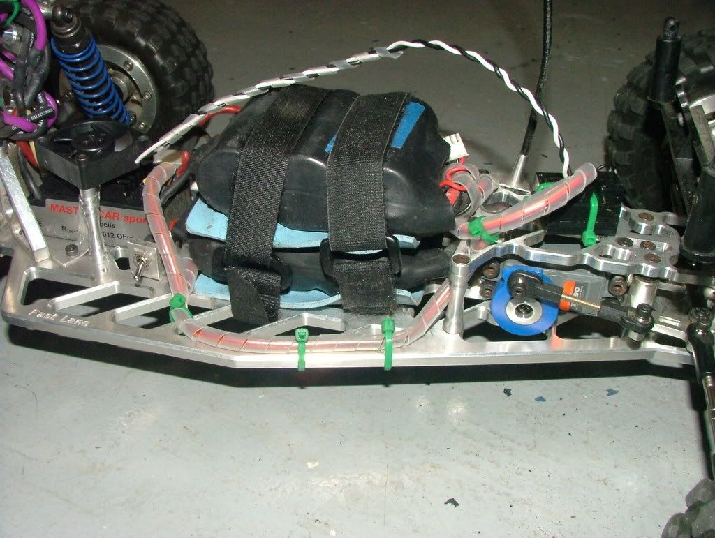

snellemin 07.02.2008 04:24 PM
There are several ways of fitting them in. I run 6 A123 cells on mine at times. I did it both with the regular and extended FLM chassis.
http://i189.photobucket.com/albums/z...r/DSCF2869.jpg
http://i189.photobucket.com/albums/z...r/DSCF2605.jpg
http://i189.photobucket.com/albums/z...r/DSCF2287.jpg

tino_ale 07.02.2008 04:31 PM
Wow that's really good info, thanks!!
1/ I guess there is no way to fit them on the stock chassis. Do you advise me to go for the regular or extended FLM chassis? I intend to keep the rest of the car stock for now.
2/ Of all 3 pics you have provided, which arrangement do you think is the best?
3/ Is it possible to keep the stock ESC support or do you have to get creative on how to attach it to the chassis?
Sorry for the many ???? but I'm delighted to know the rustler can be run on A123 :party:
snellemin 07.02.2008 04:41 PM
I managed to fit 4s1p A123 in the stock chassis before, but it was just a mess.
Both FLM chassis are great, but it's easier to fit 3s2p A123 on the extended chassis. Now how you installed them is up to you. I just installed them towards the front right now to eliminate wheelies.
