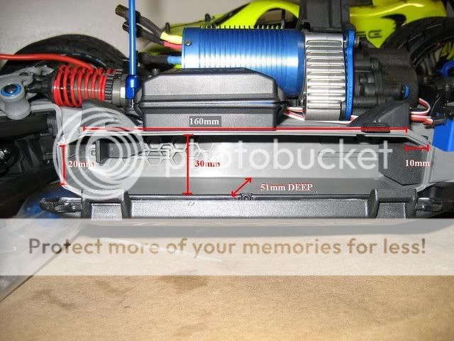

Any ideas if the polyquest 6000 3s 25c packs will fit in the erevo battery trays? I remember a great pic with some measurements in it, Neil might have posted it, but I cannot find it right now...

david lamontagn 10.20.2008 10:44 PM
James, my TP 5000, 3s fit just tight and it's 160mm x 48mm x 25mm, so i'am not confident that your 6000 will fit:no:
Chachi_RC 10.20.2008 10:55 PM
Here you go. I think Hoovhartid originally posted it, and Neil added it to his FAQs on the TRX forum.
http://i381.photobucket.com/albums/o...atterysize.jpg

Tempted 10.21.2008 02:17 PM
The Zippy H 5000mAh 3s packs will fit. They are a tight squeeze, but the door shuts. I put mine in an E-Revo about a month ago. The dimensions are said to be 160x51x24 on the website.
