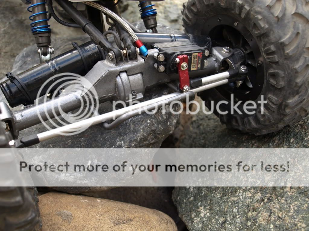

Hand made Chassis, MIG welded 1/4 .035 wallstainless steel tubing
Custom angled solid stainless steel axles
Axial Transmission
Revo drive shafts
Losi after shock Center Diffs, with custom made lockers
Hyper 8 drive axles
Madforce hubs
4 Wheel steer
2 wd and 4wd and rear dig with custom mechanical DIG setup
4 link suspension front and rear
Delrin Acetal Links
HDPE bottom Skid

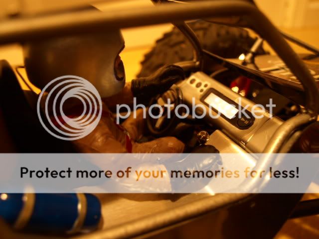

Stereo
6 watt Altec Lansing speakers x4
Sony MP3 player in dash , 3 tone LCD lists songs
Plays real V8 engine sound

HItec 5995 Front and rear servos
Mamba Max ESC
Castle BEC
DIG servo

Everything is a tight fit under there, Mamba max, Axial Tranny, DIG servo, stereo amp circuit board and lots of wires :oh:

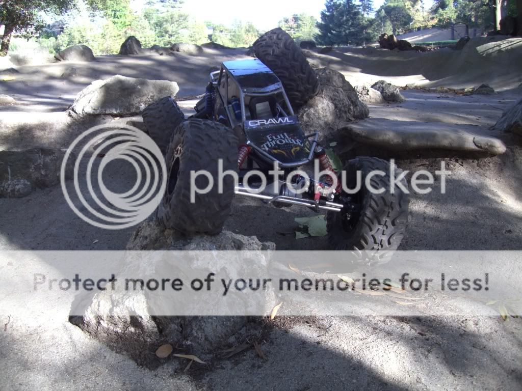

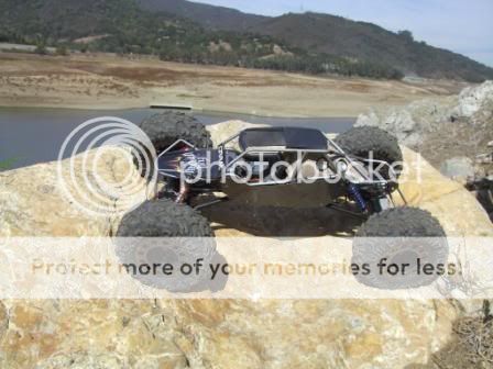

Went crawling at the local resovoir while it was low, crawling with some guys with the little 2.2's
found some pics
[IMG]http://i588.photobucket.com/albums/s...G1390JPGwb.jpg[/IMG]
[IMG]http://i588.photobucket.com/albums/s...October001.jpg[/IMG]

[IMG]http://i588.photobucket.com/albums/s...October006.jpg[/IMG]
