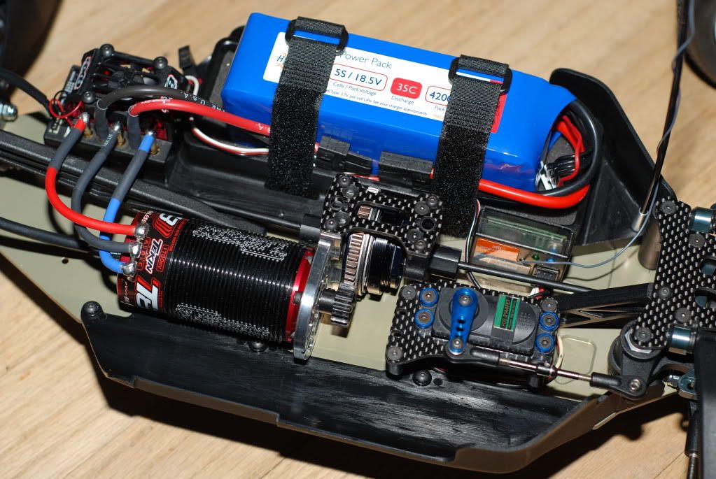

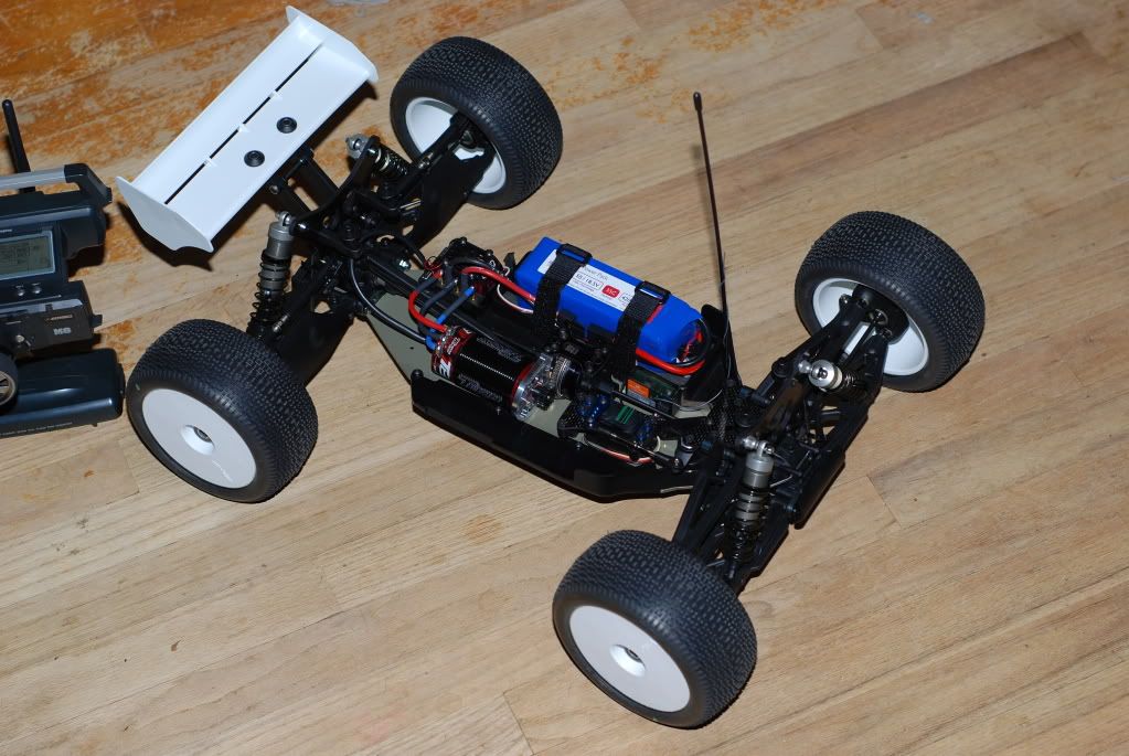

itbvolks 04.11.2010 11:25 PM
Update!
Well, finally got some the truck together. Took me a few days longer as I was waiting on a few pieces.
Overall, the build was smooth. Mugen has done a great job as has Mike with his clean integration of a brushless setup. No real surprises at all. I still need to revisit my ESC wrie routing and get my antenna sorted but figured I'd grab some snaps.
Overdue pics :mdr:
http://i23.photobucket.com/albums/b3...9/DSC_6649.jpg
http://i23.photobucket.com/albums/b3...9/DSC_6650.jpg
http://i23.photobucket.com/albums/b3...9/DSC_6652.jpg
Hyperion charger should be here Wednesday along with a few other goodies. Got my batts all wired with TRX connectors (prefer over all my deans stuff). ESC is cal'd and truck has moved under it's own power. :party:
Nice to see my M8 and KO digital still serving the cause. Also got my Spektrum module in and setup. Should work well.
Few things this week. Need to mod my 400watt Corsair Power Supply for charger duty and get my proline bulldog painted! Can't wait to get this out this week for some shake down runs!
Curious what you guys are doing for general break-in on a new mill and batts? Do I need to be overly cautious initially?

itbvolks 04.12.2010 01:24 PM
I gotta say, the metal to metal gearing is a little loud. I seem to have a touch of run out with my slipperential so my mesh is a little lose right now.
Should work though! We'll see....
