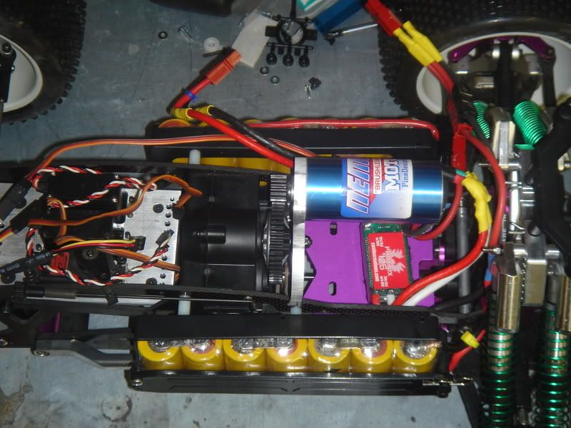

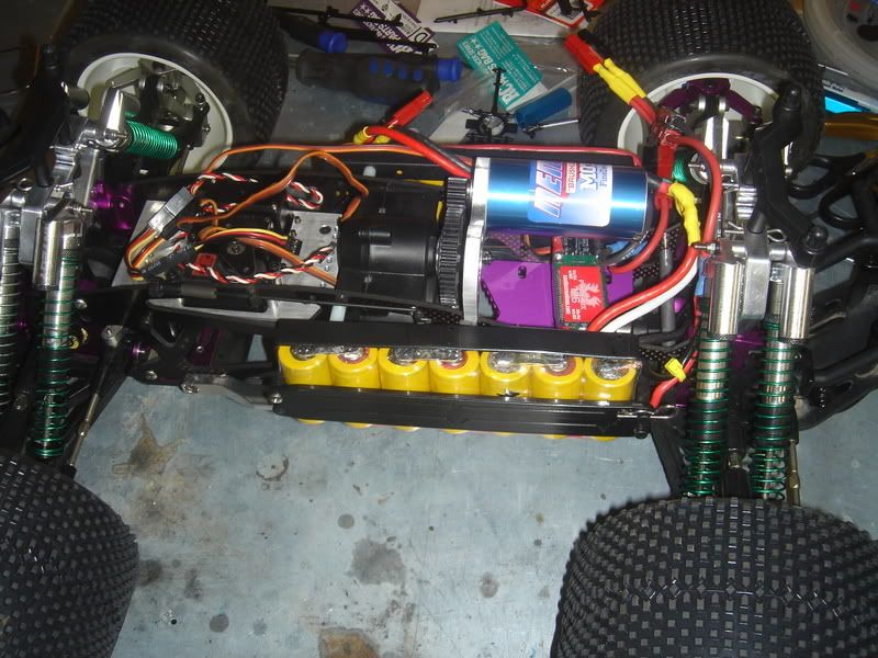

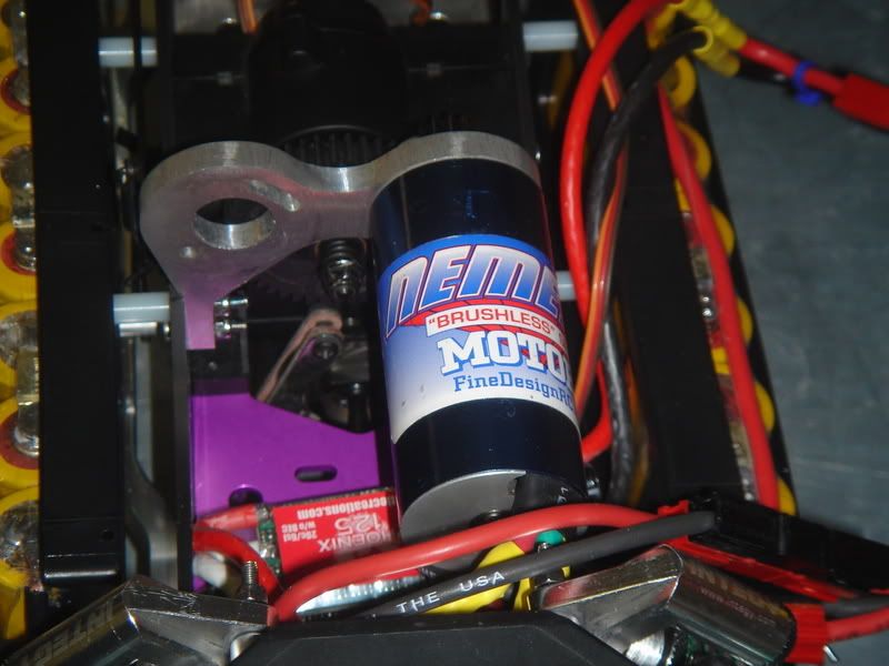

rckcrwlr 04.14.2007 08:12 AM
Originally Posted by 2FastSS4U
Thanks, I've never worked with raw pieces of metal so I dont know how far fabricating my own pieces would get me.
2Fast,
I was in the same situation. I opted for the KershawDesign format. One thing I can say is Dan over there is great to work with. The Battery trays are not that bad. I will be using them only for a little while until I go lipo and then it will not be an issue. 14 SC is a lot of weight. I had him lower the mount somewhat so that it sits a little lower.
Talk to him. He is a great guy that loves the hobby and will work with you on what you envision. I think it is only $10 more for him to design something specific.
Good Luck,
John
http://i139.photobucket.com/albums/q...Kershaw003.jpg
http://i139.photobucket.com/albums/q...Kershaw005.jpg
http://i139.photobucket.com/albums/q...Kershaw001.jpg
