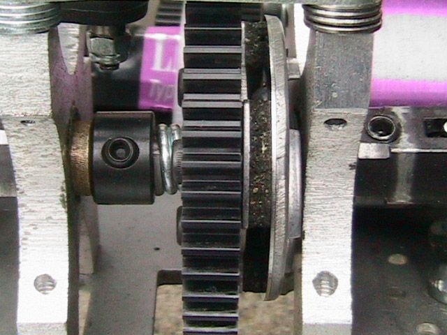

As Dafni said, making a motor mount is not difficult. That is, as long as you have the tools. I have made at least 10 different motor mounts (for different vehicles), so the diff would be much easier to work with. Or, I could do it my style - a center shaft with an inline Revo slipper clutch with a Monster GT mod1 spur mounted onto it (this is what I did to my 1/8 BL/Lipo buggy).
Dafni 07.06.2005 01:47 AM
MetalMan, do you have a close-up of this inline Revo slipper setup?
MetalMan 07.06.2005 10:16 AM
Yep!
http://img.photobucket.com/albums/v1...r/IMG_0749.jpg
Dafni 07.06.2005 10:56 AM
Thanks, looks good. Is this the stock spur?
Would you mind to share the gearing numbers? Or is there a thread about this rig somewhere?
Would like to know more about this buggy.

MetalMan 07.06.2005 05:33 PM
Diffs are usually good, as they can improved braking into corners.
Dafni - the spur gear is a Kimbrough Monster GT 52t mod1 gear. I can also get 46 and 49t gears. Pinion is a 13t mod1. Diff ratio is 13/43. Motor is a Feigao 8L.
If you want, I can start a new thread with all the specs and pictures.
