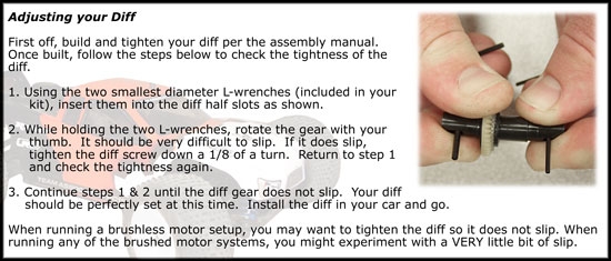

Here is the best way to adjust the ball diffs TBH the plastic diff's wont stay tite I would recomend the mip diff's and carbide balls for longer lasting diff's in the rc18. :)
