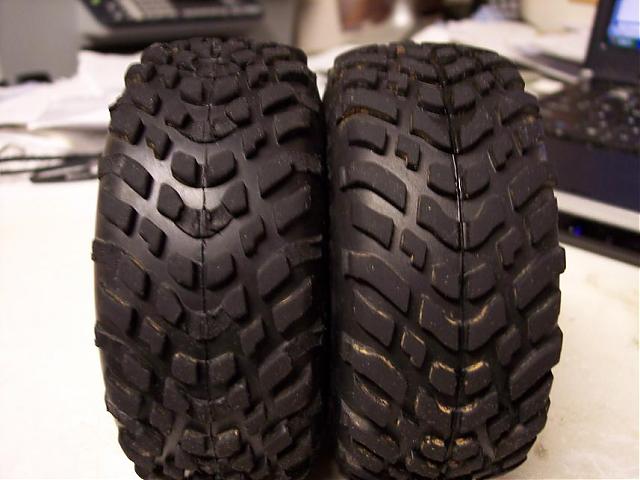

i think this helped alot the tire just feel ALOT softer i snipped half the big outter lugs off and the inside halfs of the big center lugs. the tire on the left is the grooved on obviously with the stock on the right. you can see now their are no big continous lugs to slide all over with, just lots of small lugs with room to get a bite....should work good, i never had much luck with other tires when having big gaps between the tread so thats why i left half of each lug i sniped and made it into smaller ones.
