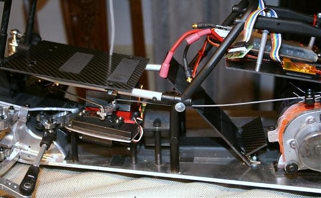

These are the compartments for the Lipos. I cut them out of 3mm cfk-plates. They allow for four different settings in terms of weight and weight allocation.
1. 1P in front, 2. 1P lower and more rear, 3. 2P in front, 4. 2P front and rear.
