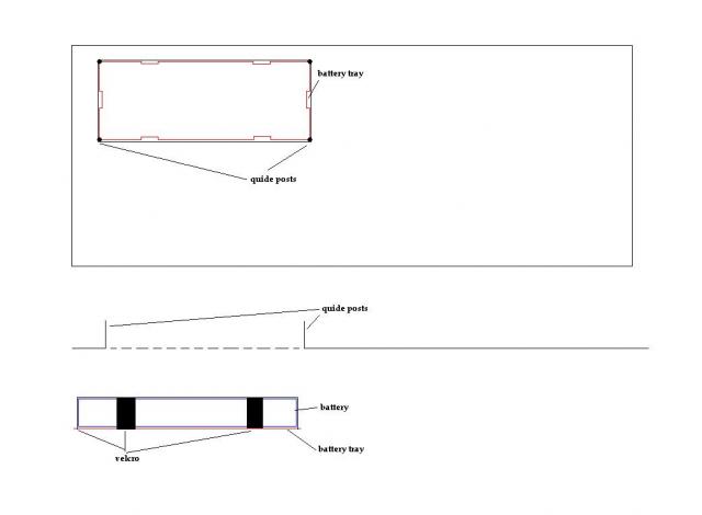

I think that fastest way would be trought bottom.
Cut piece out of bottom plate, size of battery, then make some guide posts for it to make it move smoothly up and down, then something for quick lock it from bottom.
Then you could have two battery trays, one for each.
