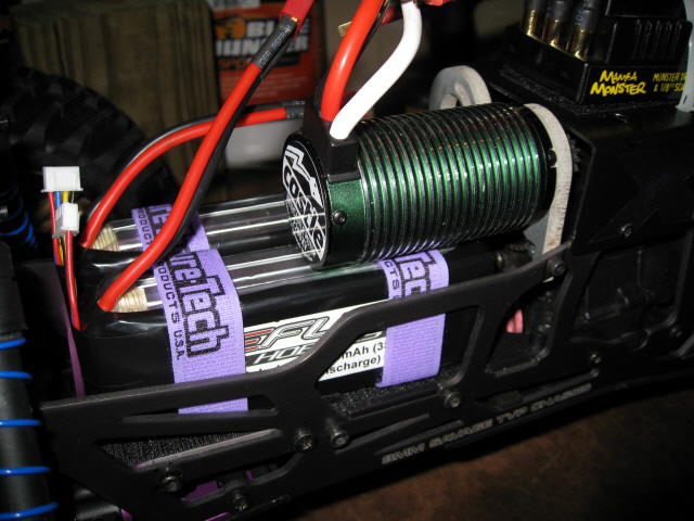

Hi, I just found this post and thought I'd share my project. I'm running on 6s power with a locked 2 speed tranny. I locked it by using my mig welder and tacked a weld on the arm to hold it in place. I'll take a pic next time its apart. This truck was a Savage SS on gas last year, but I caught the electric bug and made an BL XL conversion. I'm still running the manual fiber brakes and also steering from the hump pack. I thought it might save me some power, and I've read that it can keep the motor as much as 30 degrees cooler. So far I have'nt had any tranny problems. I'm running a 47 spur with a 15 pinion and can still do standing backflips. I wont claim it can do 60 with this pinion, but It is a lot faster than my Savage SS on gas so I'd guess Its around 45-50 mph. Id love to run the direct drive, but I dont think my packs will fit with that set up. Thats partly why I changed to an XL chassis. (to hold packs between TVP's)
