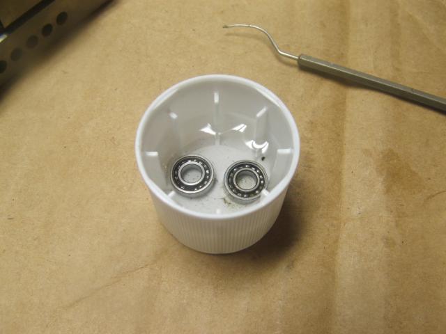

I used the cap off of the B-12 and filled it so that it would cover the bearings. I left them for a few minutes and shook it a little bit. While I was waiting I cleaned the shields and retaining rings, with a shop towel.
Take the bearings out and spray them with the cleaner you are using by spraying through one side then the other. Then I dump out the cap and place them back into the cap refilled with clean solvent. Remove them and spin them by hand a few revolutions and place them back into the solvent.
