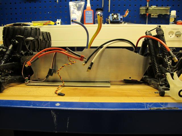

I guess this build ended up in a quest for a god damn low CoG... did we get there?
Well, for a Savage Id say we did :)
Motor, ESC, Servo, 2,4GHz RX placement:
The battery compartment in spe:
The cut outs in the TVPs will be 155mm x 32mm... thats enough to fit most LiPo's out there... horizontal of course
Hmm lol the frontal part is sitting upside down... the dogbone cut out is supposed to open the part in the top... good morning! ;)
Judging from rough mock ups the balance of the truck is pretty good... slightly tilted forward... but only slightly.
